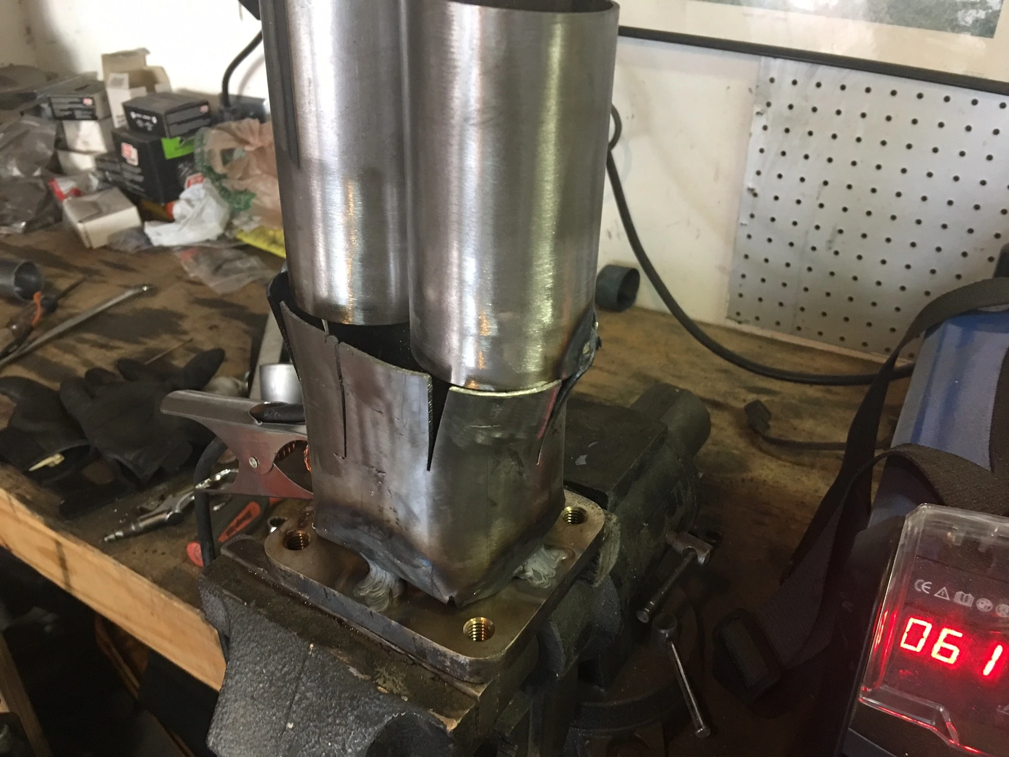

Cut the pipe down the middle and use sheet metal to form the oval.?
Yeah, something like that. Wait. Do you mean is that what I did, or what I'm going to do?Cut the pipe down the middle and use sheet metal to form the oval.?

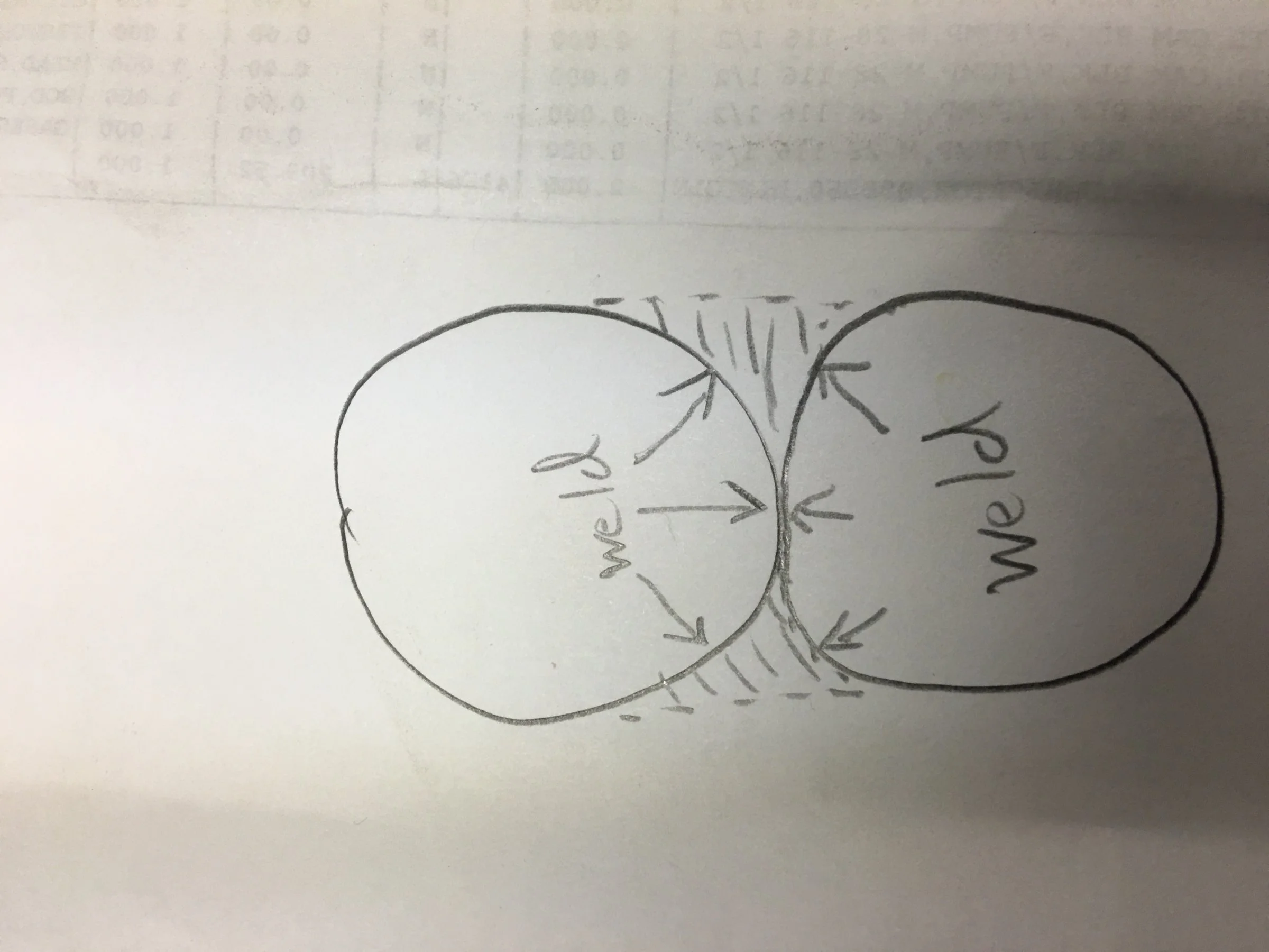

Yup, that's the plan for tonight. Version 2 is gonna be a master piece, LOL.Before you tack those pieces in place on the collector, weld the end of the pipes together to seal them, and cut some little triangles to fill in the holes between the pipes and seal weld all that to fill the gaps..

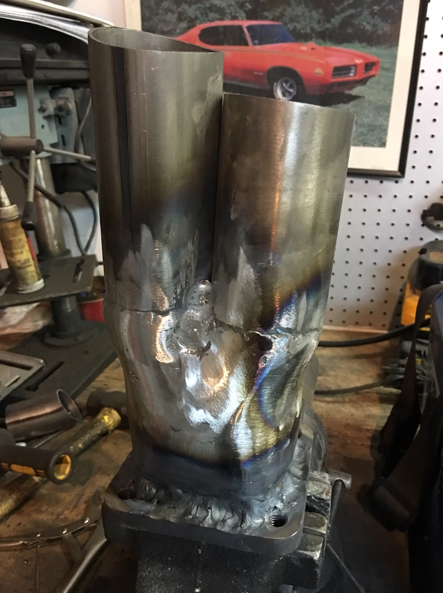

Bingo. I'm embarrassed to admit that I didn't think to do that last night after making a point to do it on my failed header project.
...Aaaaaaaaand there's another week down the drain. Leaving tomorrow for another weekend trip. Next weekend is out, too.
I think if I could have a solid 2 day weekend to go balls out on this thing, I could get it really close to running.
