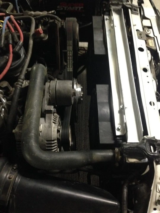

Here's the money shot. @84Ttop - just a couple little spots with the die grinder and we were in business. I used a couple of 30a relays and wired them up with a switched ground from a diagram I found from @jrichker. Drove to work this morning with 1 fan and the A/C blowing and no issue. There was also no traffic, so the test will be going home today.
