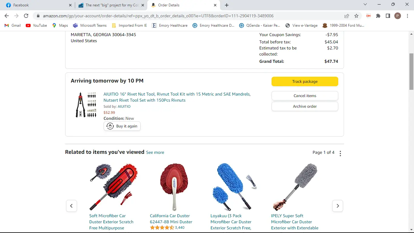

Speaking of something else - I went ahead and ordered a rivnut tool today now too. Not that I need it right now for anything, but it just seems to be a good investment for something later.
Amazon product ASIN B07T8YZY23
I don't know if it's still available or if I just happened to look at it all at the right time, but Amazon had a 15% off coupon for this one, so it was <$50 with Prime shipping.

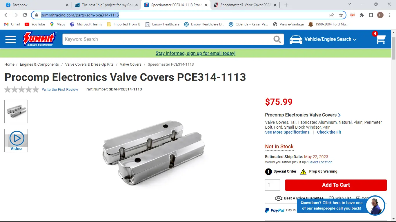

The dangers of having a job that you find yourself with a good amount of free time is that you have all sorts of opportunity to shop online.
So I'm on Summit's website and looking at changing things up under the hood. I'm looking at these valve covers from Speedmaster:
https://www.summitracing.com/parts/sdm-pce314-1113
They're listed at $75.99 on their site, but aren't available until May 22.

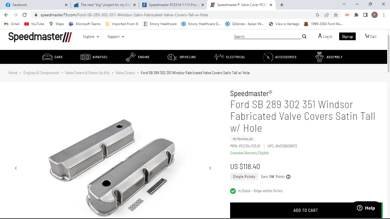

So I shop around a little more and find them on Speedmaster's site (speedmaster79.com). They list them as in stock, but they want $118.40?!?! WTF?!?!
I have a set of Edelbrock valve covers on it now, but some of the simulated cap screw heads have come out and have been lost. The only real work around that I can think of is to get some new screws, cut the heads off, then epoxy them in place. Or, if there's room, I could drill holes and attach them with backing nuts - but I think I just want to do away with them altogether. Unfortunately it'll cost me. But I'm in no hurry, they can wait....

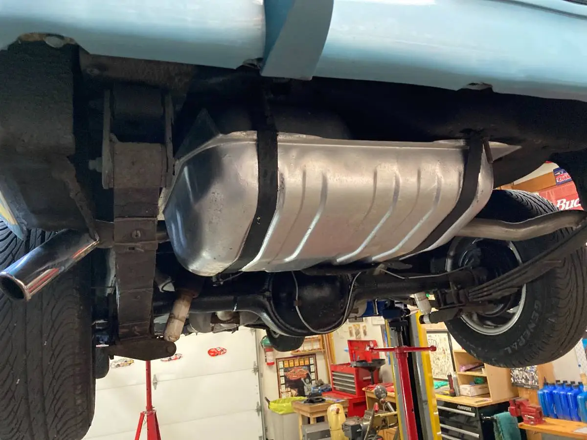

Most people route dual exhaust so 2 pipes exit where the muffler is usually mounted. This one is more like I'm thinking, except I'd like to run polished stainless pipes back from where they terminated the pipe. I couldn't find any other II with anything like it....

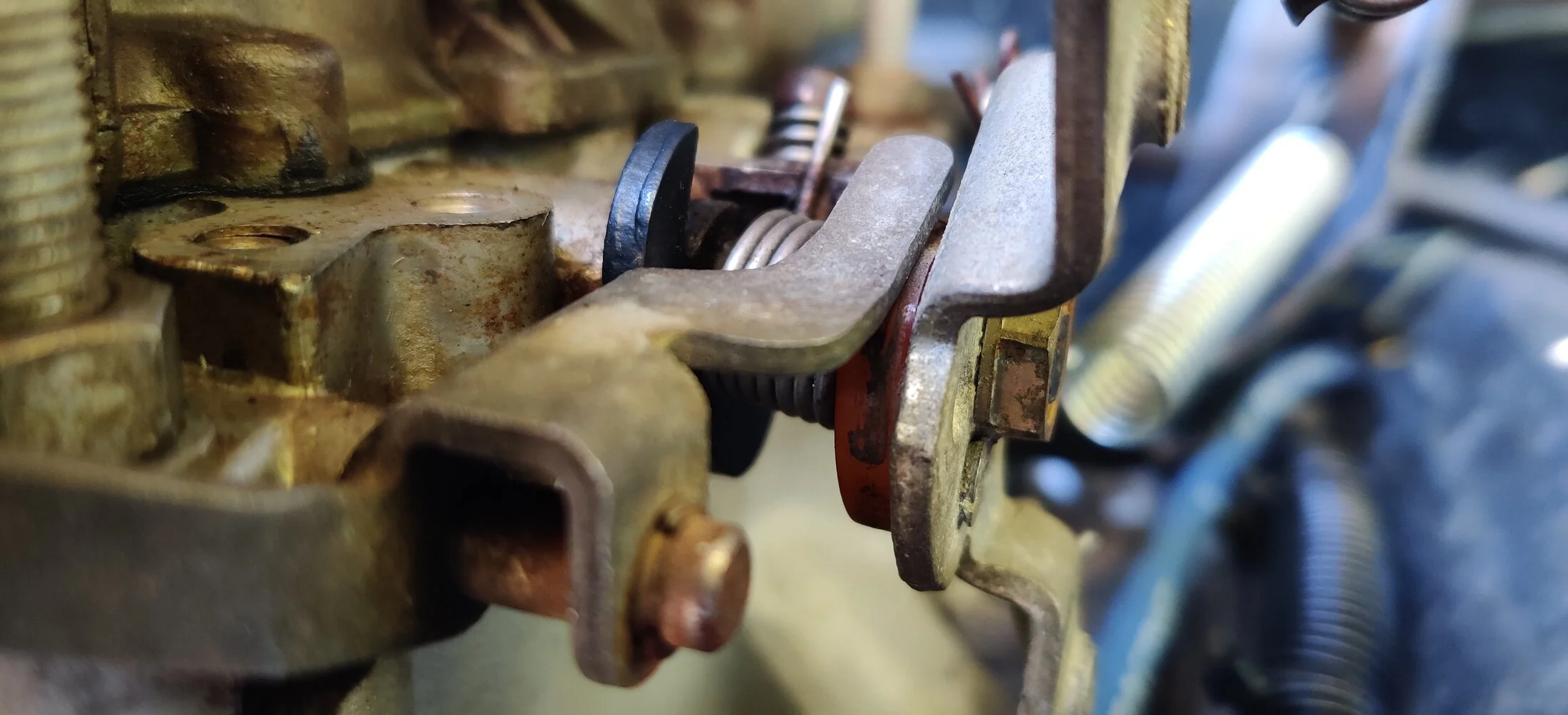

What carb do you have? A 4777 650 double pumper? The stock 30cc pump should deliver more than enough. What accelerator pump cam is installed on primary and secondary side? To identify the pump cam, the color is important and in which hole (nr1 or nr2) is the screw?

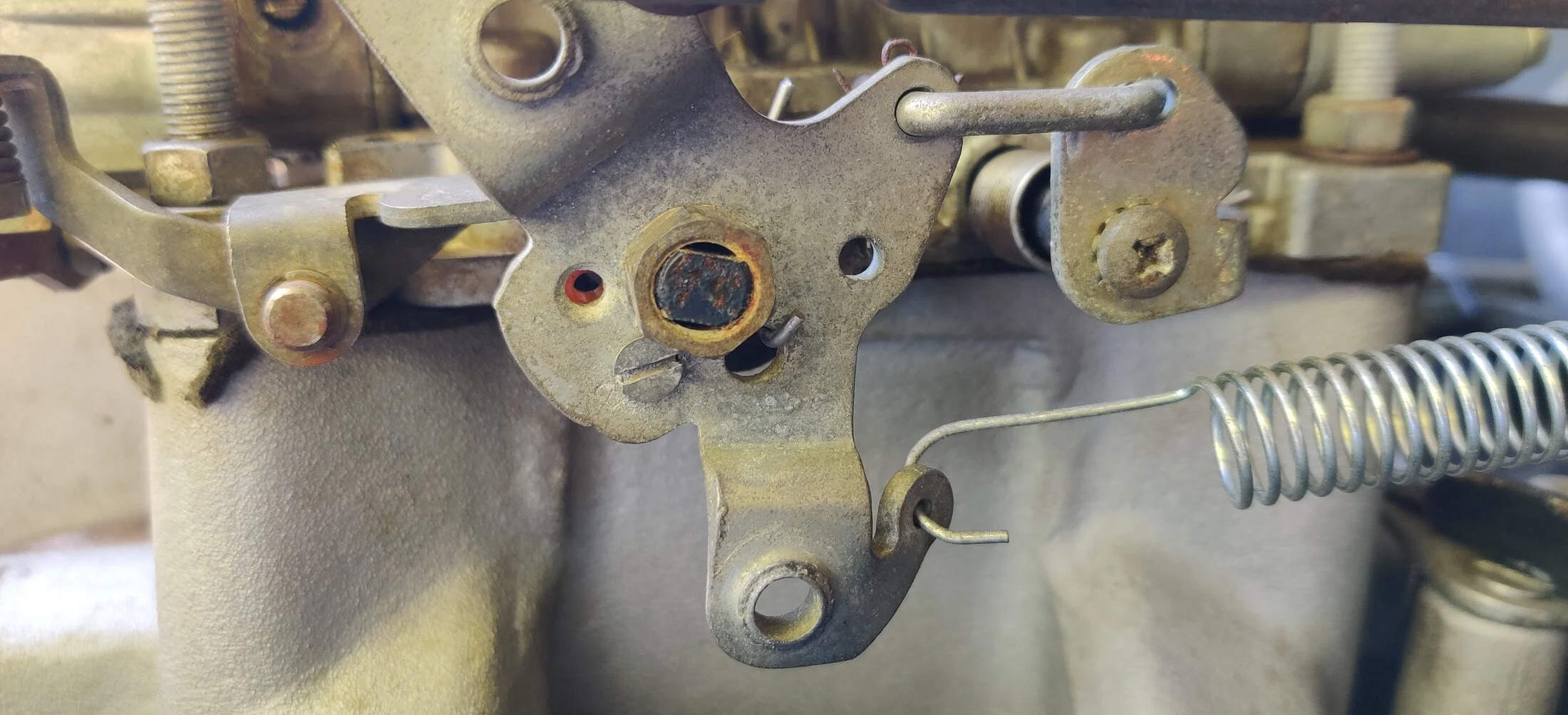

It is a 650 double pumper. And here are a couple pics showing the primary pump cam. It looks to be orange to me.
And, because I was out there and thought of it, here's the new hood struts in action! I really wish I would've done this years ago!
The cough IS off idle. Was thinking, too, that I'll probably go back through and re-confirm everything I had done previously, starting with timing and engine vacuum. The idle screws are now at about 1-1/2 turns again after messing with them before I finally figured out the other issues (float level and wiring). So I'll most likely be tackling the carb tune again, although I think that it might be a lot closer now than it was before.

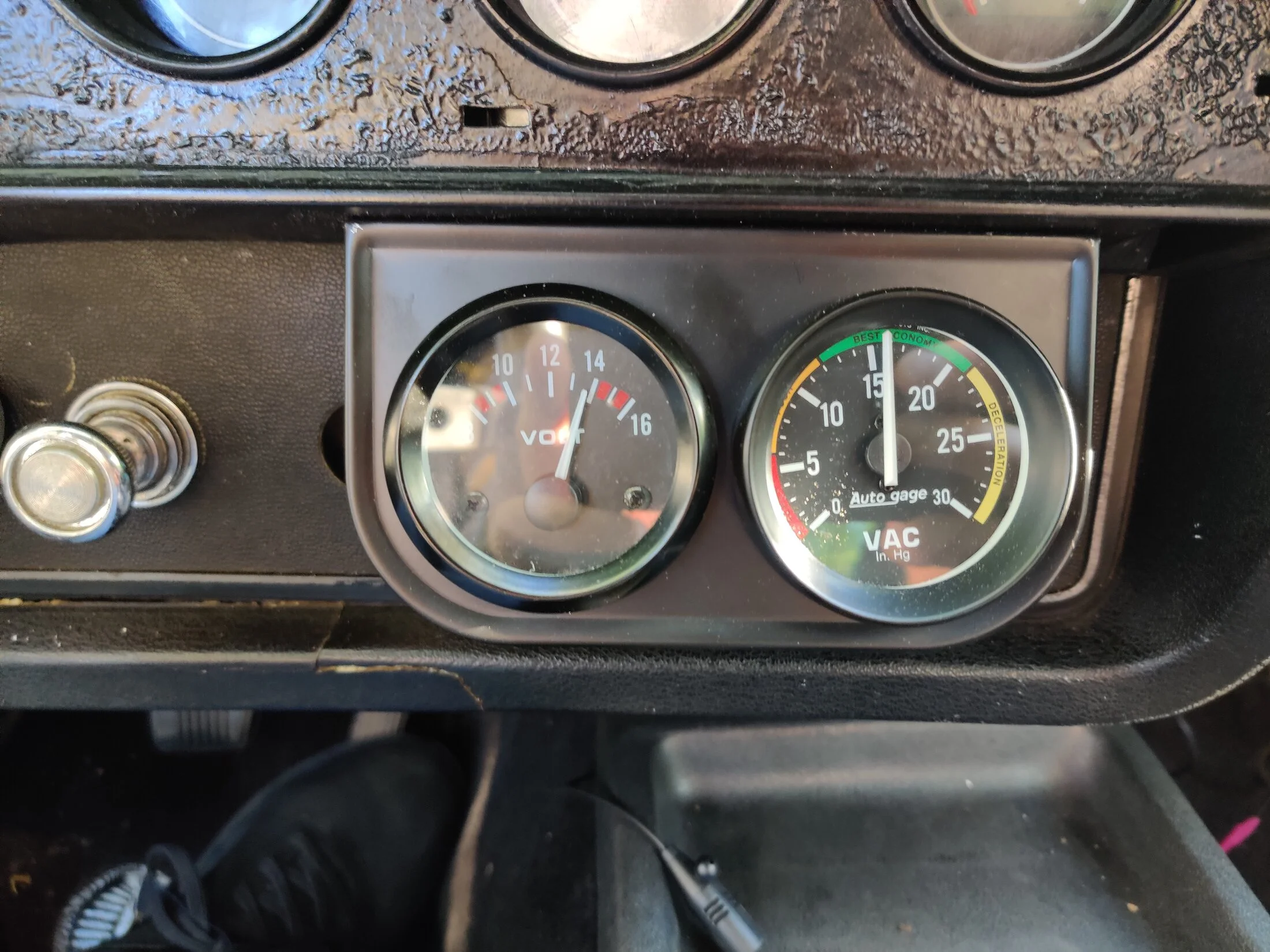

Just got done rechecking everything. Started out with only about 5 inches of vacuum, so I fiddled with the idle mixture screws a little and got up to around 7. Then I thought "wait a minute, I had more than that before!" So I grabbed the timing light and found that it was retarded again, but couldn't make out the marks. So I grabbed some paint and a small brush and marked the damper at 10-12-14-16 BTC so I had some kind of visual. I loosened the distributor and turned until I was around 12-14 BTC and my idle and vacuum shot up accordingly. I then adjusted the idle again, then checked timing again and readjusted. Now my idle vacuum is back around 15 inches, so I adjusted the idle mixture screws again and that's where it sits. It didn't seem to have the cough when I'd blip the throttle anymore, now I'll have to take it for a test drive again and see how everything looks.

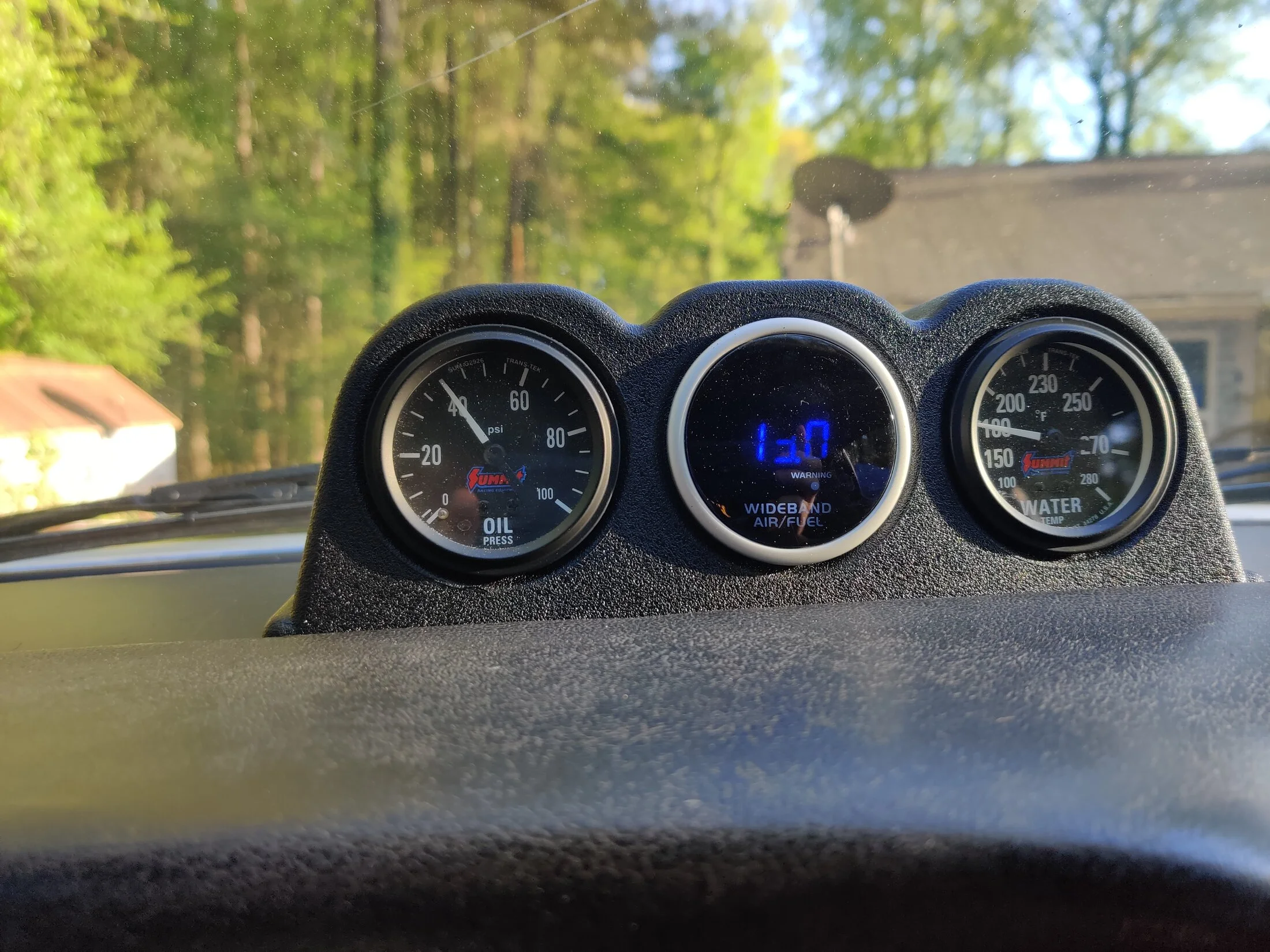

And just got home from an eventful ride. Ran out of gas! The gauge read 1/2 tank.... I guess I must've bumped it when I painted the needles.
Anyhow, it's running a lot better! No more coughing, and the A/F gauge is reading between 11 and 14 most all of the time. The vacuum gauge I installed also read around 15 inches at idle too. These pics were after I got it home thanks to a buddy of mine who brought me some gas....
(The A/F gauge was reading 13.0 in the pic. )

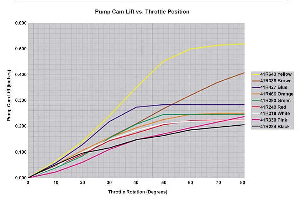

And here is a chart of the different pump cams:
If yours is the orange one (you only can be sure by unmount and read the numbers on it), you could swicht to yellow or something like that.
My double pumper runs great with the blue one primary and pink on secondary side.
But I think your problem was ignition and transfer slots...
Good to hear that it runs again without that cough.

Thanks for the chart! I've never seen it. I do remember that 20+ years ago, when I put this carb together from a bucket of parts, I just eyeballed the pump cam and went with the one that seemed to be the most moderate of the bunch. I don't recall now what I had at that time, but I don't have many of them (if any...) anymore. But it always seemed to run pretty well when I got it running at that time. That was, of course, before I swapped intake manifolds. It may have been running extremely rich back then, too, but I didn't REALLY notice it until I swapped for the new imitation Performer RPM which is what prompted me to go down this path. I can say that I'm happy that I did!
