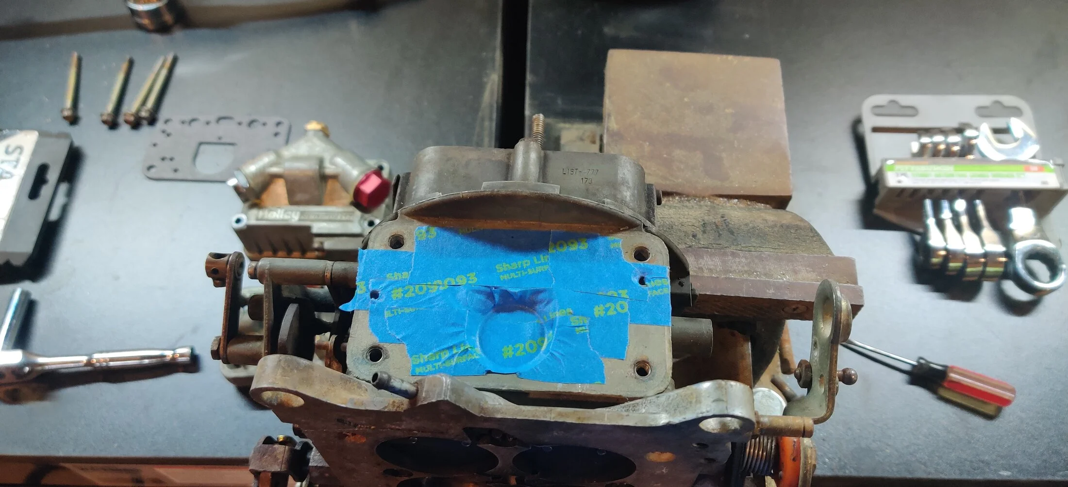

I got the carb ready to perform surgery tomorrow
If your carburetor is at that stage. Check the transfer slots on primary and secondary side. If possible make and post pictures, would be interesting to so how they look like after your last tuning session!
And also try to make you secondary idle RPM screw free again with some WD40...

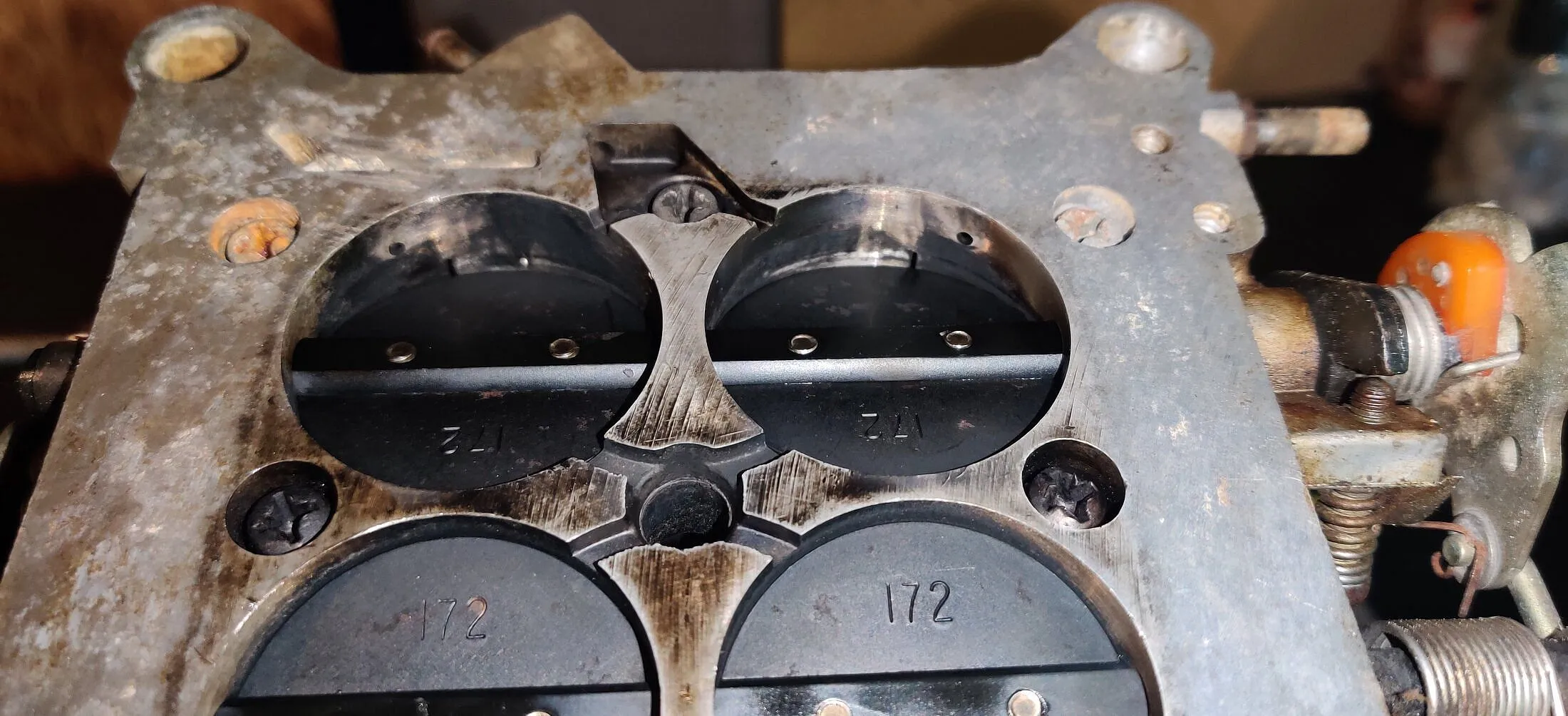

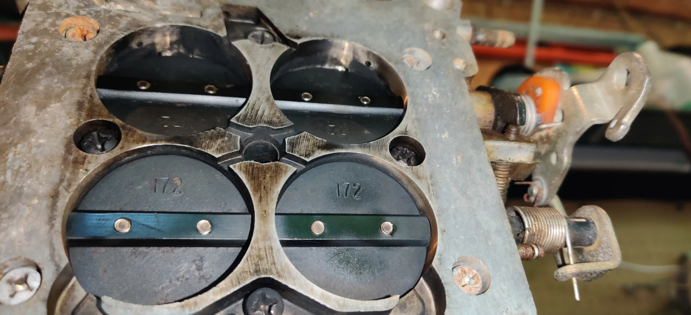

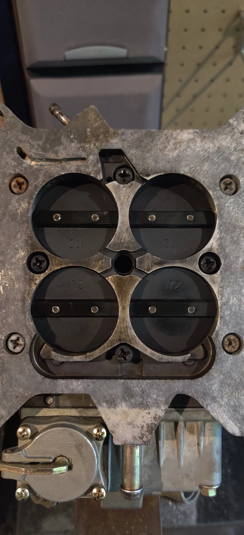

Here you go. :)
The primary idle slots.

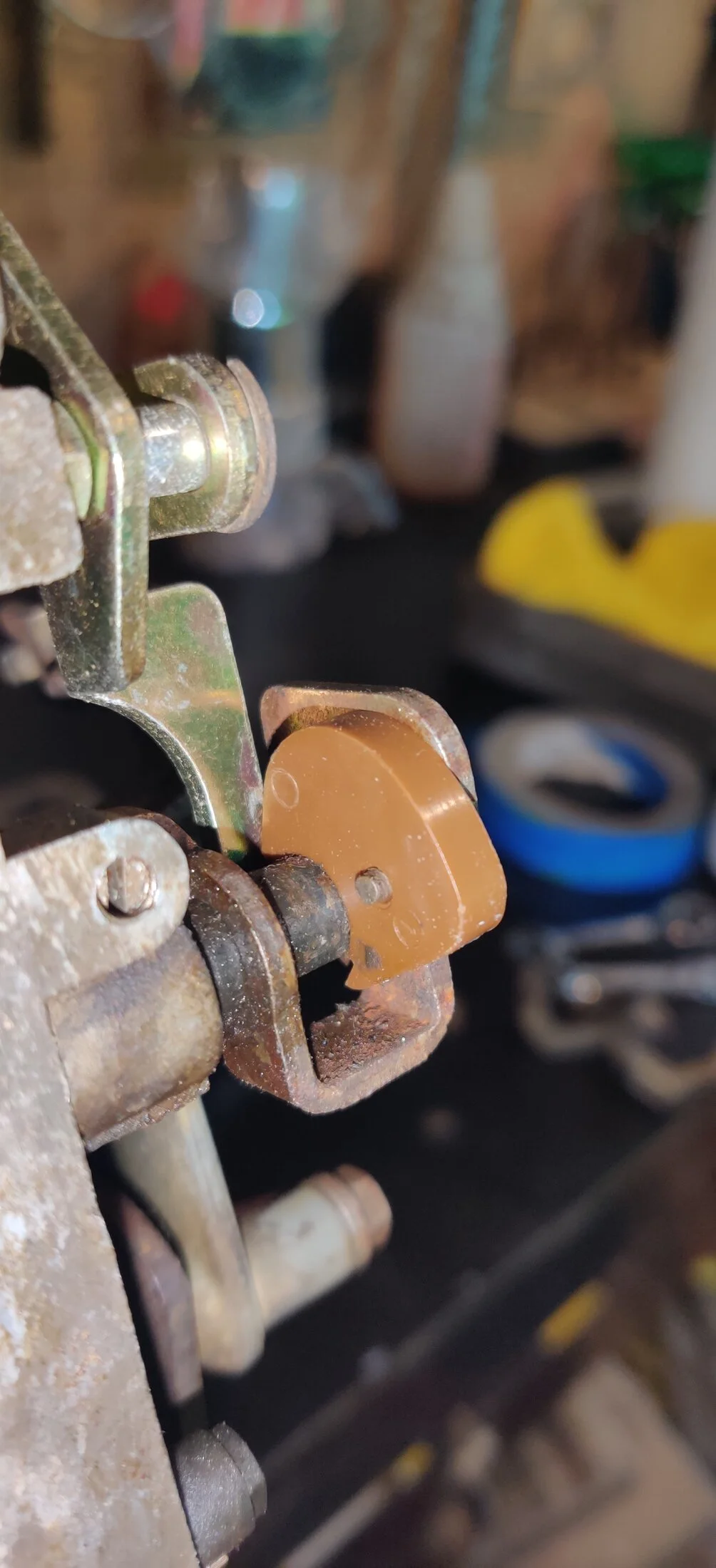

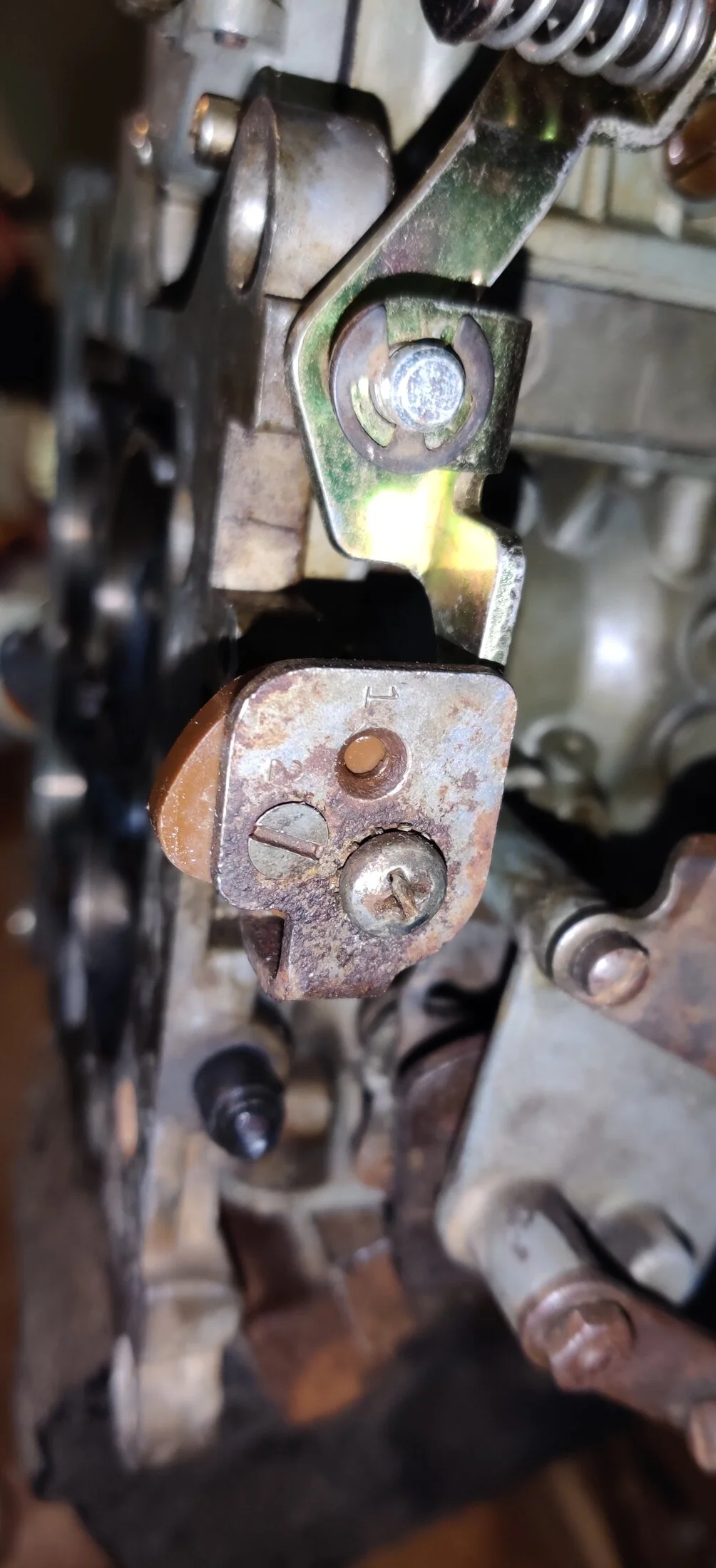

And the aftermarket secondary pump cam. If memory serves, I had to install it this way otherwise it was too tight.
Thanks for the suggestion about the secondary screw, I'll spray it down and see if it'll loosen at all. In all outward appearance it looks like it's just about right. The secondary throttle plates are completely closed when the shaft is at rest, so I don't think it'll need any adjustments to speak of. :shrug:
Reactions: extra_stout
You could close the primary side a little to get the transfer slot more square, and open therefore the secondary side a little.
Than you should get more control with the idle mixture screw...
e.g.: If you need a little more idle RPM in the summer because of high temperature, you will not have excessive exposure of the transfer slot.
I just saw that the throttle blades are not closed fully in this picture. At least it looks like the idle RPM screw is not in contact with the stop.
So please look for that, before you make any adjustments...
Perhaps it's not necessary to adjust something.
Yeah, I noticed that too. I think it's because it was sitting on the vise.
