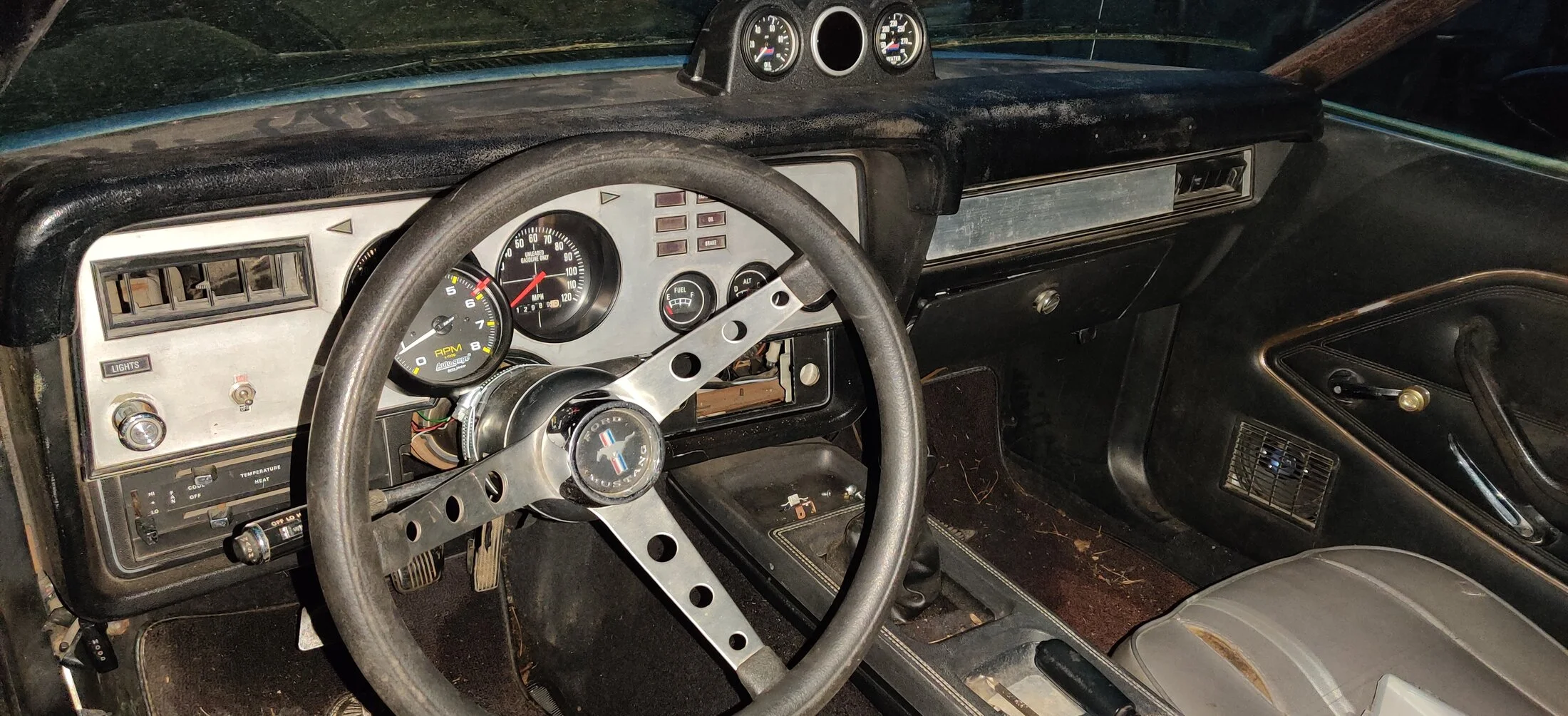

First, the good news. The dash is reassembled with the replacement dash pad. No more cracked dash! :)

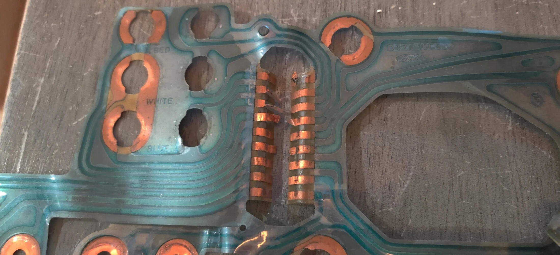

Now, the bad - my dash lights aren't working now. So I have to take the gauge pod back out (maybe tomorrow).... :(
I wonder what it would take to put an 85/86 or 87+ dash in there. Have you measured them?

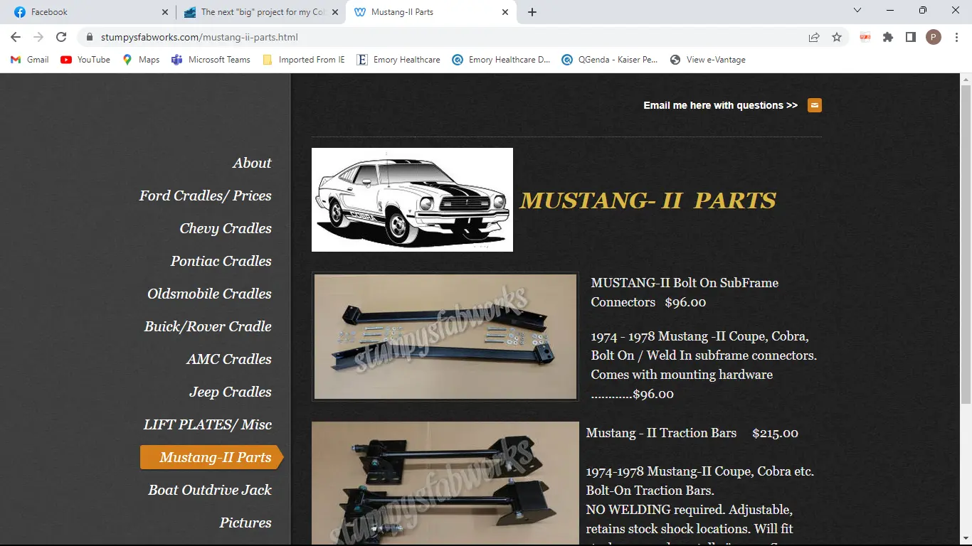

Just placed the order for new dash inserts from Classic Auto Reproductions, and I sent an email to Stumpy's fabrication for new subframe connectors. I'm going to ditch my home made connectors as they're running super close to my exhaust pipes. The exhaust knocks into the connectors at idle and is super annoying. And I think Stumpy's (or any straight connector for that matter....) will work better. But if his price still stands, I can't see trying to fab another set myself. They're still advertised for $96 on his website....

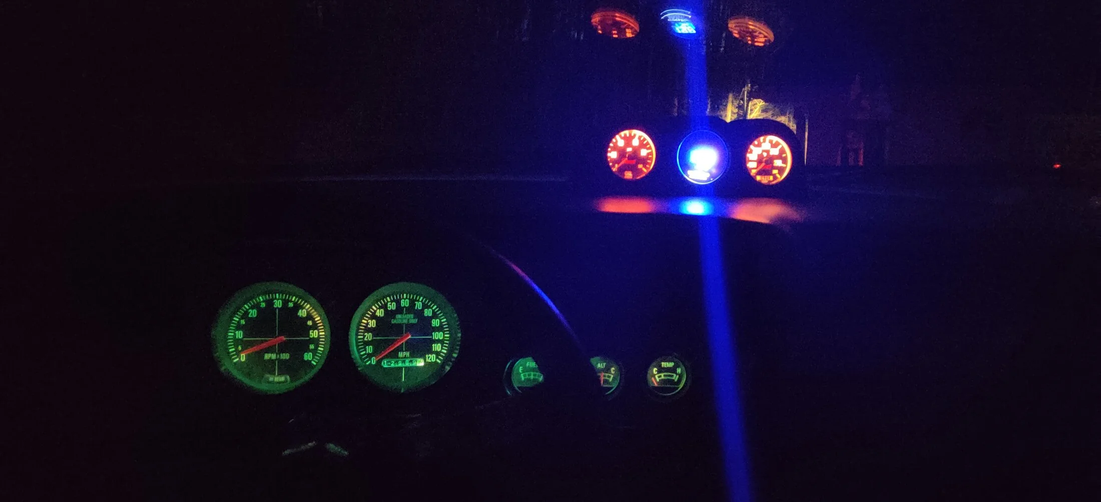

The dash lights work again. Not 100% sure that these connections were the problem, but swapping the circuit board with the one from the other cluster took care of it. As you can see, the connections weren't in optimal condition.

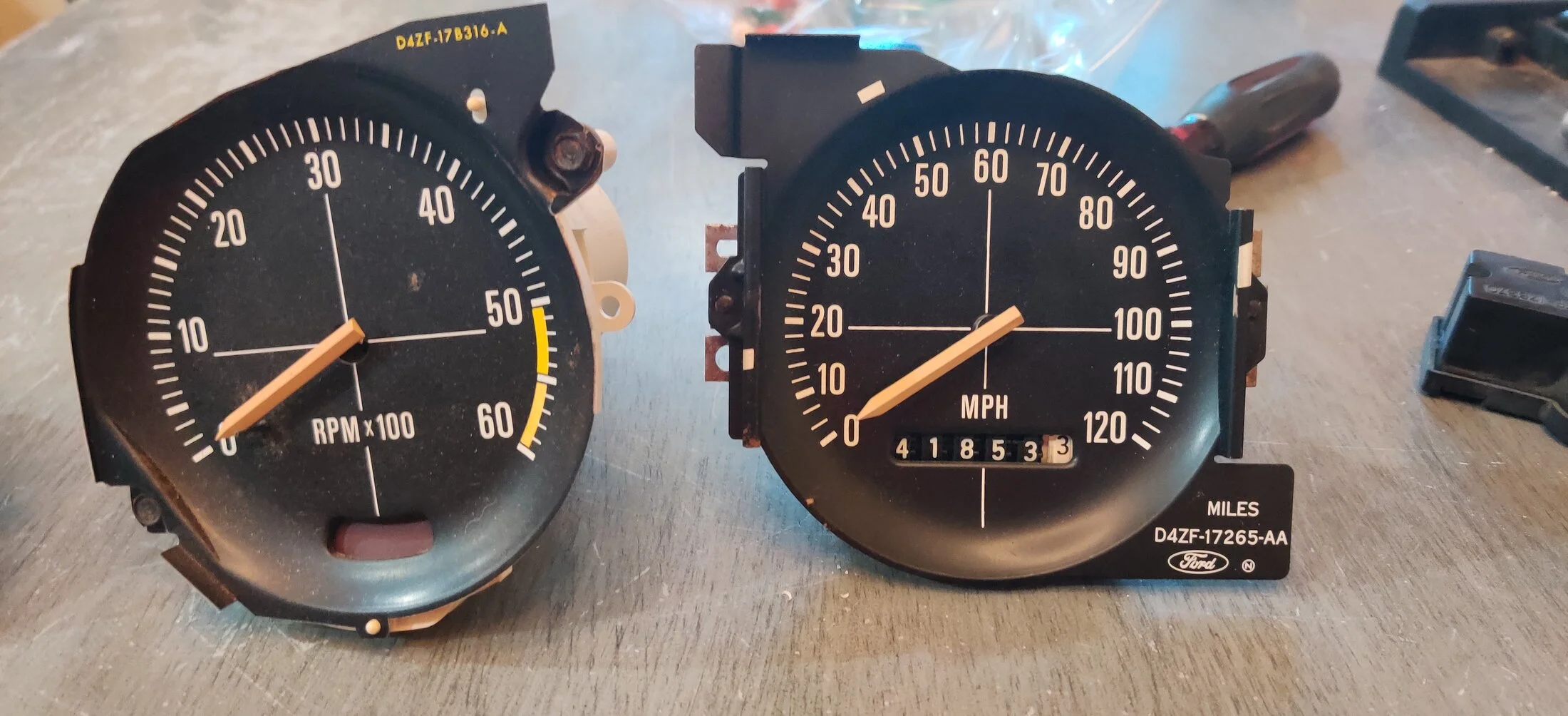

And I had ANOTHER speedometer in the car that I forgot I had. This one is a D4 part number which is different than the other 2. I'm pretty sure it's the needle design as it's the same as the D4 tach. If memory serves, I think I had this in the car to begin with but was having speedometer troubles, so I pulled it a few years ago. :shrug:
I still have the dash opened up so I can see if I can get the tach working, but that'll be another day....
