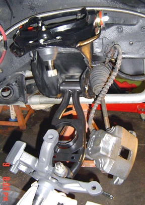

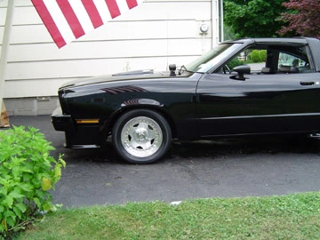

attached is a pic of the king with the new front suspension and my son.

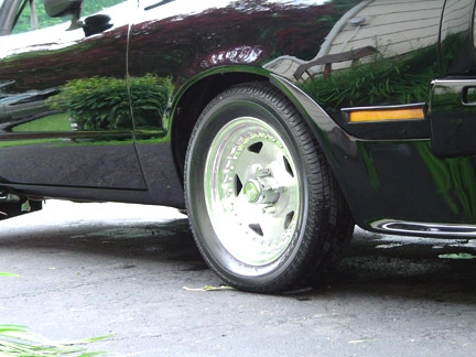

new upper arms, new lower tubular arms, 325lbs springs, strut rods, sway bar end links and bushings, poly bushings all around. ride height came down about an 1" or so. i had to change the front tires to 185-60-15 due to rubbing on the chin spoiler wheel flare.
also installed new exhaust. from the headers went with 2 1/2 into a flowmaster y collector. then 3" pipe thru a cat and over the rear to a imco (flowmaster takeoff) muffler with twin 2 1/2 tips. i used a flowmaster universal tailpipe kit to get over the rear.

thanks but pictures can be deceiving. the paint was done in the fall of 92' so its starting to show it age. paint is getting cloudy. needs a really good detail to bring it back to life.

It appears you did away with the strut on the lower arm. I've seen threads here that say that the IIs lower strut point wasn't strong enough without the strut. What's your experience been? I would think now you have much more clearance for headers. Do you have a part # for the 325lb springs your using?

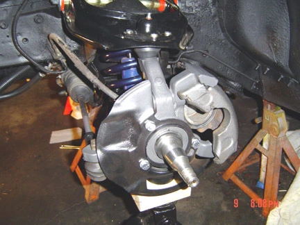

a couple of the suspension

nope. strut rods are still there. hadn't installed them in the one pic and the are painted black so they are not easy to see in the other pic.
strut rods run from the lower arm to the chassis. i believe they are used to reduce front to rear movement and to keep the lower arms moving within in the same plane.
