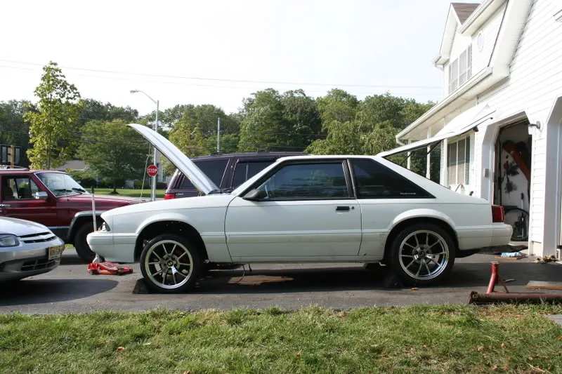

Yep got me some new LCA and UCA's and new springs. The only thing i couldn't spring for were socks/struts. I'll be doing that next summer. The front struts when i had them off were still in great shape and still worked.. the rears however, they are bad. I can push them up and they stay there!
Its slow progress but its getting there

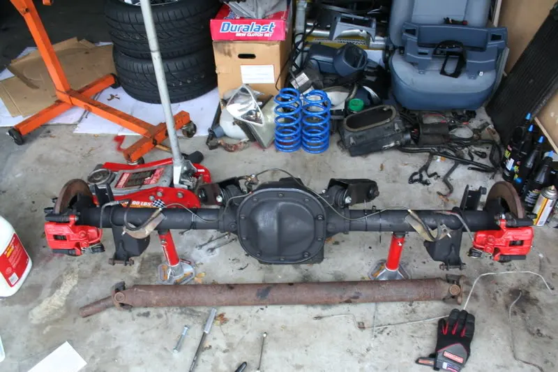

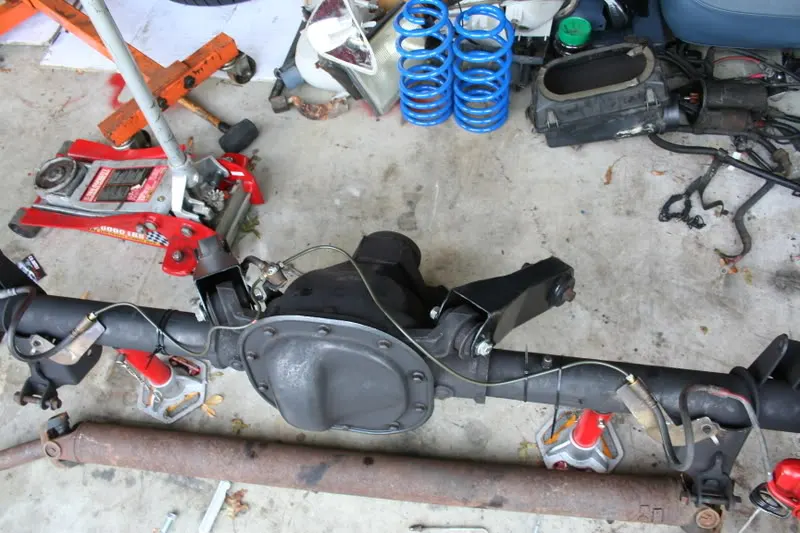

Brake lines = check!
Rear end install = check!

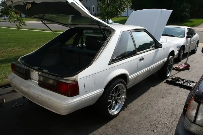

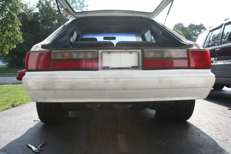

I actually ended up changing the rear shocks, since if you guys haven't noticed i got the hatch open

1991coupe,
not sure if it matters anymore, but if you get 1994-1994 rear sof line brackets, they bolt to the axle and it make s amuch cleaner install.
In 1996, Ford moved the brake lines to the body, so that's why they have such long lines like that.
But if you get 94-95 lines, they bolt to the axle like this
1990Coupe
Mar 11, 2002
1,462
132
114
Toms River NJ
Sep 15, 2008
#180
  • Sep 15, 2008
  • #180
Thanks for the picture. Unfortunatly i had 99+ calipers and hardlines, so i got creative with my setup and my father and I just bent new custom brake lines. I didn't want to have to spend more money, i had the hardlines and fittings lying around so i made them work. Thanks for the pic, i recommend that it be done this way NOT the way i did it
Had i known, i would have tracked down SN95 softlines. Its alright it should work just fine!
