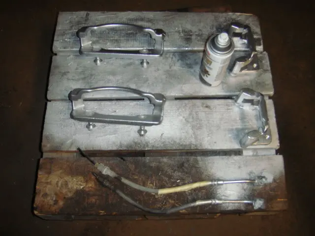

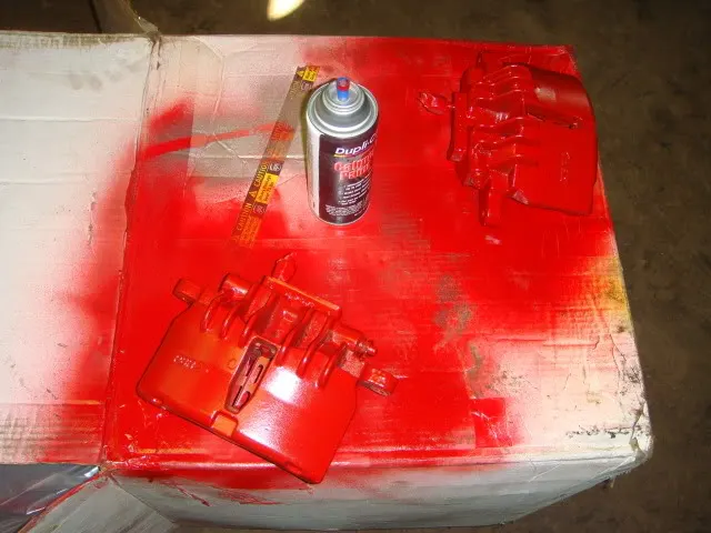

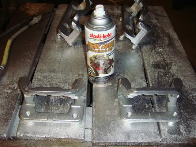

Got here about 8am and threw some paint on the brakes. Work from 9am-1pm, then installing all this stuff.
Front calipers painted.
Rear calipers painted....like my work bench???
Brackets and lines painted also. I am very happy with the finish of the engine paint.

Gettin all the brakes on as we speak. Right front wheel is all I have left. The damn paint isn't even fully dry and I painted them at 8:30 this morning. I'm just trying to handle them carefully. They're gonna get full of brake dust and road grime anyways...lol Pic soon...........

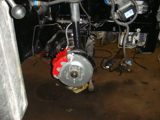

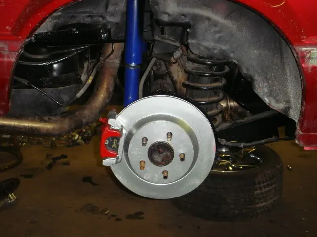

Got the fronts installed....still have to mount the brake hose bracket and get a couple other things mounted...PBR V6/GT brakes. I sold the Cobra stuff a while back. Didn't think I'd build this drivetrain...I might buy Cobra's in the futue, but I'm just going with what I have right now...
Got the rears installed, have to mount the left rear brake line to something to keep it clear from the axle. The right side is close....I think it should clear. These are the big Cobra rear brakes. I didn't want to pull axle shafts to change the brackets, so I just bought the Cobra caliper brackets and rotors. I had good used pads, and the V6/GT caliper itself is the same...
I actually just painted almost the entire rotor in all four corners. I HATE when people don't paint where the pad doesn't touch and then the rotor rusts. I painted the whole surface so while it sits for the next couple months it won't rust just from sitting and temp changes. The first time you touch the brakes, it burns right off and you're left with a perfect painted circle.
I am going home!!!!
