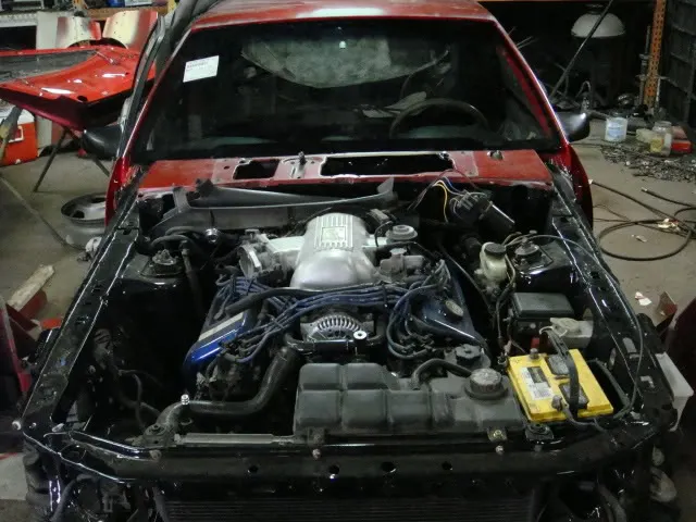

Anyways....got a new Carlite FORD windshield installed today...check it out...

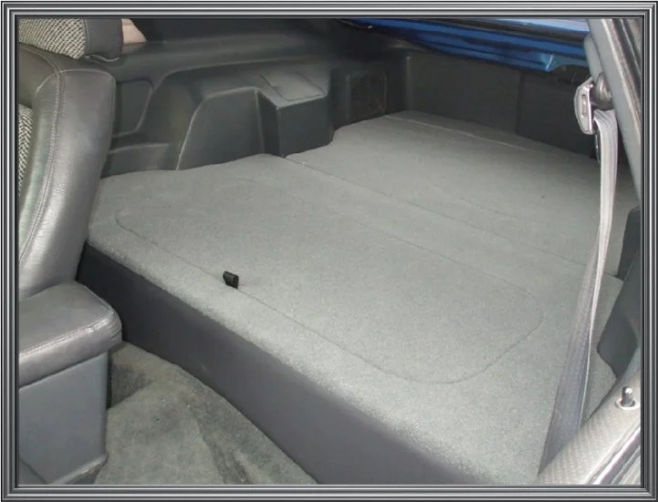

they were in the hatch area. Look at this pic and you can see them. They are in the rear most part. As for the front speakers, try this. If you have co-axials (woofer & tweeter on one speaker) cut the wires going to the tweeters and power the tweeters from the radio, and the woofer from the amp. that way it is working like it was designed. Or, maybe I can make the trip up there and give you a hand....

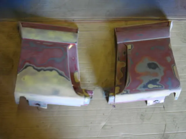

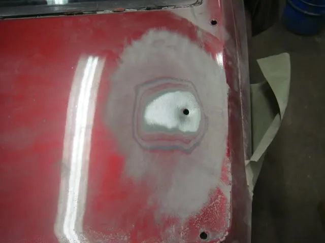

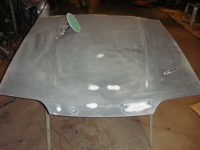

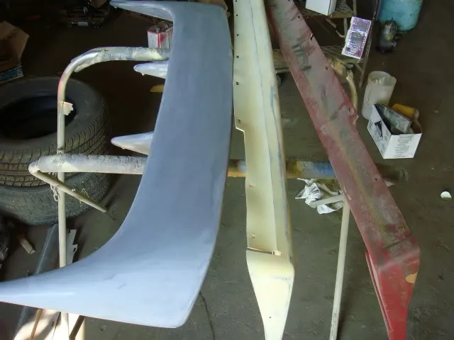

Been working on the hood and the 93 Cobra rear cover I got from Chrome Rust.
The hood is rust free, just had a few dings from storage and such. IT had a beautiful black paint job on it before. I blocked it all down with 150 a couple times, found the dings, found some high spots. I filled in some areas, blocked it again with 150 and then 320. Getting primer tonight.
The rear cover I got from Charlie is an OEM Ford rear cover. He met me halfway and I bought it from him. I had it blasted for $30.00. The urethane was so far deteriorated and sunk. It must have sat for years in hot weather. I spent about 1 hour sanding ithe urethane material down with 80 grit paper. I then blocked some flat areas with 80 grit. I fixed 6 tears in the cover, all small, here and there. I am slightly worried about 2 of them recracking during installation, so I am gonna attempt to paint this thing on the car. I don't want to but I should.
The two that worry me are the two ends....(first pic)
Notice the light and dark areas. The dark areas were sunk a lot. Now they are flat and even. I'm gonna block it one more time with 80, then prime it, then block with 150 and reprime again.....time time time....

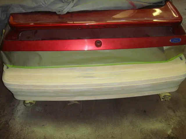

Gonna spray the last 2 coats of primer on the 93 Cobra cover ON THE CAR since the cracks keep on cracking off of the car. I fixed them twice off the car...crack...crack...fixed them a 3rd time on the car....should be okay, but if they crack I'm gonna deal with them.
Got the exhaust pipes straighten out (parts car in an accident) then installed the tips, shave them down to where I needed them. I had them perfect but then found an exhaust leak under the car, fixed that, so now my right tip is out further...gonna adjust that soon. They are slightly larger than I would like but they look good. The Magna Flow on the tips is hard to read but if I put them out so you can see the writing they are out too far and looks ghetto.
Ground effects were mostly stripped and leveled....hopefully paint Friday night or this weekend Saturday/Sunday. I've been saying paint time for 3 weeks, but I keep finding other stuff that needs prep.

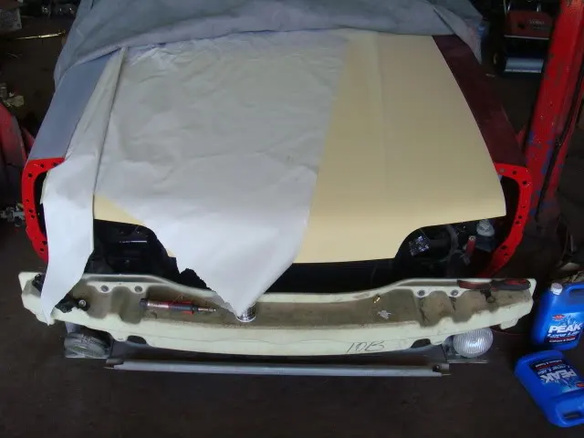

The biggest thing is that I got the hood and fenders all lined up with my Dad on Saturday. Everything lined up good. Final adjustments will need to be made when I hang the cover, so I didn't put the fender bolts in tight. (Gonna spray some yellow primer over the gray primer on the RH fender. That grey stuff is garbage. It balls up when you sand it.)

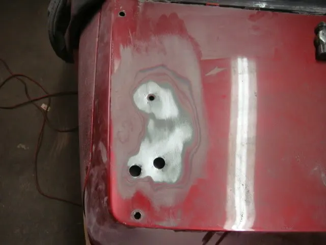

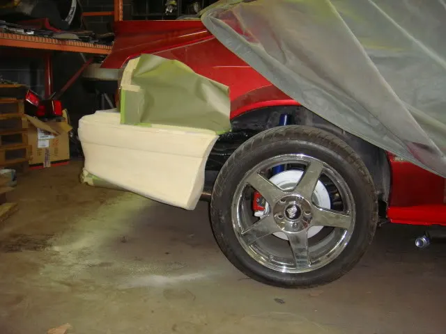

Got the Cobra spoiler mocked up. You have to fill 2 GT spoiler holes on the left side and one hole on the right side. You also must drill a new hole for the 3rd brake light harness on the LH side....it's the outer most hole. I am NOT drilling the 4 holes in the middle of the hatch for the center mount studs. Half the time the metal warps and I'm not gonna deal with that. I'm just going to put some two way tape to fill the 1/16" gap between the spoiler and the hatch.
This didn't thrill me at all. I was almost going to say screw the Cobra spoiler. It pist me off once I realized I would have to spend 4 hours sanding, bondo-ing, priming to make this work. I stayed long enough so 2 coats of bondo could dry and be sanded and primed. I wanted it done in one night so I could stay on track for this weekend.
Got the 4 side skirts stripped and primed in a 2K urethane primer. Also fixed some spots on the front cover that weren't all that bad.
