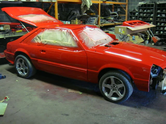

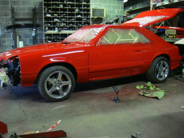

I did a pretty good job. I got a new paint gun so I was off my game a little bit. Got a couple runs I'm not to happy about but they are low on the car. I'll block them out, but at least they aren't in front of my face on the higher spots on the car. Next step is to wet sand the whole car with 1500 on my new Hook-It DA set up. Then I'm gonna hit it with 3000 on the DA and rub it out.
Thanks bro....I think this might give me some motive to finish it. Wanna get the outside done, get the quarter windows in after I refinish them and get it home to finish the interior. Hack Job was done in May of 07, but I also started on it 5 months earlier. So I guess 5 or 6 months isn't bad for this project.
You do some damn fine work, man.

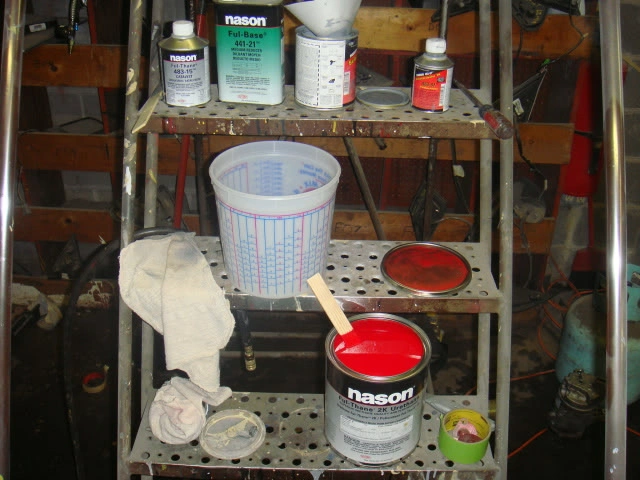

Do you spray in that garage we're looking at, or do you have a paintbooth? I do see some red on the floor. Just curious what you do for ventilation, overspray, etc.
Thank you. I spray right in that room. The car was about 6 feet forward so I could get behind it, I just need some more room in the shop today so I pushed it back.
I paint there, sweep and wet the floor down. I have a huge exhaust fan in the roof of the building that really sucks the fumes out. You can see the fumes just pulling up and out. The lighting is okay, I could use more lights so I could see what I'm doing on the passenger side. I just know where to spray I guess even though I can't see. :rlaugh: I get some dust, but everything I do gets wetsanded, rubbed and detailed so in the end the product is great. I also have radiant heat above so the car gets pretty hot when I kick the heat on.

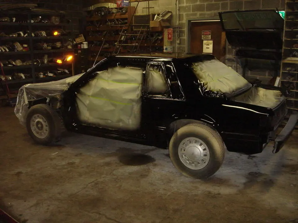

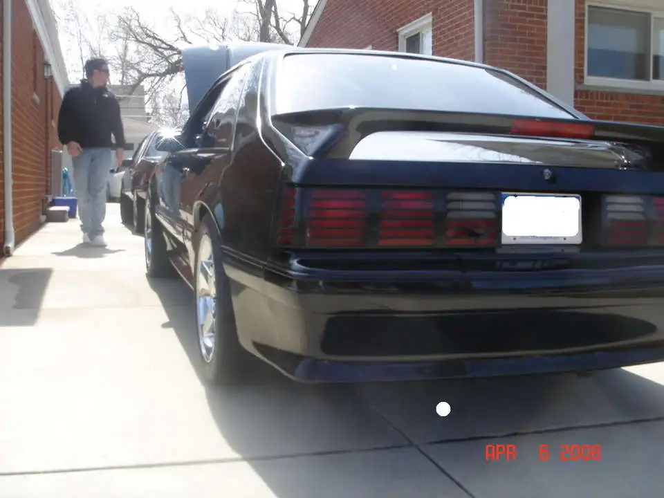

Would you ever do black? I've met a couple guys who paint in their garage, and what I usually hear is that they won't do black because it shows imperfections much more. Seems like they think black should only be done in a paint booth. Just curious what you think. Someday I may attempt to paint my own car... Black, of course. :D
Ah, I completely forgot about the black coupe! I didn't know you painted that one, too.
Are you self-taught painting, or have you worked in a body shop before?
You forgot????:eek: :mad:....how could you forget??
J/K!!! It's been 4 years. Sometimes I forget I did that car!!:rlaugh:
Anyways as far as painting goes....my Dad worked in a body shop for 16 years before he bought the yard. As a kid (3-4 years old) I was always in the garage with him. I got my first car, a second, then my third (which was the first Mustang of mine). We sent the first 2 cars out for paint. The Mustang.....my Dad wanted to try it. He had never painted before either, he was a body man, frame straightener, welder fabber ect.... So basically, we are both self taught. I watched him paint every car that we would fix until 2005. That's when I just said, I'll try it. It was on a black 97 Cobra and it turned out good. Ever since then, I've been painting everything.
