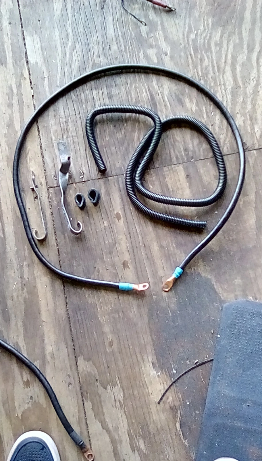

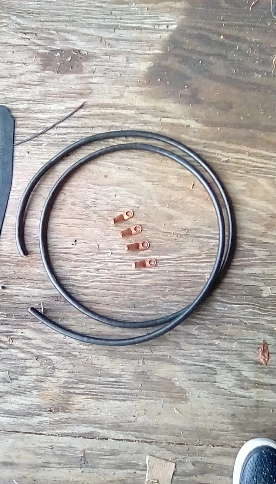

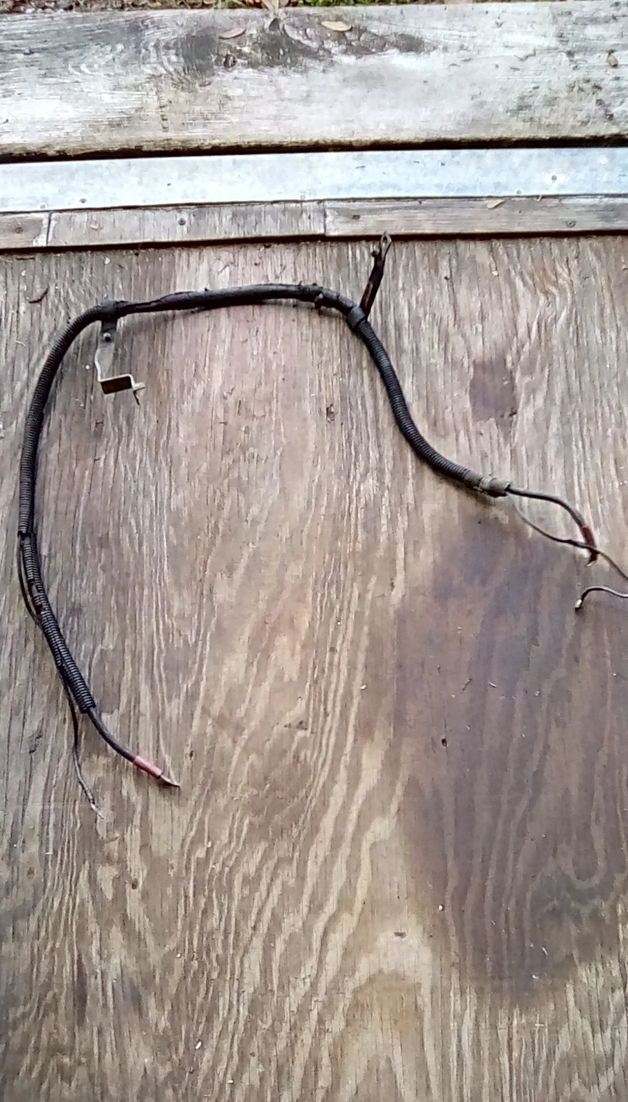

To get this party started I'm going to document for your humorous pleasure the repair and up grades on this fine piece of automotive equipment, first I will attempt to resolve a slow crank issue when hot. Not the battery, not the starter, just 29 year old inadequate starter cables, I hope. Got some 4ga cable, some ends for bolting to solenoid and starter and attempted to glue it together. My job is to make this:
look like this:
Easy enough right?
some of you know me, I like to have a little fun so I'm standing in the parts store with my 4 connectors and a tube of black gasket stuff when the guy brings me 6' of 4ga cable, holding the tube of gasket maker and the connectors out I say ' this will work right? He had to think about it but said no.
back at the garage I spend 45 minutes trying to glue the crap together only I can't with the gun I have so off to the shop I go for the big stuff, 30 minutes later I'm heading home with glued on cable ends and a smile on my face. I'll be grinding gears in the valdez soon, I'm sick of driving the 'dump truck' and a focus se is not my idea of fun transportation.

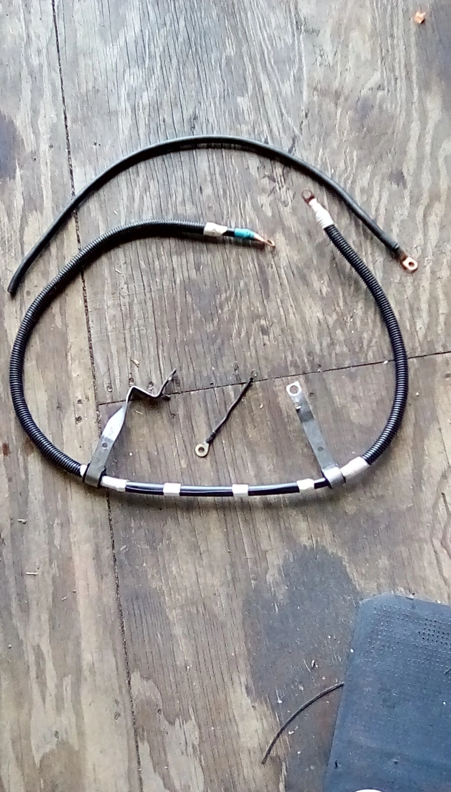

now this
looks like this
a couple hours under and over the valez and we gots new cables and ready for the test run! I did notice a couple new issues that add to the list of repairs, but they are never really done are they?

For battery cable ends i just use a propane tirch and solder. Take some pliers and squeeze the corners where the flatten them out. Then put lock pliers on them to hole the straight up and fire the torch up. The solder melts in there pretty fast....dip the cable in....heat shrink and done.

Thats zackly what I did, I didn't have any propane at the house so had to make a trip to the shop.
Surprised no one said anything about the white tape I used, they didn't have any black when I bought it, same stuff they use at the factory just the wrong color. Some kind of glass infused stuff, kinda pricey.
