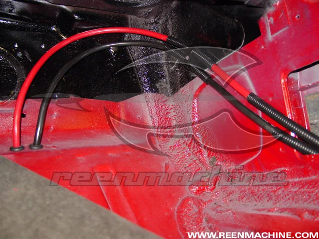

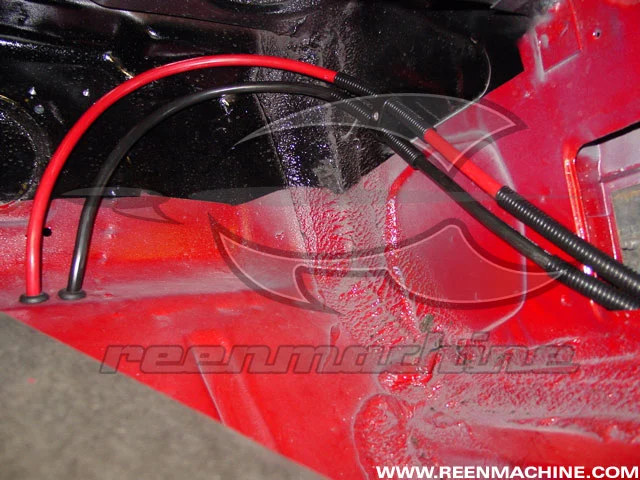

The battery is mounted in the trunk, and I'm running the negative cable all the way to the engine as well to make a better reference for the engine sensors. The late-model starter with integral solenoid is basically right through the firewall from here, and the engine ground is nearby, so it worked out perfectly to pop the cables through here. They tuck right up behind the HVAC box (it's out in this pic obviously):

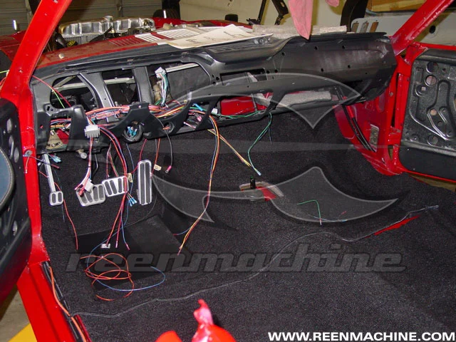

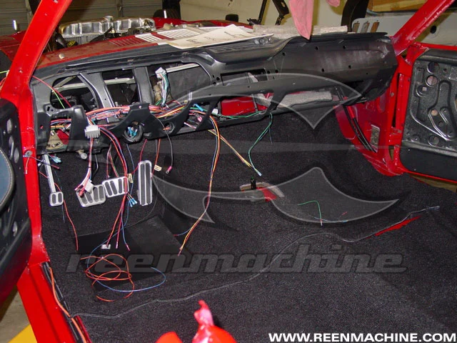

I'm starting to stuff everything into the dash. The harness is basically done in there -- I just have to tape/loom it all up:

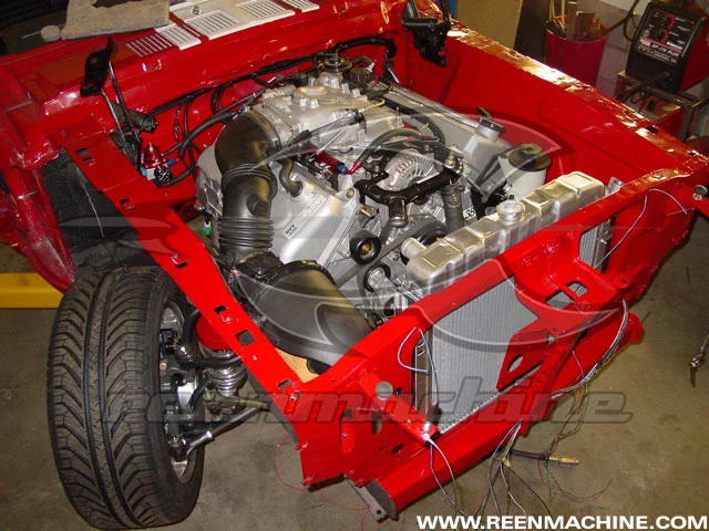

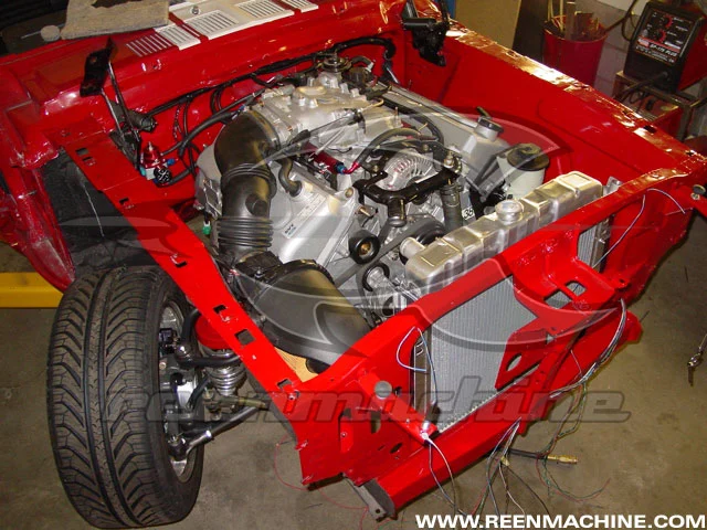

The engine compartment is being kept as tidy as possible given the myriad electrical and fluid connections. The fuel system is complete, the EFI wiring harness is complete, and the rest of the plumbing is coming along:

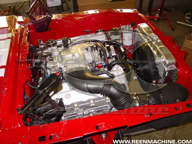

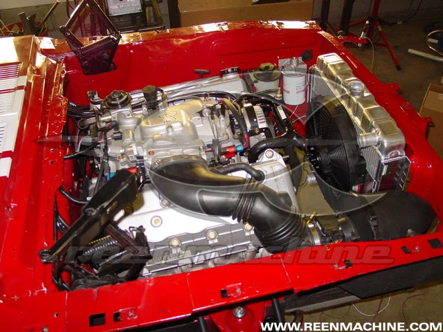

The radiator, remote oil filter, and oil cooler get plumbed up next:

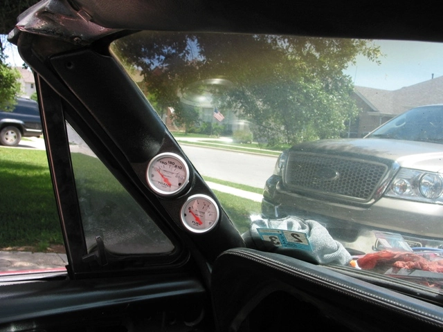

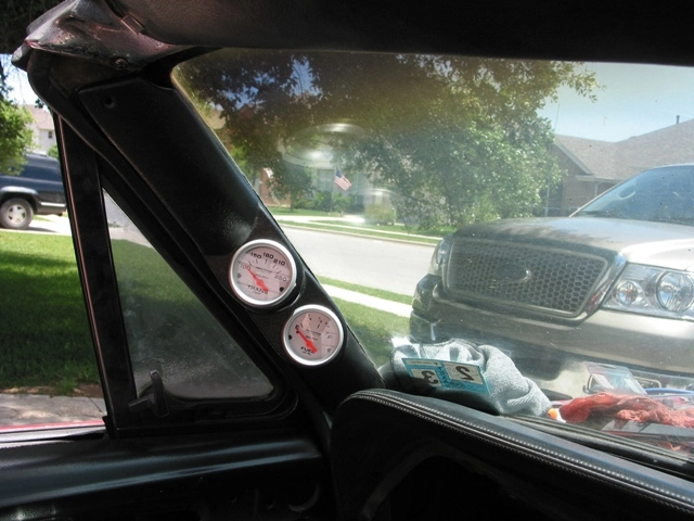

What choice are you making WRT only having thee holes for the smaller gauges? I took amp/oil/water and left out fuel. You gonna use an A-pillar pod? I tried but the ones on the market don't fit quite right for us vert owners.

Edbert said:
NP bud, keep up the excellent work!
I'm doing fuel level on the left, oil pressure in the center (figured that should be most visible), and water temp on the right. The car is getting a custom console, and I'll put Volts and the clock on there.
