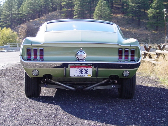

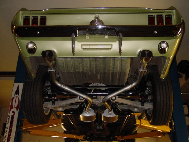

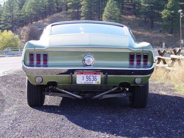

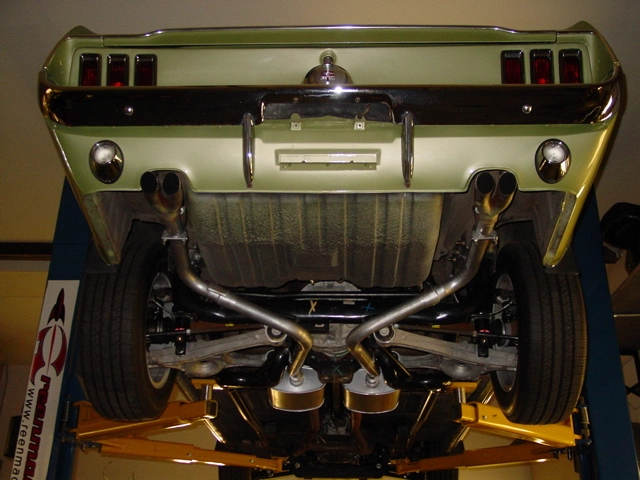

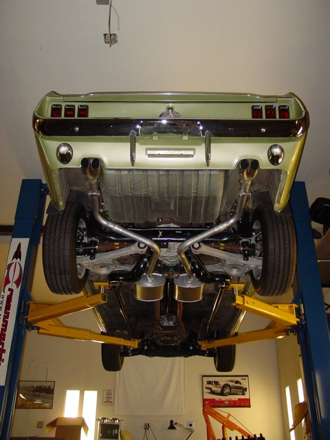

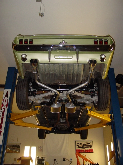

Do you have any shsots of the car from the rear at ride height?
Are the control arms parrallel with the ground?

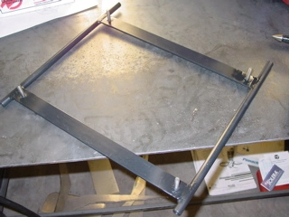

Hey Reen, Quick question in regards to the Elite seats - does that $695 come with your version of the seat rails with the welded studs, similar to the original?
Nope, but I'd be happy to show you exactly what I did. It comes with the mount in the pic you attached, with holes that line up with the holes in your floor. They expect you to use a bolt & nut, which is no problem if you have someone to help you out. Make sure you use a grade 8 bolt and lock nut.

Hi Reen,
Bob-

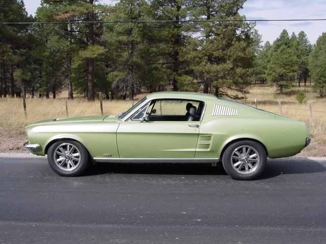

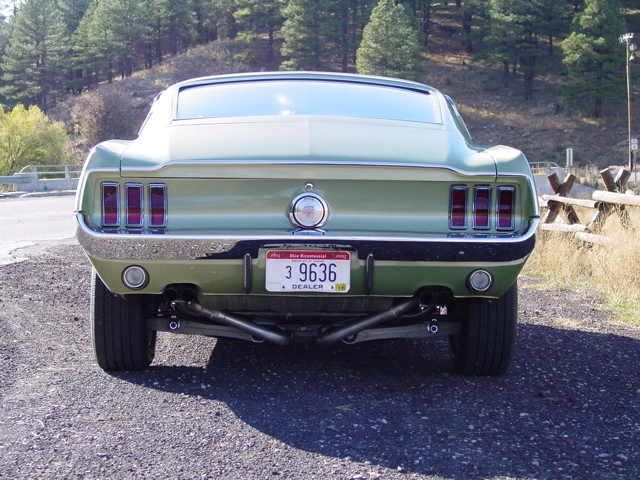

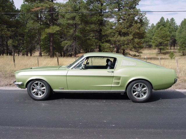

Here are some more pics. The control arms aren't as parallel to the ground as I'd like when the car is at the ride height I like. Dave at DVS has a good workaround for this that I am going to undertake that involves some modifications to the cradle. I saw it on one of his cars and it makes it perfect.
Hi Reen,
Looks pretty good.

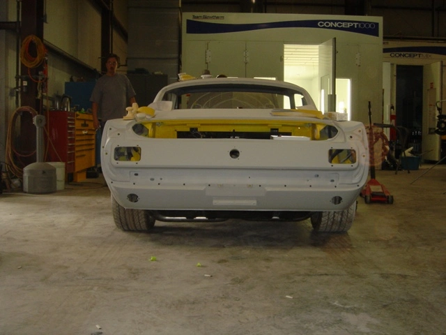

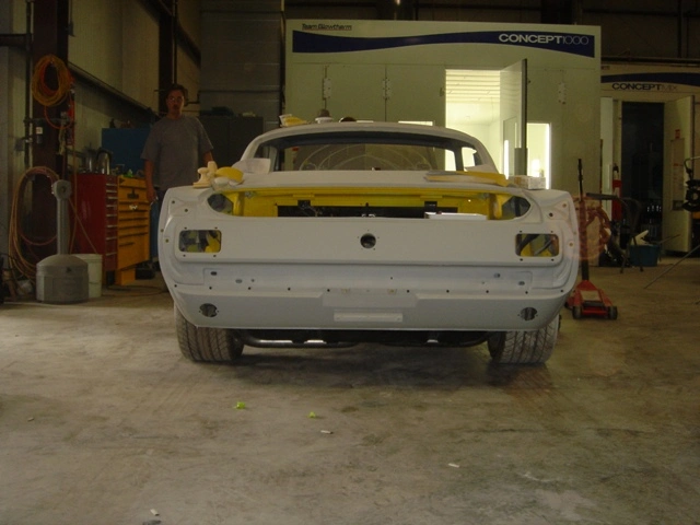

Here is a picture of our project from the back
I know that you can't see the control arms in this shot, but they are sitting horizontal.
Catch you l8r.
Bob
Edbert said:
Hehehehe Bob...guess having the inner chassis from a SN95 helps that out a bit eh?
Hi E,
Yes the SN95 chassis helps, but the real difference is that when we grafted the two cars together, we possitioned the SN95 chassis about 1" higher than the original 65 trunk floor. That and the different rail configurations are the bigest reason for the different apperance.
Bob
reenmachine said:
The new cradle mods will lift all of that up over 2" into the car, so the rear appearances will be similar in the end.
Hi Reen,
2" should do it. That should give you a slight downward rake to the control arms, which should be just perfect. I look forward to seeing the end results.
