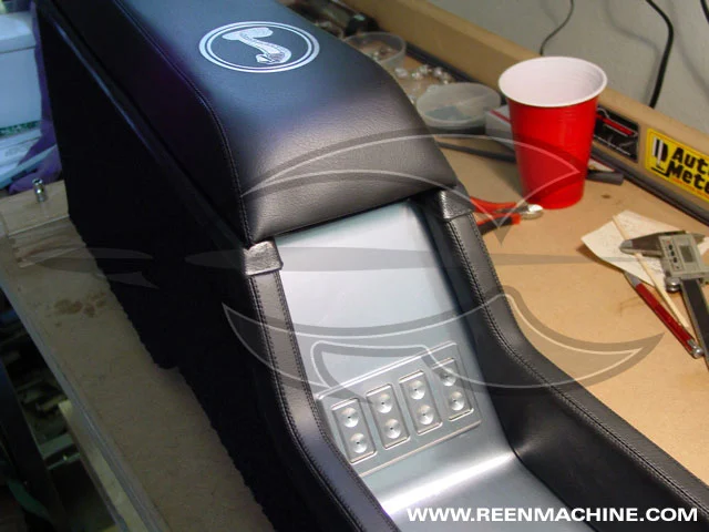

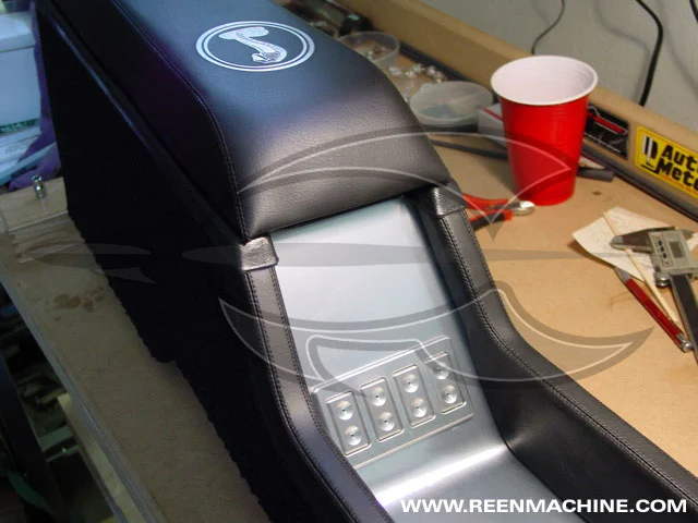

Here's a pic of the power window switches mounted in the console. They're right at your fingertips when your arm is resting on the armrest.

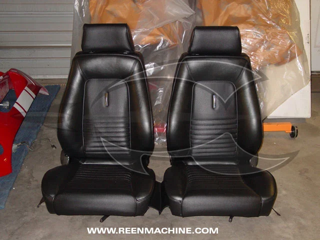

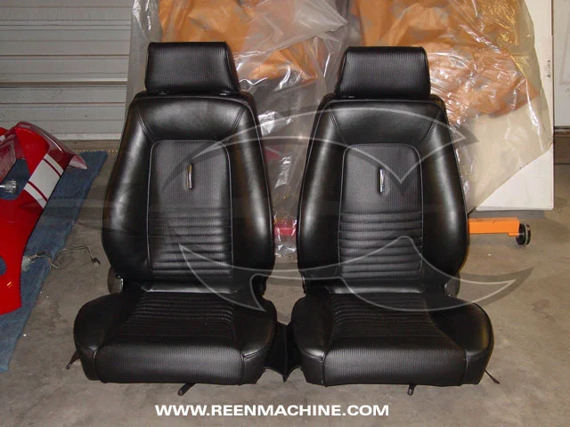

I picked up the seats from the upholstery shop yesterday and they're magnificent. SCAT Procar Elites were the foundation, but the foam and upholstery is completely redone to follow the lines and style of '67 Shelby seats.
