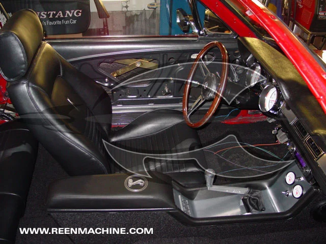

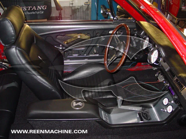

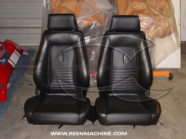

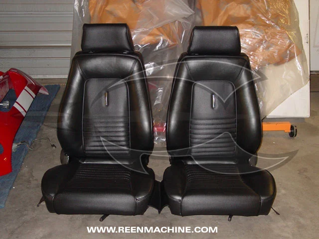

I picked up the seats from the upholstery shop yesterday and they're magnificent. SCAT Procar Elites were the foundation, but the foam and upholstery is completely redone to follow the lines and style of '67 Shelby seats.
Ok, these are sweet. I don't know if you said who did the upholstery, but who did it? These are awesome.
They were done by 1st Upholstery in Tempe, AZ. I'm taking two other sets there this week for other cars -- after sitting in them in the convertible it's the only seat I'll ever use. In addition to doing the upholstery, they improved the foam, making them feel just awesome.

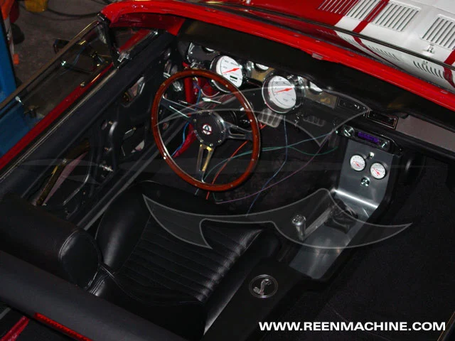

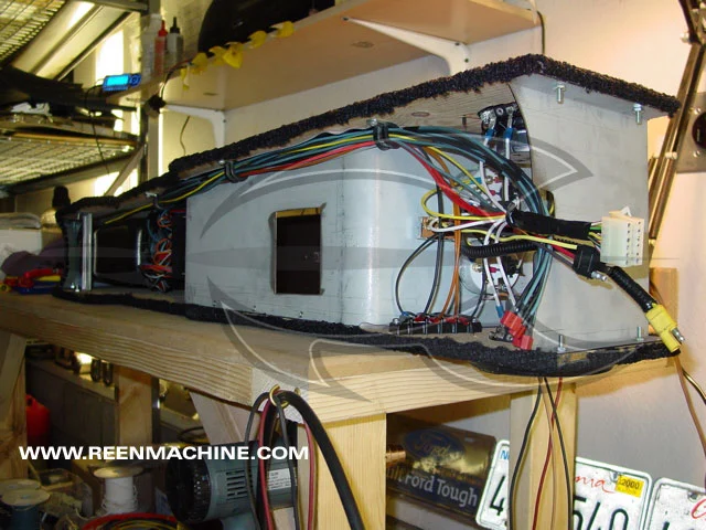

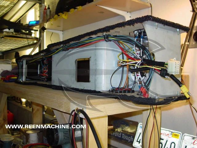

Here's a pic of the wiring in the console. Ended up with 25 wires needing to come out, even after consolidating grounds, power wires, lighting wires, etc. I terminated them all at connectors to make everything easier to get in and out.

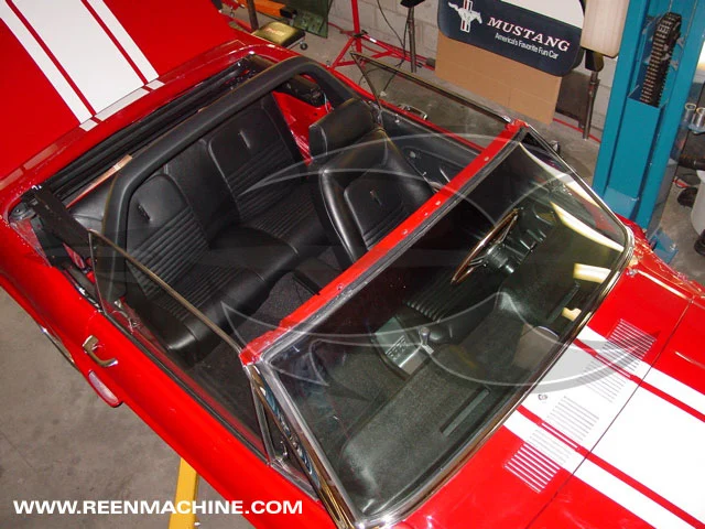

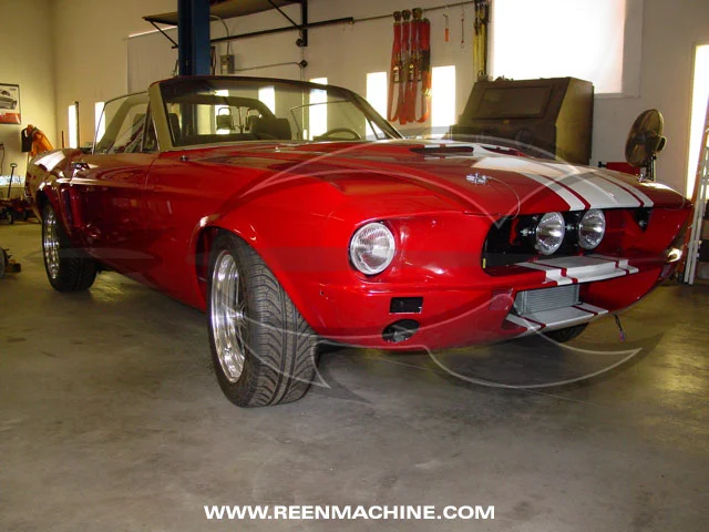

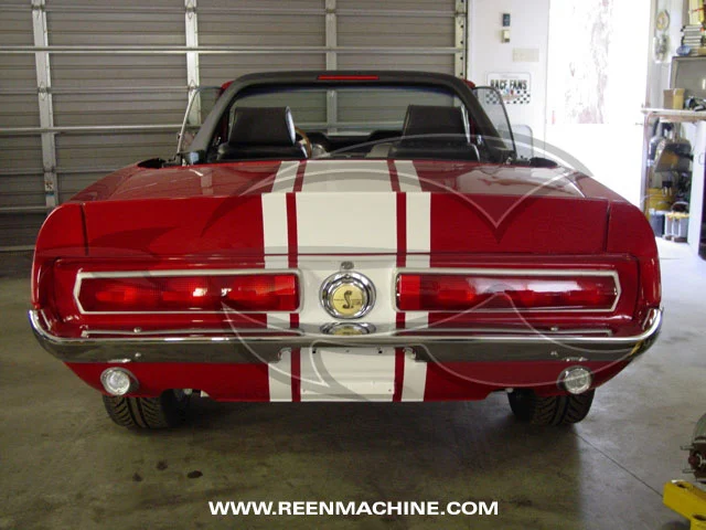

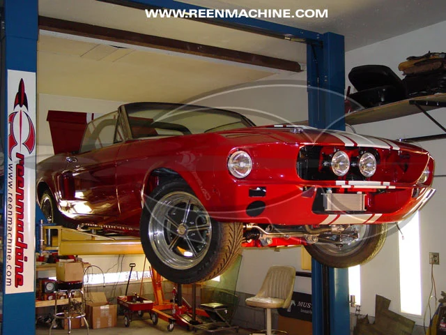

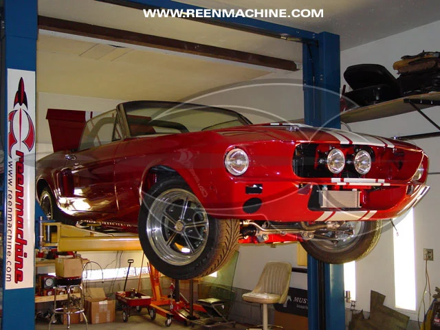

Been working on the green fastback lately -- check it out here:
http://www.reenmachine.com/forums/viewtopic.php?t=116
It's being built as more of a "driver" and it will be a riot to drive.

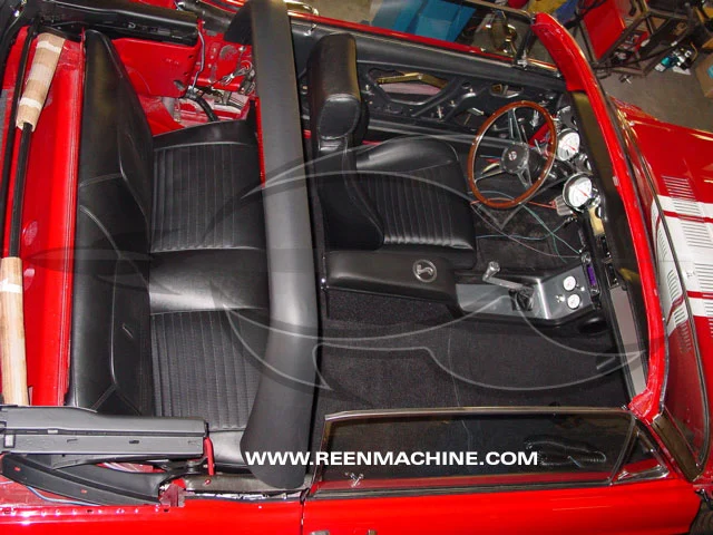

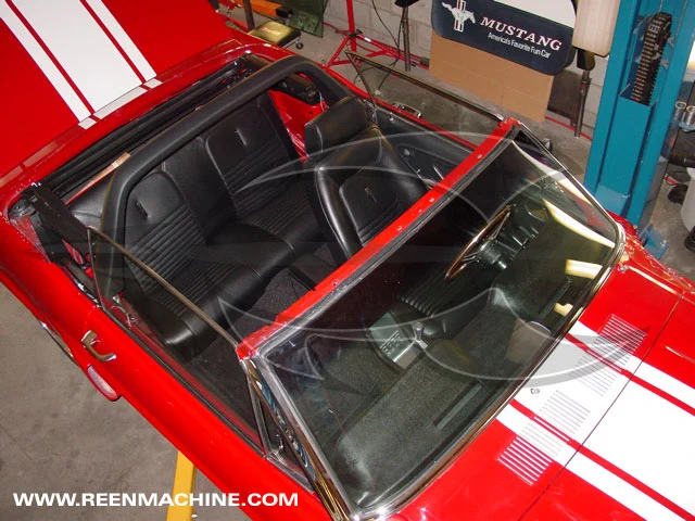

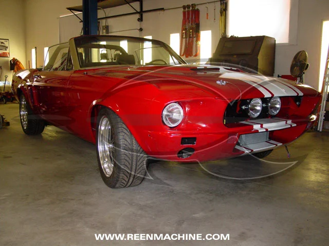

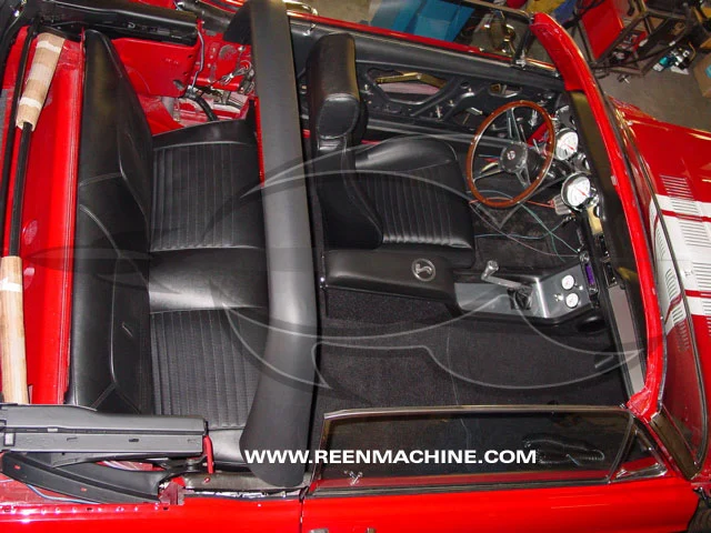

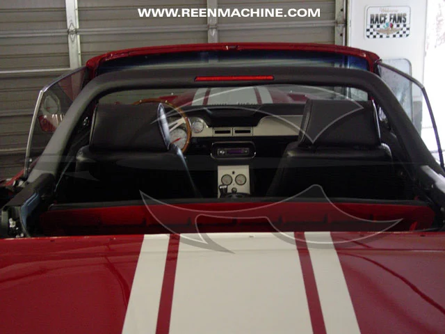

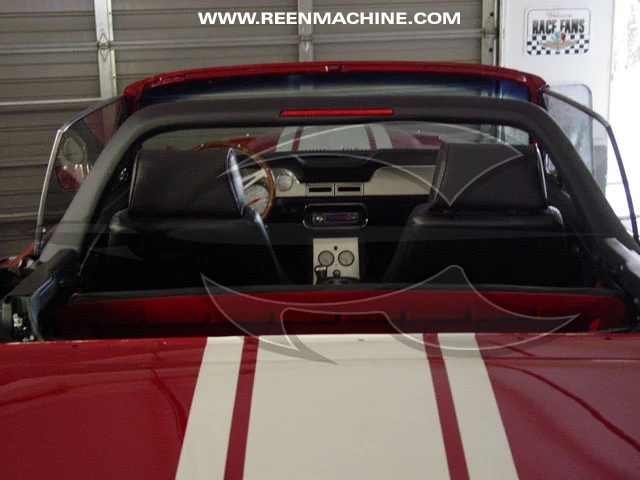

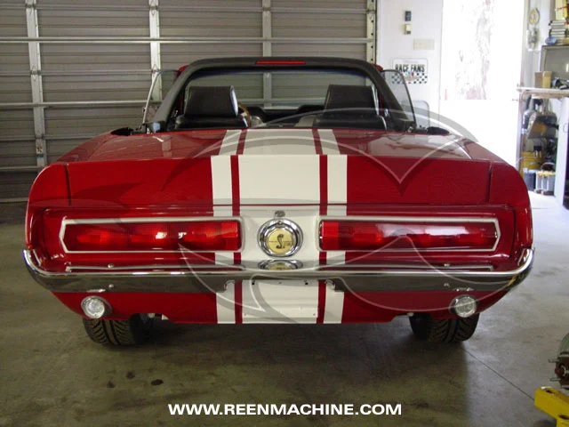

Anyway, I re-hung the 'vert's fenders and nose and it will be off to the body shop soon to have the panels realigned, gaps set, stripes done, etc.
The latest pics really give you an idea of what it will look like done:
