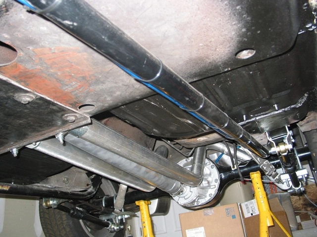

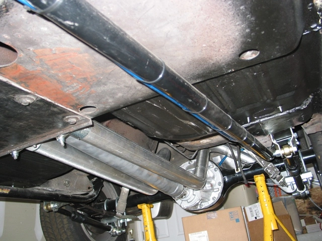

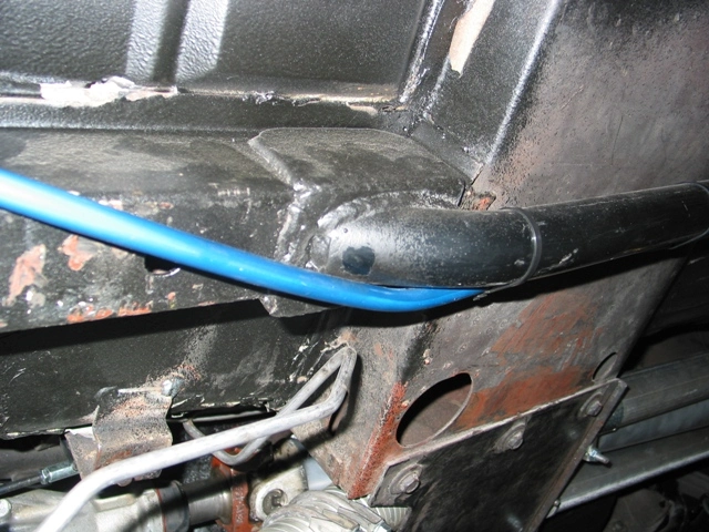

Regarding 2.5 inch exhaust tubes in the tunnel on a 67 vert...mine worked, and that is with a 3" driveshaft.
Sorta embarassing to post a pic of my jalopy in the thread with the OP's car. I'm just illustrating the question that was asked as Pete's out enjoying his handywork.

oh, I see what you did . . . (NON-REENMACHINE PICS)
(sorry, this probably belongs in the Magnaflow 2.5 convertible kit thread, and I'll crosspost and we can continue over there)

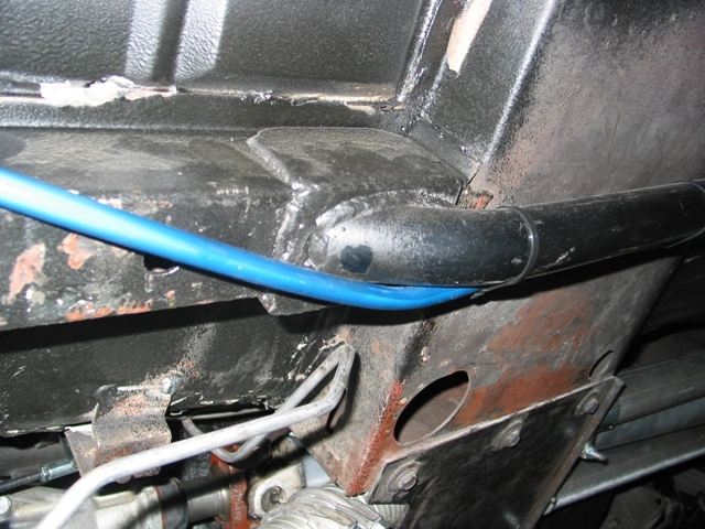

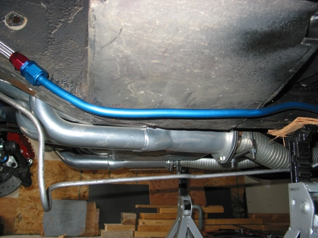

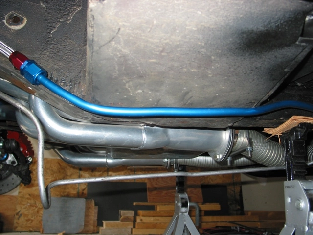

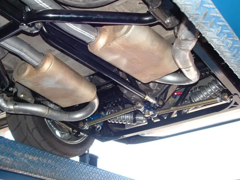

I have the Magnaflow kit and still have the X-pipe issue, but these pics are what I was more interested in: (hope you don't mind me going to the root directory of your link there)
and
where did you get that flexible exhaust tubing from? That's some inspired work there. What would have to happen with the Magnaflow kit is that the X happens just before the center plate, but you could angle it up, put that flexible tubing after it (maybe even before it too) and get it up and over the plate, and then you'd be good to go.
Great pics and great idea!

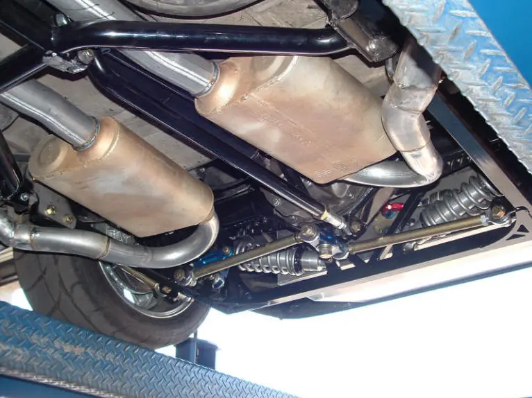

You could consider a flattened x pipe from dr gas. We wedged it in between the belly of a tko, the tcp center section front cross brace and the driveline. The tolerances are a joke. But it does not touch. We've got a great exhaust guy around the corner. They're hard to find these days. If it can fit in there, I'm confident it could fit in a vert!
Here's some new handy work he did with the rear side exhaust a few weeks ago...
