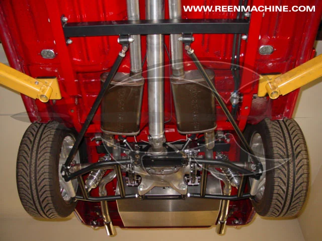

The exhaust came out awesome -- I wouldn't change a single thing. They tucked everything up in there so well that you can't even see much looking at the car from the side. It seems that so often you see modified cars with the exhaust hanging super low.
MUFFLER MAGIC in Flagstaff, AZ, 928.774.9276.
Travis, the Manager, did all of the work. I think he stepped in on this one and pawned the regular everyday stuff on his employees. :p
I'll post pics later -- I'm just trying to get to the point where I can crank this thing. I burned up an in-tank fuel pump, which was kind of a bitch to change. I'll explain later.
Here's a pic of the exhaust. Nothing comes even close to touching the IRS through its range of motion. The tips are '67 Shelby repro modified so they don't neck down to 2" at their inlets.

How about some pictures of the exhaust? I should be finishing the exhaust around/over/through my IRS this week.
