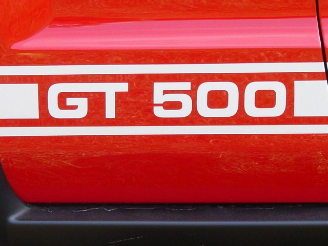

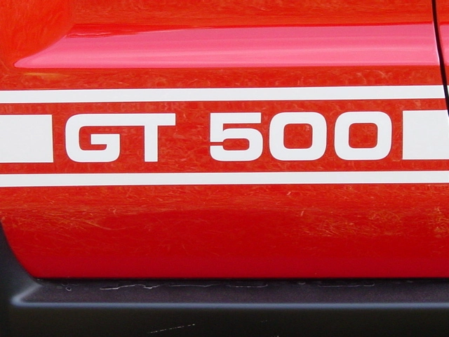

Here's a pic I took at Carlisle -- it's how they do the "GT 500" graphic on the 2007 prototype. I think this is how I'm going to do it on the convertible. A subtle touch of new school flavor like the rest of the car. What do you guys think?

Nice dude!!
If it helps, I'm a graphic designer and the font is called 'Eurostyle Bold extended'. If you want I'll set it for you and supply it as a vector graphic. Just tell me what you want set.
That goes for anybody at Stang net the Mustang font is Called 'Bookman Bold' and if anyone needs anything set I'd be glad to help.

That would be fantastic! Email me and we'll do it.

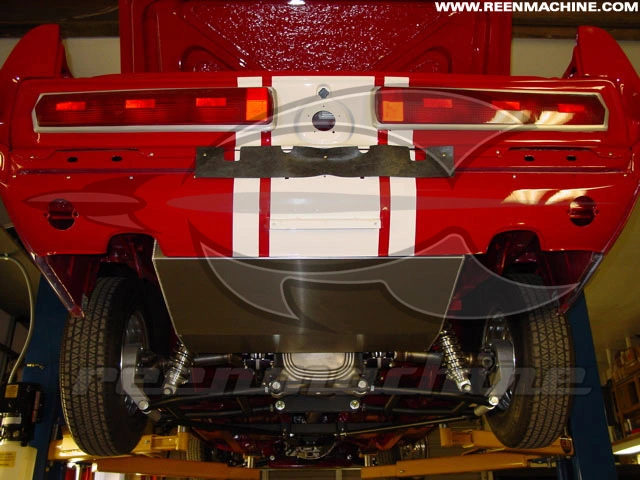

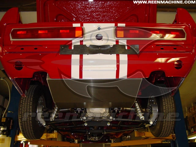

Got the fuel cell in and it fits perfectly in there. It needed a bit of a trim here and there on the mounting flange but no big deal at all. I got the kit to have it fill from the stock location & I'll take a pic of all that when I get it installed.
It encroaches a bit on the left exhaust outlet on the valance, but not so bad that it'll be a problem. They'll angle the left side of the cell inwards a bit at the bottom for exhaust clearance if you want them to, and in the future I think I'll opt for that.

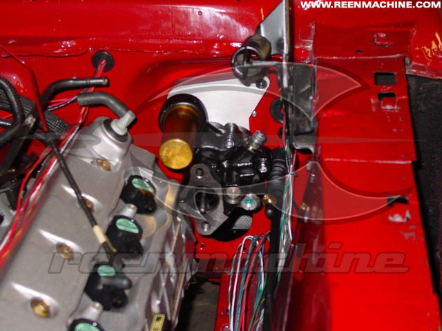

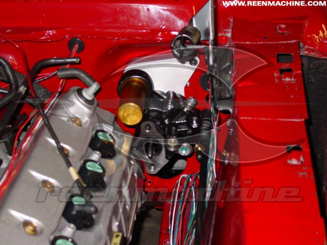

The next big subsystem project is the hydroboost. There are some close clearance points with this giant engine (as you can see) so it's taking some finagling. You can also see part of the cable clutch in this pic.
