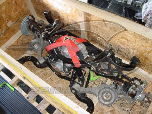

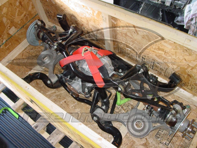

Got the NOS 2000 Cobra R IRS here and got it into the customer car today. It'll all come back apart again to clean it up and make it look brand new. It's NOS, but has been sitting around for 5 years so there's surface rust on the bare metal parts, dust all over it, etc. I also have to remove the aluminum uprights and do some very minor machining to make them work with the 13" big brake kit I'm putting on.

Edbert said:
What is different about the Cobra R's IRS and the regular one?
There are some notable differences throughout the years:
1999: 28-spline axles, 3.27 gears, soft rubber bushings
2000 R: Massively more beefy. 31-spline axles, exotic 3.55 Girodisc hydro-mechanical posi unit, improved CV joints, improved camber adjustment, hardest bushings of any of the IRS units. Reduced wheel hop.
2001-02: Basically like 1999 but with a small axle improvement; axles are 31-spline on the inside but still 28-spline on the ends. Gears are 3.27:1.
2003-04: Much more like the 2000 R unit. 3.55 posi (but not Gerodisc), 31-spline axles (a bit shorter), hard bushings (still not as hard as the 2000 R), improved camber, improved bump steer.
info from the DVS Restorations website
awesome car!! I have a dumb question about the rear end. What does it use for upper arms? I only saw the lowers and struts. are the halfshafts supposed to act like an arm? and also on that note with inboard brakes... what happens if you snap a half-shaft?
I assume you're referring to the red convertible. Yes, the half shafts act as control arms as well. They are designed to do this and can handle all of the loads involved. If one fails, you will have suspension failure on that side manifested as a radical change in camber, but it's built not to fail. There are thousands upon thousands of cars on the road with this design, commonly referred to as a "Jaguar IRS".
