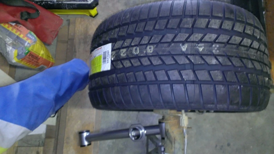

I pulled the stashed rear end out from under all of the junk I've heaped on it,...and bolted a wheel on the hub. Mocked up a lower real quick like, then.........:doh: took this pic:
Now,...I know this is far from exact science,.....but seems to me that not only do I have a measly 1.5" to spare, I got like 3 times that. What the hell was I worried about?:shrug:
