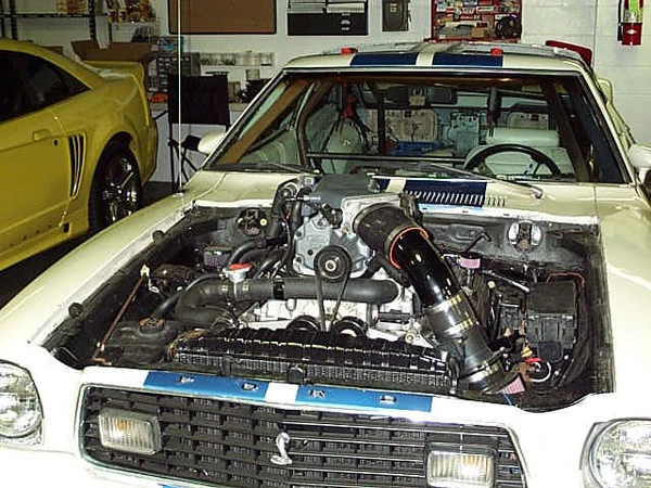

This guy used to post here... that's the Supercharged 5.4 2V from an F150 Lightning in his Cobra II.
May need some minor hood adjustment. Although I can't tell for sure from this angle.

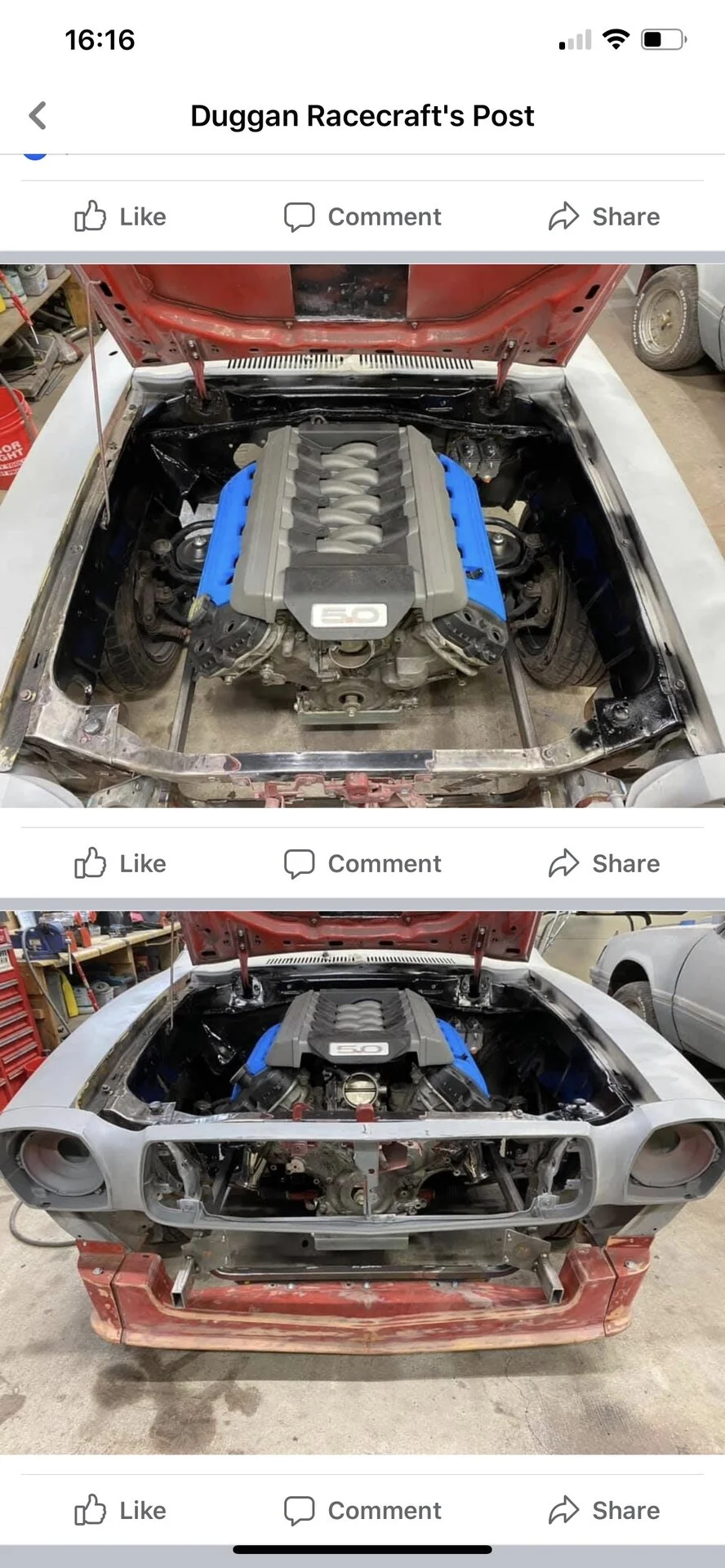

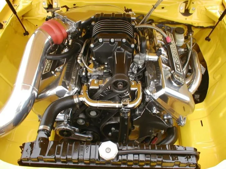

The coyote swap is already being done anyway. This guy is going to twin turbo his gen 2.
On the one hand... I could probably be done faster with my plan to do it more like this:
On the other hand, with that tubular front end, he's probably going to have a better-engineered swap.
