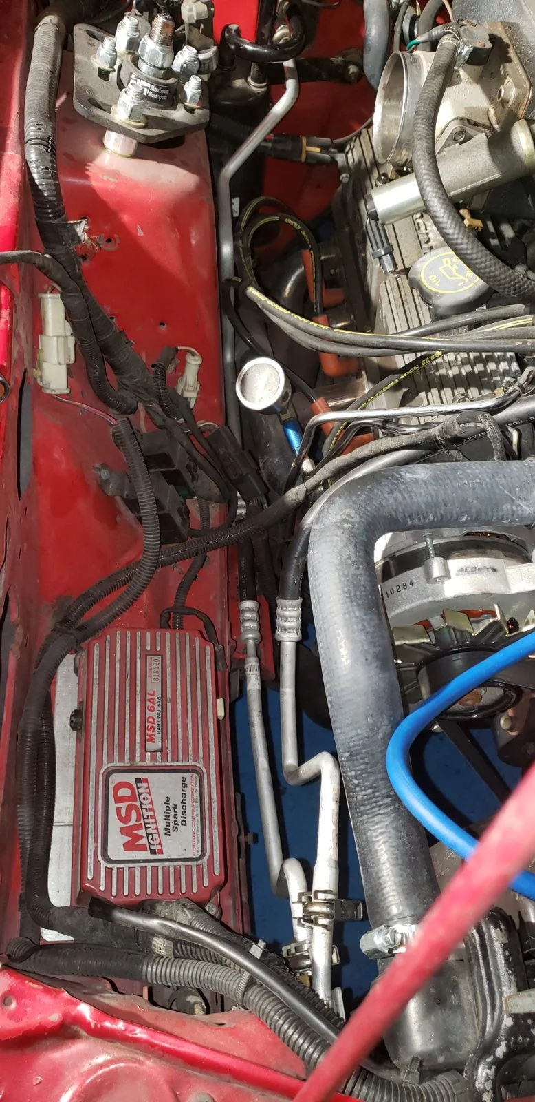

Here is a pic of where the line is so close to the header.
kiddiccarus
The first widely accepted Tranny
20+ Year Stangneter
Dec 24, 2003
1,789
1,051
143
30 Mins from a Ragged GT
Apr 24, 2020
#806
  • Apr 24, 2020
  • #806
But where is the end where this will plug in at?

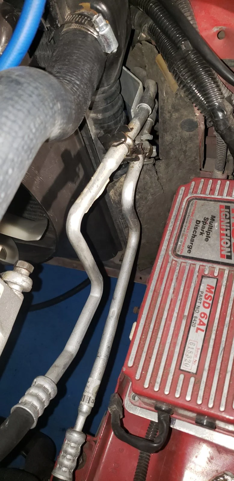

It's the line on the bottom.
Yeah, I know everything is dirty right now.

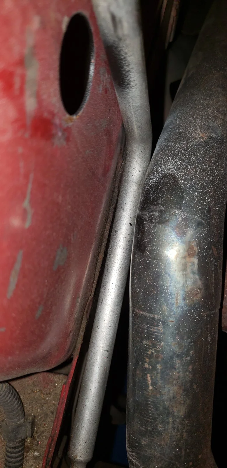

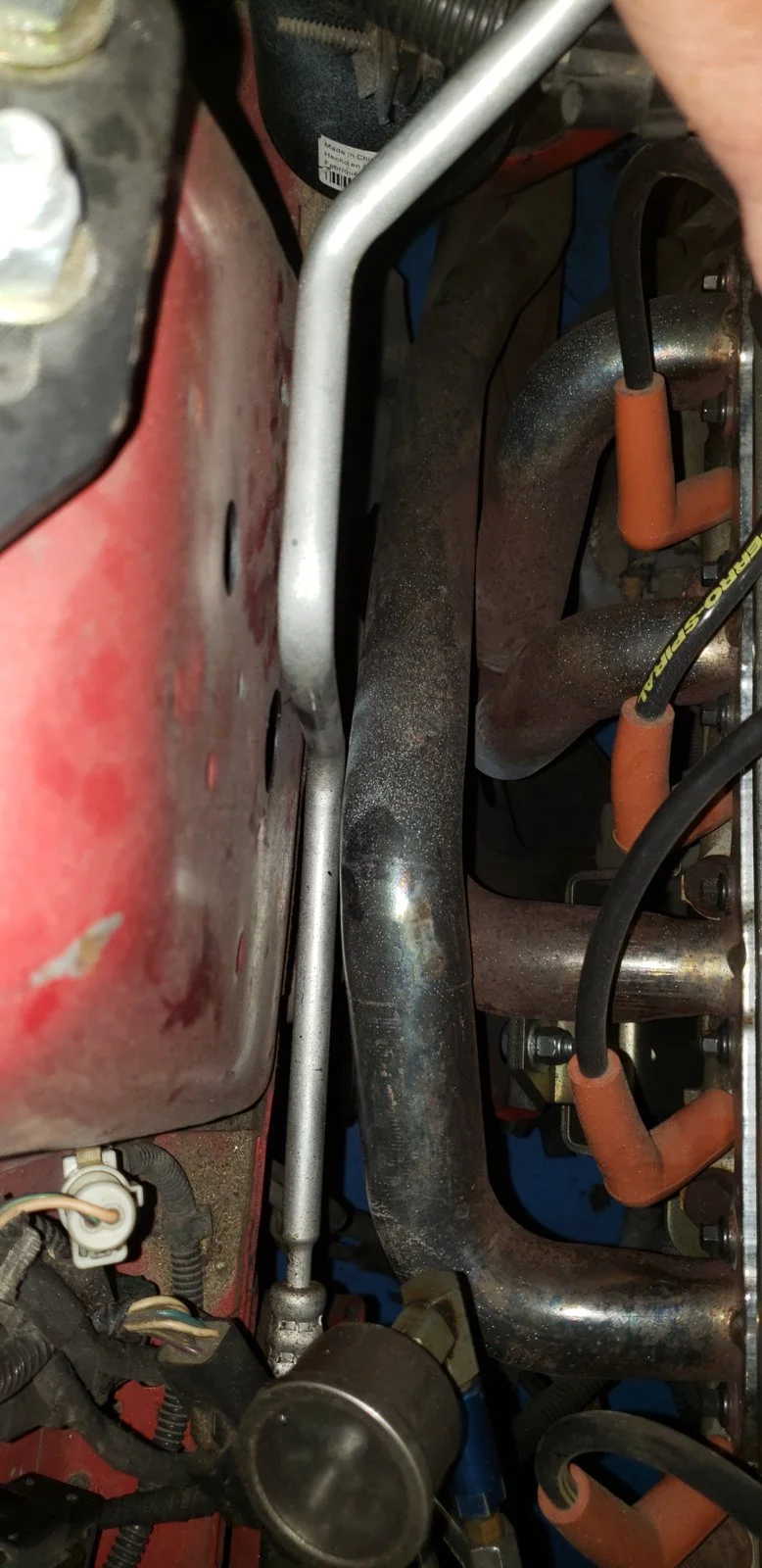

In the third pic at the S in the tube is where I bet the leak will be, I see a discoloration on the pipe and it looks like aluminum colored spray pattern on the header tube in that same place.I
The factory has a insulating cover there on the ac pipe.

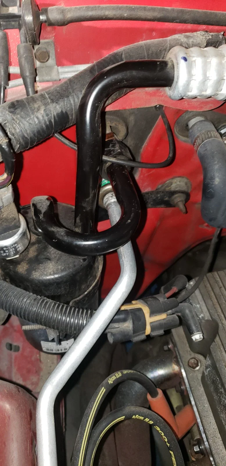

Found the AC leak. Using some bubble juice it turned out to be the pressure sensor on the dryer. It held pressure and is now holding vacuum. Plan is to swap the dryer and vac it again then charge the system.
