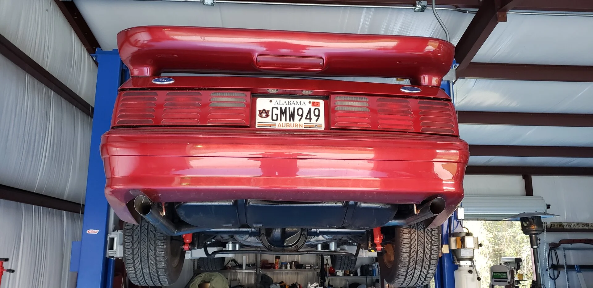

I would think you could have just slotted the inlet with a sawzall and use the good clamps and forgone the welding.
This way when the tailpipes rattle and hit things you can adjust them.

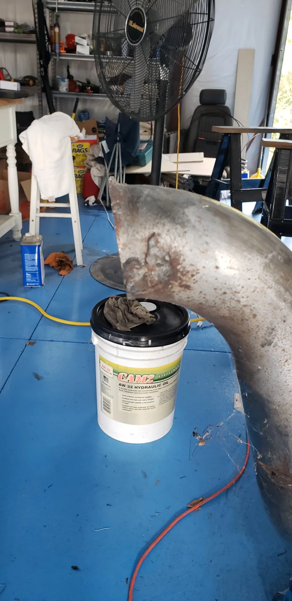

There was nothing to slot. The part that goes over the axel was welded straight to the muffler at the bend. I added 1" of pipe to get it to the point that it will not hit anything, hopefully. I plan to replace all of this in the future. The old setup had the upper control arms all bent and cut up to clearance the exhaust. Maybe there was a better way but hopefully this will work for now.

Well both exhaust tail pipes are in. Again not pretty but it'll do for now. Plan is to replace with new ASAP. The angles are all wrong. They hit the control arms even with the arms all mangled. My fingers are crossed that this will get by for a bit. I don't like smelling that much exhaust while driving around.

I came in the house after "Operation Bugger Weld" and my wife told me I had to take a bath and wasn't allowed to touch anything in the house.

I took the car out yesterday for a short ride. There were no rattles or sounds of anything hitting due to the exhaust. Thats a win for now.

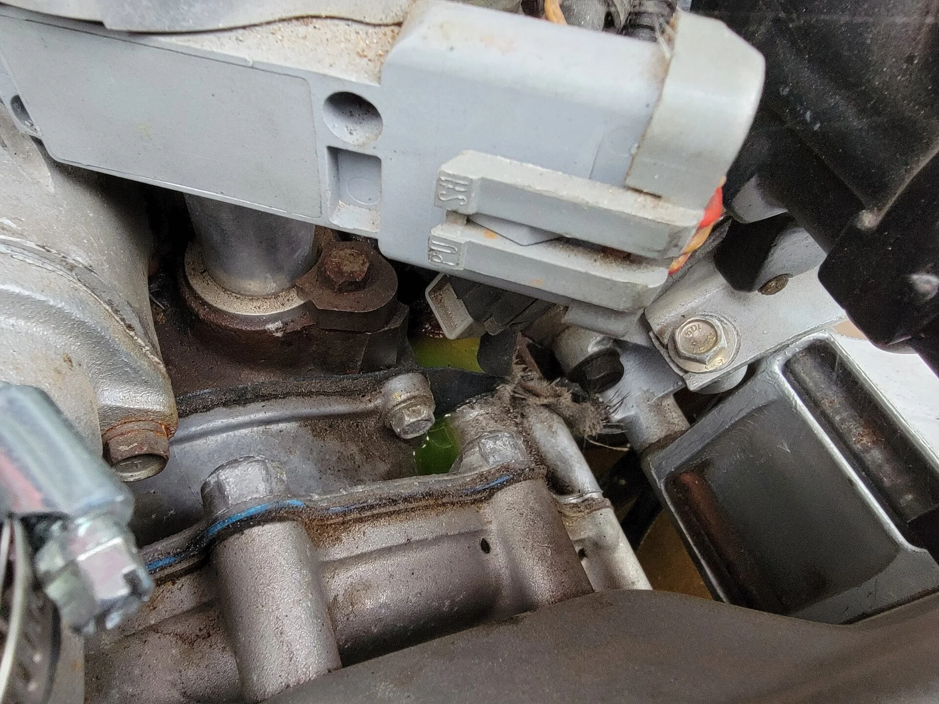

No fun car stuff has been happening around my house for the past few month. Haven't lost interest. Just a time money thing. I drove the car back and forth to work for a about a week a couple of months ago because my truck was getting some body work done. Since then it has been parked outside the shop. My wife got the garage cleaned up over the weekend so that I could park it in the garage along with her car. I went to start the mustang to move it. It was dead. I guess I've got a slow draw on the system that pulls the battery down over time. Not really a big deal. I popped the hood to put the charger on it. This is what I'm greeted with.
Anyone that has paid any attention to this rambling thread knows that the timing chain cover has been a thorn in my side for quite some time. I thought I had this issue beat several months ago. I had not had any trouble with it until now. I haven't even checked to see if any of the bolts are loose. They shouldn't be. Nor have I checked for coolant in the oil. This wont get fixed anytime soon, but it will get fixed.
I really hate having to take everything off of the front of the motor AGAIN. I'd love to just pull the motor and have it gone through or built, but I really dont have the money for that at the moment. It smokes pretty good. I do plan to do a compression test on it soon. I'm surprised I haven't done that already.

Is there coolant pooled on both right and left sides of the timing cover? I had similar issue, and my problem was the thermostat housing and gasket. Those are pretty cheap and easy, it would be easy to rule out as your problem.

@pats91 I didn't look at the other side. The thermostat, its housing, and the gasket are all new and they have not been the issue up to this point. Doesn't mean that it isn't now, so I'll give it a look. I've replaced timing chain cover gaskets on several other Winsor Fords and this is the first time one has handed me my ass.

The lizard blood is only on the one side. I'll get after it sometime soon. At least it is resting comfortably in the garage now.
