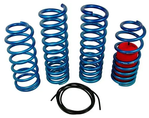

While I never used them in my 2004 SVT Cobra (IRS rear), I know some of the Cobra guys tried using cheap do-it-yourself airbags in the rear to help alleviate the wheel hop:
attachment.php
