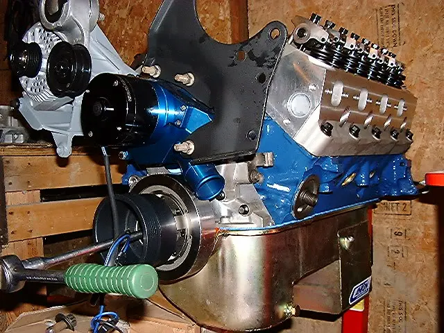

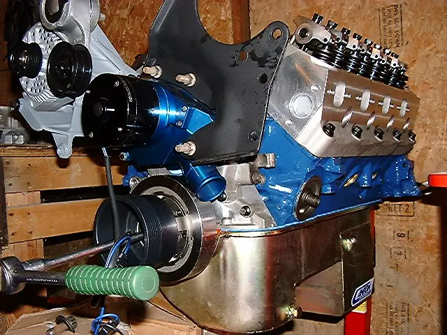

here are some pics of my canton and one from their website. mine is showing the plug for the front sump, and the spot for the dipstick. the rear sump plug, not shown in pic, is on the backside of the pan right behind that canton sticker. the canton pic shows all three.

well, I have a milodon 7 qt and it has a small leak problem. I found mind to be around the dipstick. Do you KNOW its from the thread? For mine, its coming from around the dipstick yes, but specifically through the weld. I can see its TIG welded, and it just wasnt perfect around the dipstick protrusion, thus i have a pinhole leak there.

If it's not a dipstick hole, it may very well be a provision in the pan for tapping in an oil line to a supercharger or turbo.
In either case, unscrew it and check that there's a gasket around the bolt. If yes, put a little (not much) teflon tape on the threads. It should help with the leaking.
If you are not using the Canton Dipstick with their pan you are not getting an accurate oil level reading. Once you install the Canton dip stick, you need to add 6qts to the motor, and re-mark the dipstick to the proper level.
The plug you are refering to is for the dipstick like pictured in Jerrys pic. it shoudl have teflon sealant on the threads.
