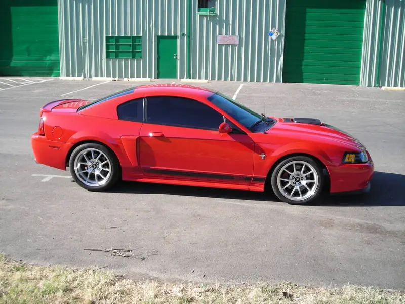

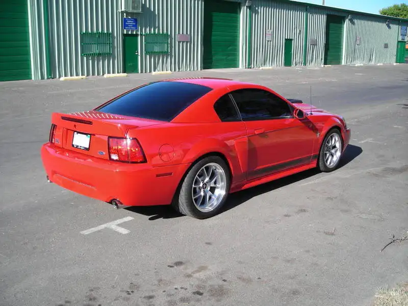

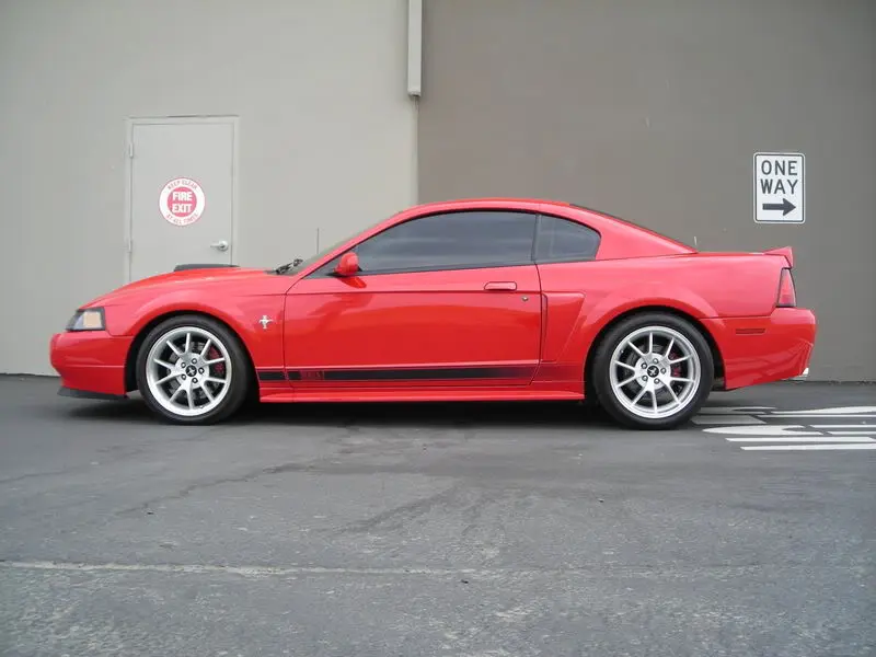

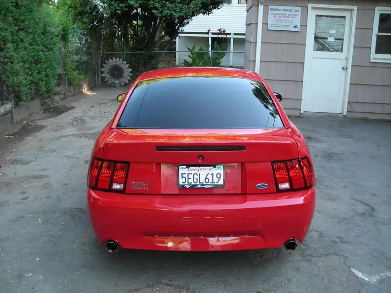

Mine is 15% all the way round BTW....Here are some pics...
