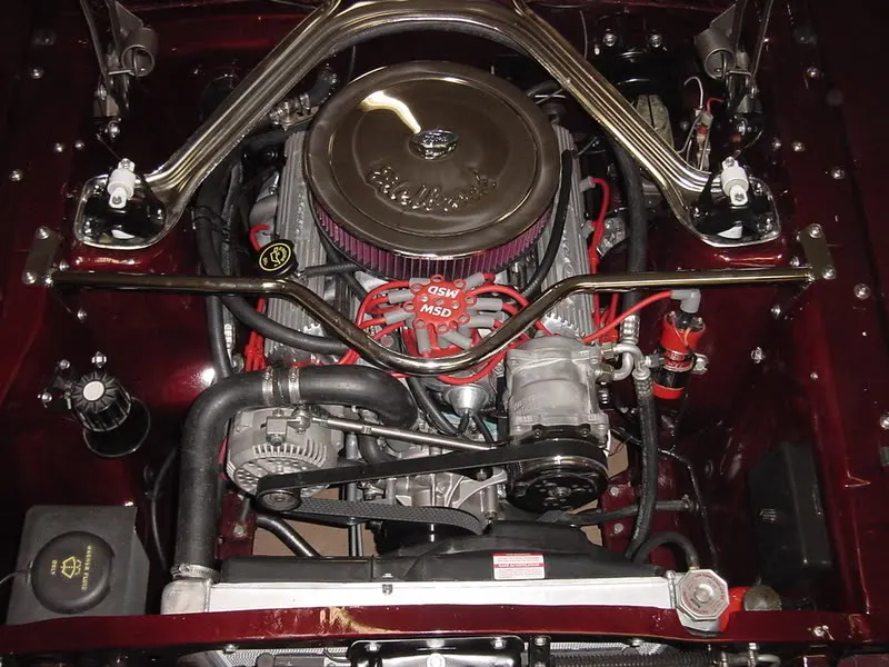

14x3 High Flow Summit Filter, Edelbrock Air Cleaner, MSD Distributor.

That sure is a clean engine compartment. Whats the box on the driverside? I'm looking for some type of box like that to conceal my headlight relays and maybe a couple other things. Is it called a "bud box"? My Dad said people used to call them that.
