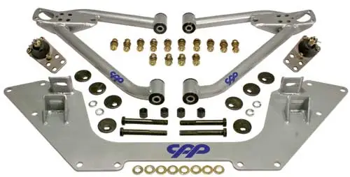

what is everyone's thoughts on teh new CPP suspension kit? we were discussing it in the AJE thread but i thought it deserved it's own thread and was getting way off topic on the AJE thread. here's a couple pics for those that haven't seen it yet.

I agree on the plastic bushings, but it looks good other than that....and I do think I'd rather have open tracker lower arms and strut rods...but this setup really isnt all that bad, and looks good for an economical solution
what do you have aginast Delrin? i'd rather have Delrin than rubber and those Maier strut rod bushing kits are also made of Delrin BTW as are the bushings in the GW UCA's and their rear bushing kit as well.
as far as the 1/4" plate adding weight, i can't see that it would too much more than the stock strut rod braces which are pretty substantial themselves.
this kit HAS to have less caster deflection than a stock rubber bushing or most any type of stock style strut rod, even the heim jointed ones. i'd also say there would have to be some geometry change but excactly what i can't say.
the only thing i would like to see different would to have a cross brace welded in between the 2 sides of the arm, provided there is room. they would definitely need to be modified to run a coilover that attaches to the LCA but it shouldn't be hard at all.

I could be wrong, but I don't think those are "Delrin" bushings. At least if it were me and they were Delrin, I would certainly make sure that was in the advertisment. And my personal experience with "plastic" bushings (I'm drawing a blank on the proper name) is that road grit becomes impregnated into the "plastic" and they wear the metal sleaves until there is slop. The same thing can happen with Delrin if the tolerances are too loose. In any case, as I stated in my original post I prefer Opentracker's stuff with Street-or-Track's strut rods. Both companies use heim joints, not bushings. Not sure where you came up with GW and Maier?... although, my Maier Panhard bar uses heim joints, as do my GW lower control arms... Hmmm.
I would agree that if they suggest cutting off the original strut rod braces, the additional weight of the plate wouldn't make a bit of difference. Although at that point I would seriously consider welding the plate, otherwise there is going to be spot weld failure of the inner fenders and radiator support along the front frame arms.

as far as the plate goes i don't really see any other way that it can be done other than removing the original strut rod braces from looking at the kit in the pic, anyway. basically i was just wondering what the aversion to the plastic (i'm still assuming Delrin) was. still assuming that it is Delrin it's way better than rubber and still a step above poly. the only other "plastic" bushing i can think of would be Midolyne and it's a thermoplastic much like poly but has more give and less of a problem with squeaks, i have that on the rear leaf spring bushings in my car and so far i like them just fine, but they haven't been on the car long to start deteriorating yet.
