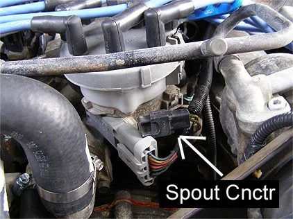

Just to be certain this is what you are looking for and what’re you should be looking with regards to the spout connector:
All 87-93 5.0 Mustangs came with one.

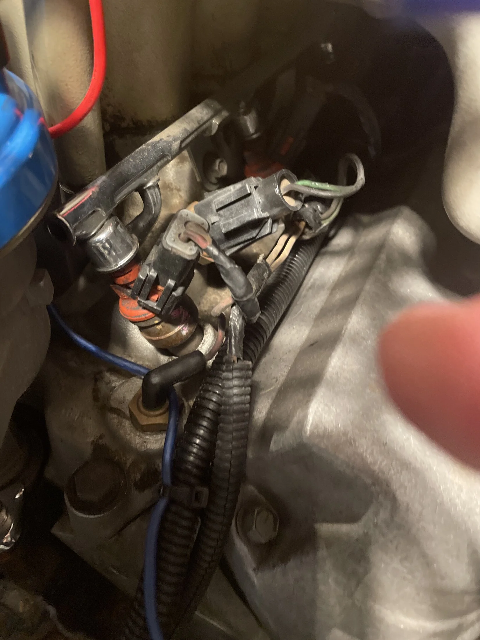

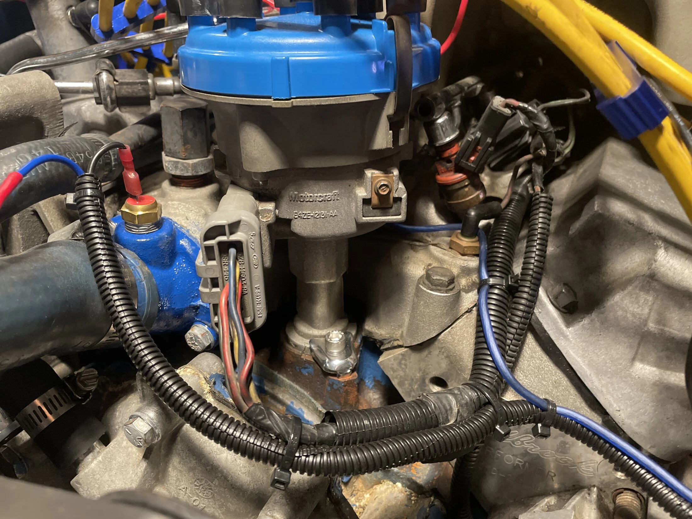

Yes sir, I’ve been watching YouTube vid’s about setting the timing process and my neighbor couldn’t find it either. We looked diligently on both sides of the intake and only find injector connectors, manifold sensor (possibly temp or vacuum). Engine was professionally built in Colorado, is it possible they used a spout delete with regard to timing advance. I wish there was someone around here (Paris, TX) that I trusted enough to look at this car.

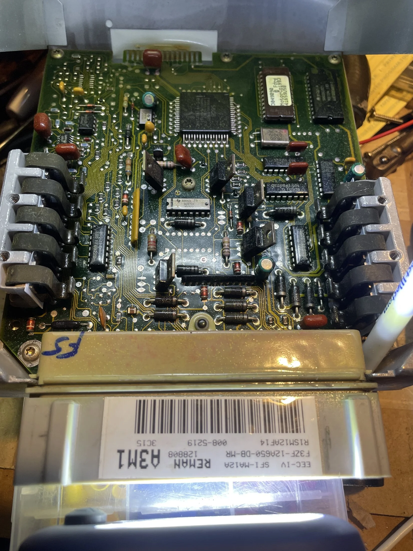

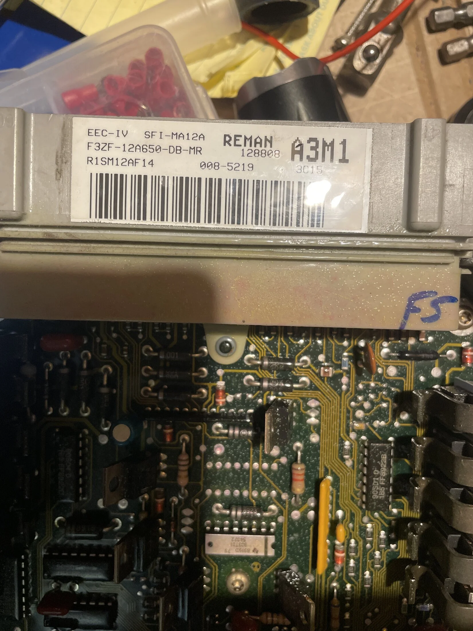

Here’s what I found. I don’t believe there’s an EPROM in there, I don’t see a socket for it and it looks like it’s a remanufactured CPU itself.

To tune an EEC-IV the connection point is on the opposite end of the 60 pin connector. You have to “scrap” off the coating that is covering the “fingers” so the chip or connector can make contact.
There was a sticker over the connector that said warranty void if removed, so I was afraid to do that.
