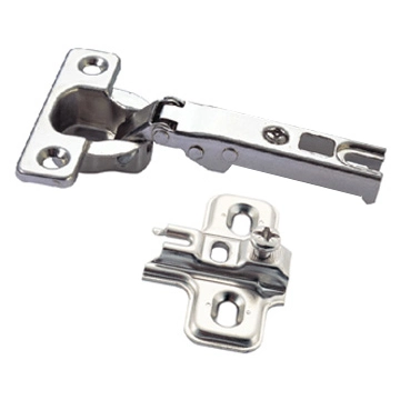

wouldnt it be possable with hinges mounted in the front, instead of bolting directly to the hood, have them bolted to solid bars
then have tubes on the actual hood to match the bars, so all you have to do is slide the entire hood off if you wanna work on the engine.
something like a door hinge or something to that effect.
would just need a locking pin of some sort near the windshield end to lock in in place
plus with a fiberglass hood it should be more than light enough to lift off by yourself
kind of like this, one piece bolts to the car, the other to the hood, hood slides onto the rail, and locks down near the windshield.
