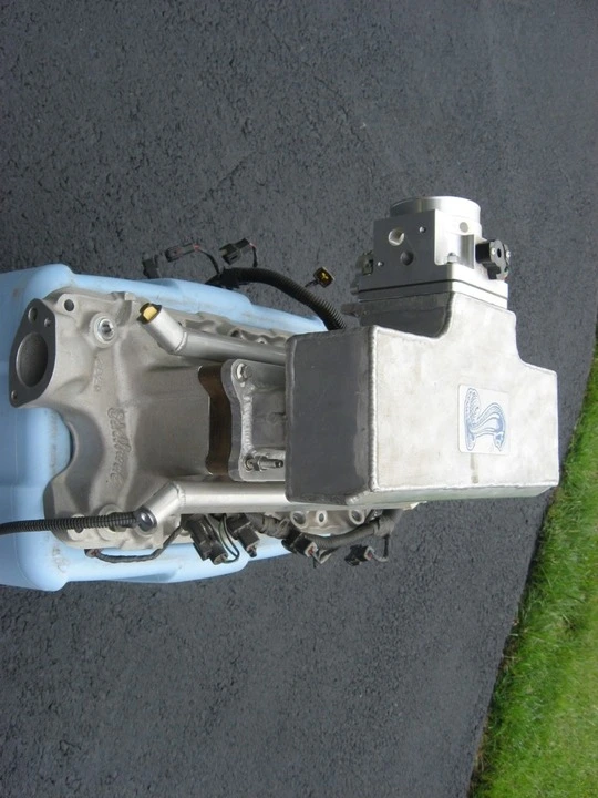

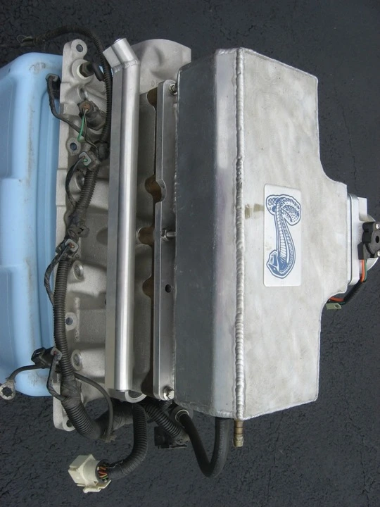

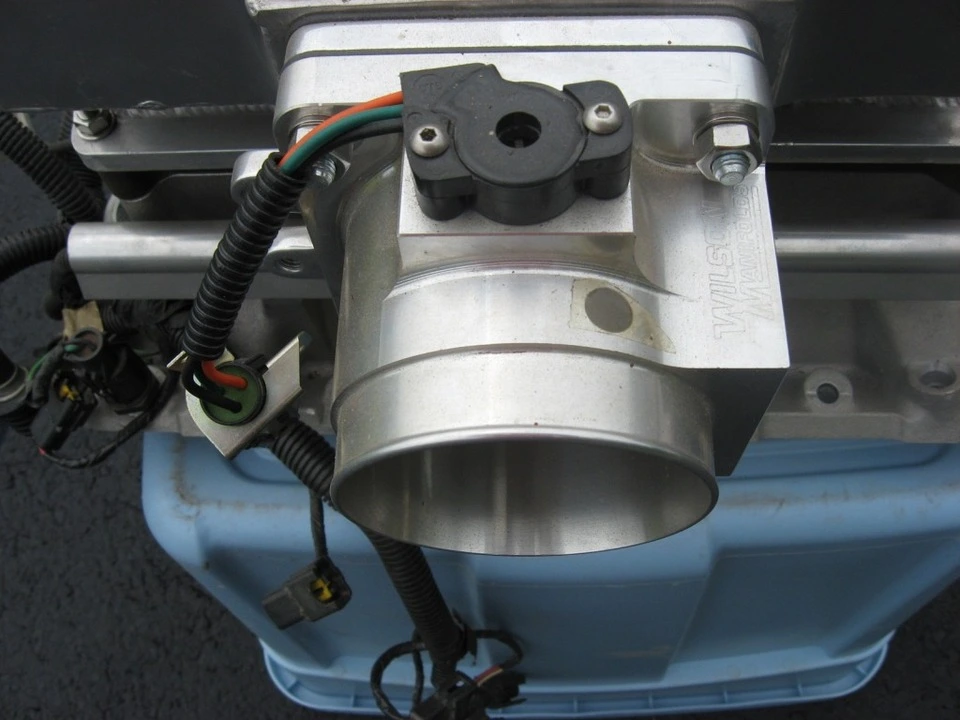

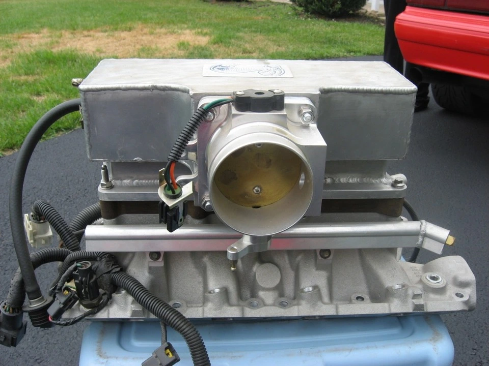

got offered this intake for my 200mph saleen gauges
think im going to pass on this offer but i may take him up on the offer for a set of 99 cobra 95 cobra r or 2000 cobra R wheels and sell those to buy the nitrous kit
NIKwoaC
中國製造
Oct 31, 2006
5,525
943
214
Chengdu Province
Jun 14, 2012
#107
  • Jun 14, 2012
  • #107
Home fabbed box? Those can sometimes be very hack. It might be nicely fabricated but the airflow characteristics could be seriously hosed. I would have passed on it too.
RacEoHolic330
I like to dress like a pretty girl
Mar 4, 2003
4,014
1,698
203
Allentown, PA
Jun 14, 2012
#108
  • Jun 14, 2012
  • #108
I agree. Unless there are CFM ratings for that intake, I wouldn't touch it.
srtthis
Jul 3, 2009
5,129
1,666
204
Maryland
Jun 14, 2012
#109
  • Jun 14, 2012
  • #109
in the email he said it flows 300CFM the lower was ported by panhandle performance. 1" tapered spacer and a 80MM wilson throttle body.
but i def got the itch to go bang some gears....

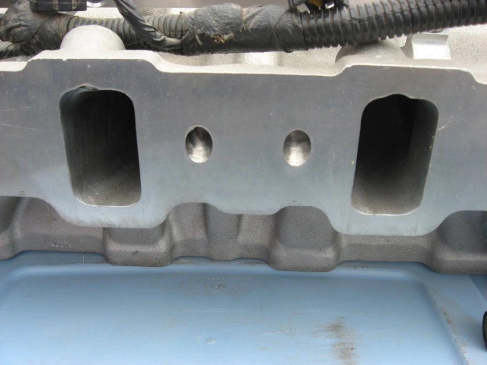

Finally finished porting the gt40 lower... More so cleaned up the parting lines and cast finish in the runners. And removed the 2 bumps for the screws

Hey before you bolt that on, drill and tap the Air Intake Sensor into the runner, the A9L processor really likes the sensor in the intake runner.

you think its better off there then in the main runner of the upper where i have it now??

Yes

ok i will see if i can find a plug for the upper tonight and tap the lower.

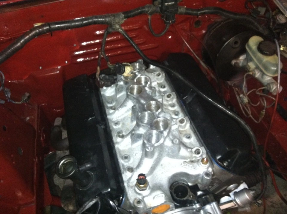

My dumb ass forgot the in dip stick
