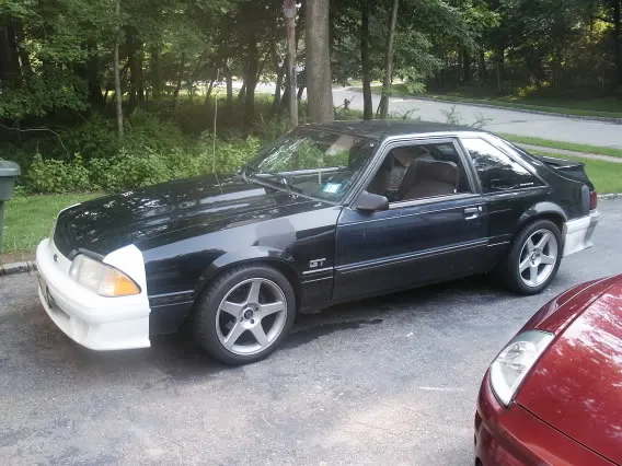

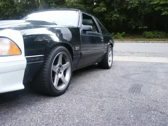

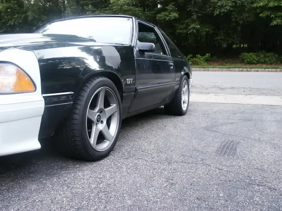

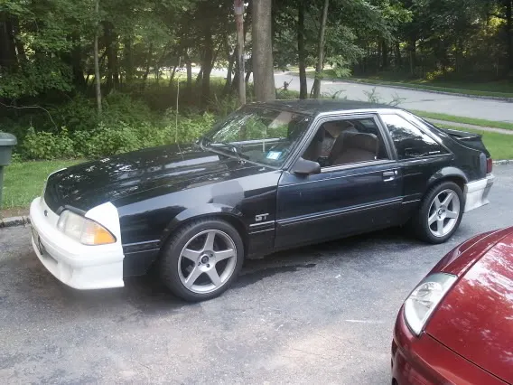

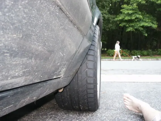

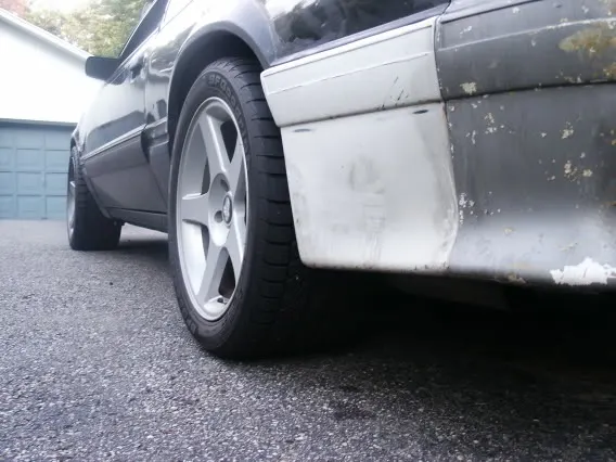

I have 255/40's up front and 275/40s in the back. Sorry for my car looking like crap but you get the point.
