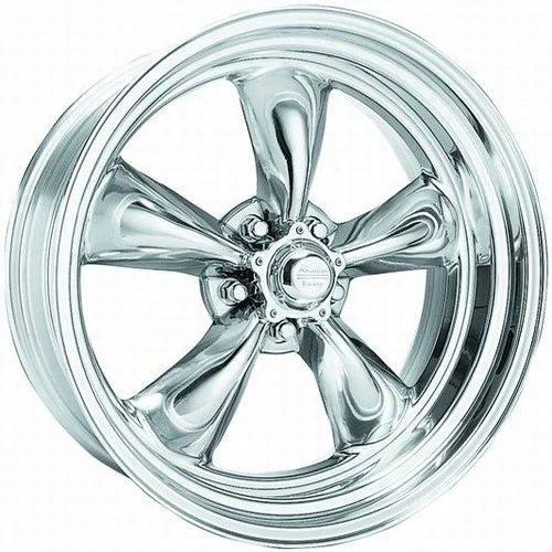

EDIT - LuS1fer I checked out those American Racing Torq thrust II - sick. They only come in 17'' but I've always wanted a lil more rubber and less wheel. Was planning on the 17x9.5. They are listed as polished (they aren't chrome) but how can they be as shiny as chrome?
