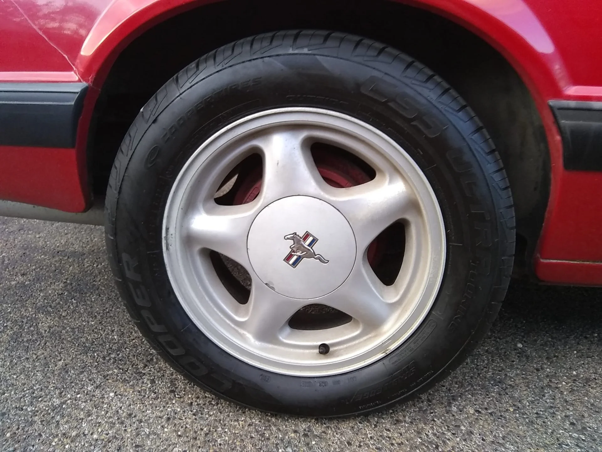

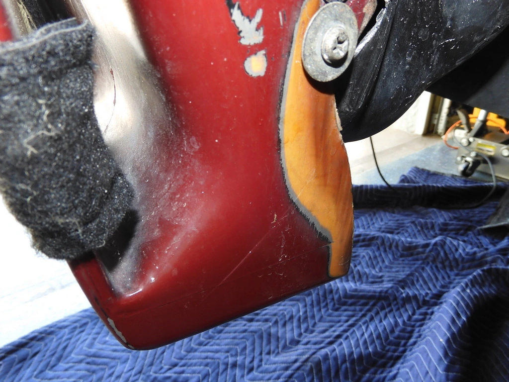

This is where mine rubbed with OEM wheels & tires, 225-60x15.
The OEM wheels are now spares with 225-50x15.
For 16" wheels, I changed to 245-45x16. When that size was no longer available, I used 225-50x16.
I now have 17" wheels with 245-40x17.

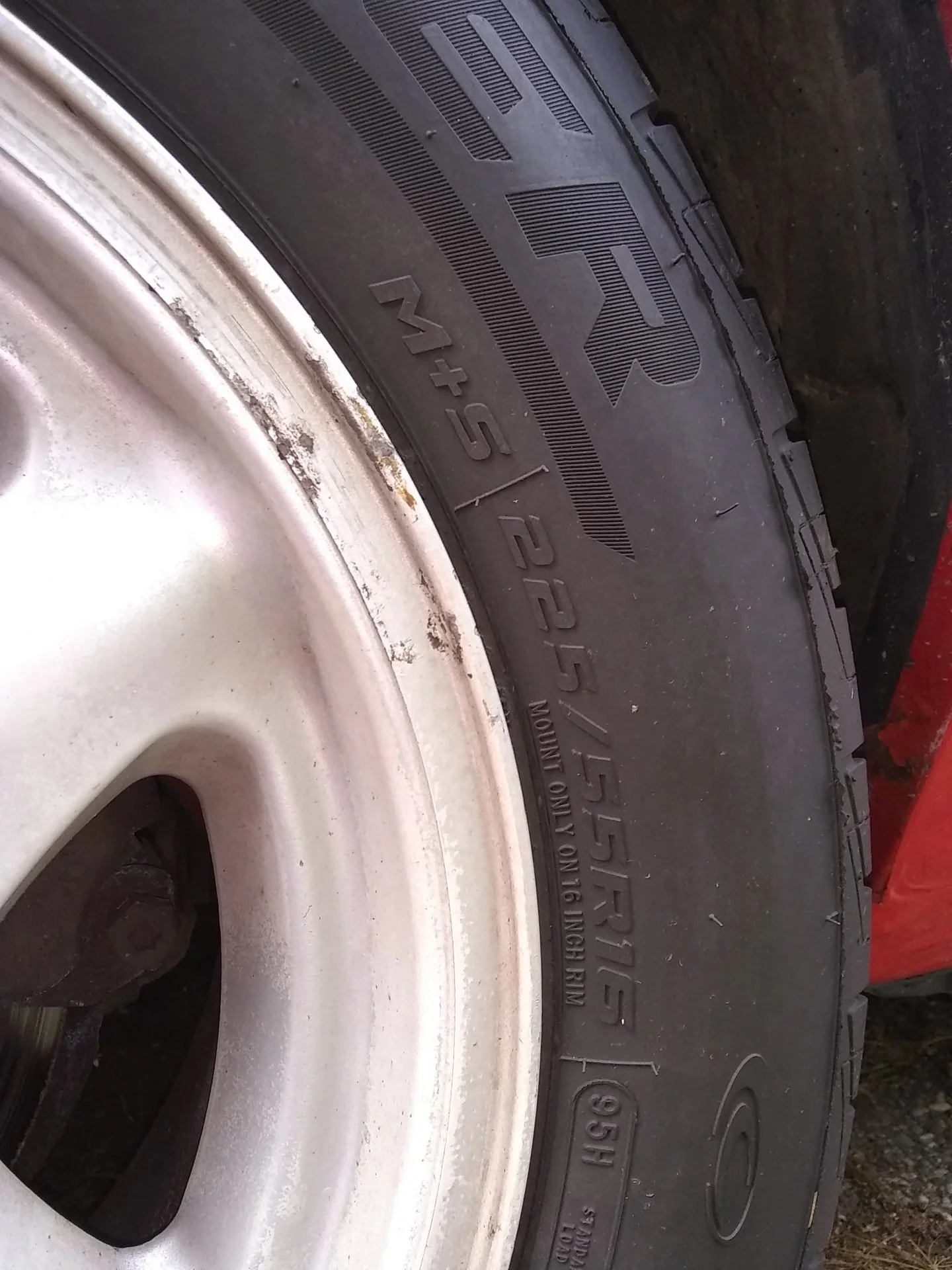

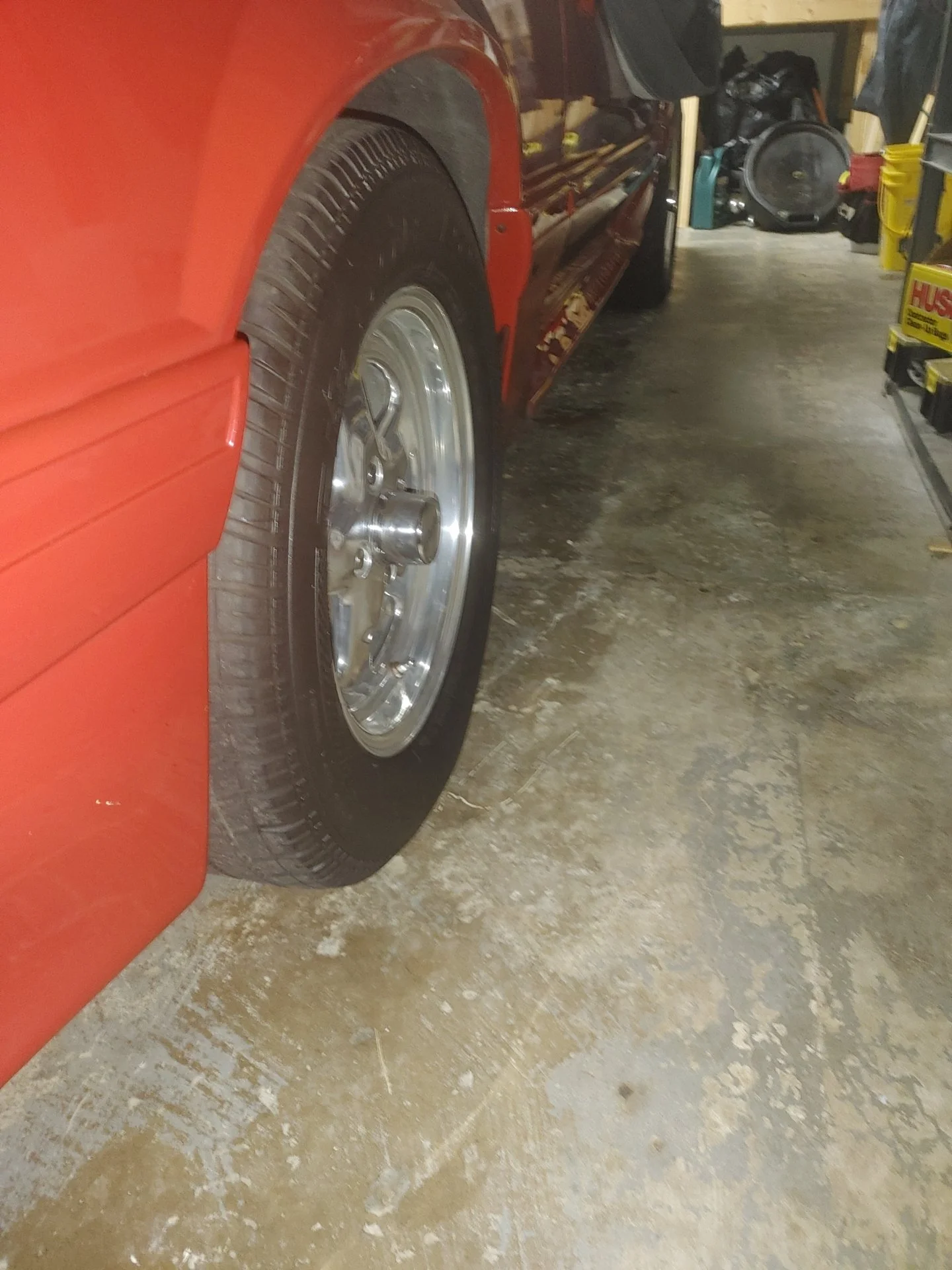

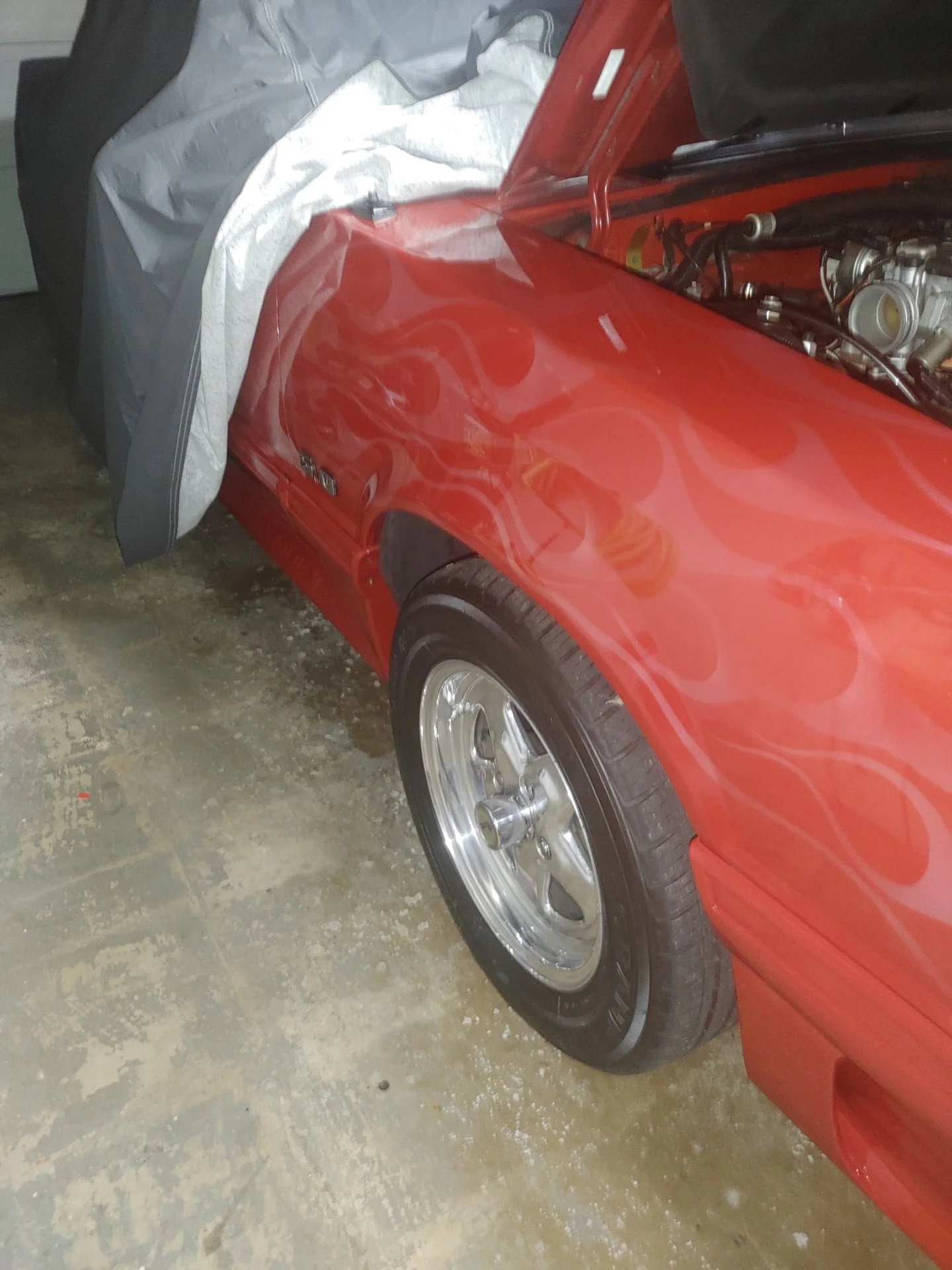

I try to keep Indian Outlaw as stock as I can. That said I'm running 225/55R16
Now, as mentioned above, I do get a tiny lit bit of rub, hardly worth mentioning on the fender extensions, but that's only because I have the old/longer extensions. Had my donor car been a 90+ instead of an 87, everything would be groovy. So, if you're trying to put pony wheels on something made before pony wheels came out, you may want to swap fenders to, or be prepared to make cuts.
Wait, I feel like a muddied the water.... Outlaw is actually a 91 LX which should take the short extentions. But, some uninsured a-hole turned left in front of me, and the only donor car I could find in my price range was an 87GT - long extensions. to make the nose swap look right, I had to use the 87's extensions because the GT extenstion has the fake air duct which continues into the rest of the nose, and the LX one is round and smooth. Also, one of mine was broken in the crash.

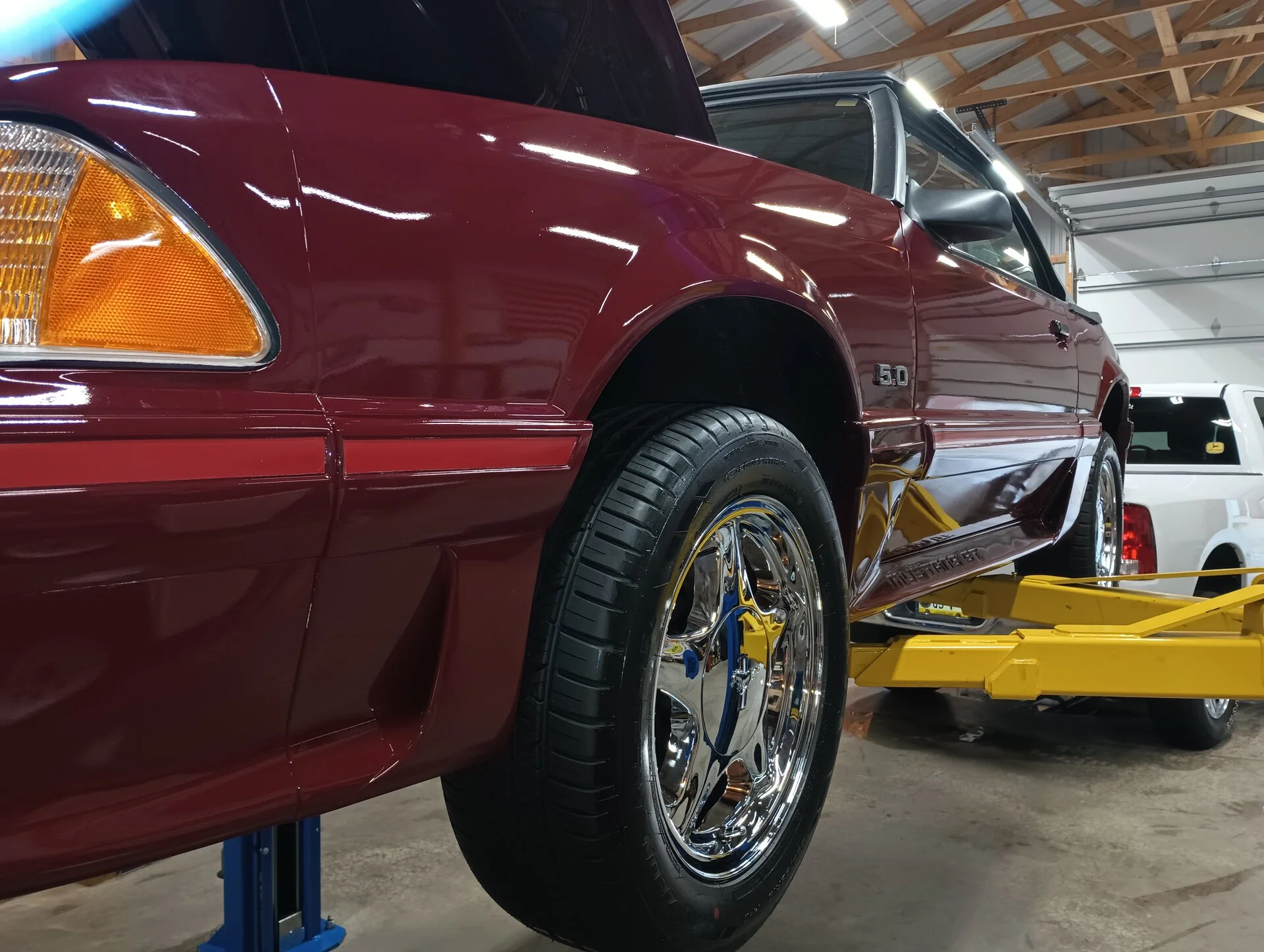

Yes I actually did get them installed after having them a year and a half probably while I was working on other items.
They look great! No tire rubbing that I can tell so far. I also got the 86 taillights installed recently also. I will try to post some pics when I get a chance, but I'm extremely happy. They really look good against the medium cabernet paint.

I appreciate the quick response. Also what is ur tire size? And did u get them from lmr cuz I know lmr set xomes with 225/55/16 and one thread I read said they may rub might have to go with a 25/50/16 because of smaller fender opening tyats also why I was asking u. Well I finally see pic in a thread with the difference in fenders from 87-90 and 91 to 93. In case u didnt know its just the front ground effect piece in front of front tire is a little smaller on 91-93 by like an 1 1/2. One more question or if u could send a pic. I was wondering how wheels looked with fenders are the close to being flush like everyone loves or sunk in cuz their 16x7 and need spacers to push them out. Again I appreciate all the info u ate providing cuz this is gonna be a big purchase for me and it just wanna make sure its right the first time. Heres my set up now they are only 15s

Yes purchased from LMR with the better cooper tires installed and balanced. It was like Christmas morning when they showed up, individually boxes and carefully packed. No damage.
The center caps are officially licensed Ford items too and look great
They really transformed the look of the car from the tired old turbine wheels. Between the chrome ponys,. Getting better side ground effects (not warped), installing the 1986 taillights, and replacing the trunk lid to get rid of the ugly luggage rack (my opinion), the car finally looks the way I want it too. I'm very happy with it now.

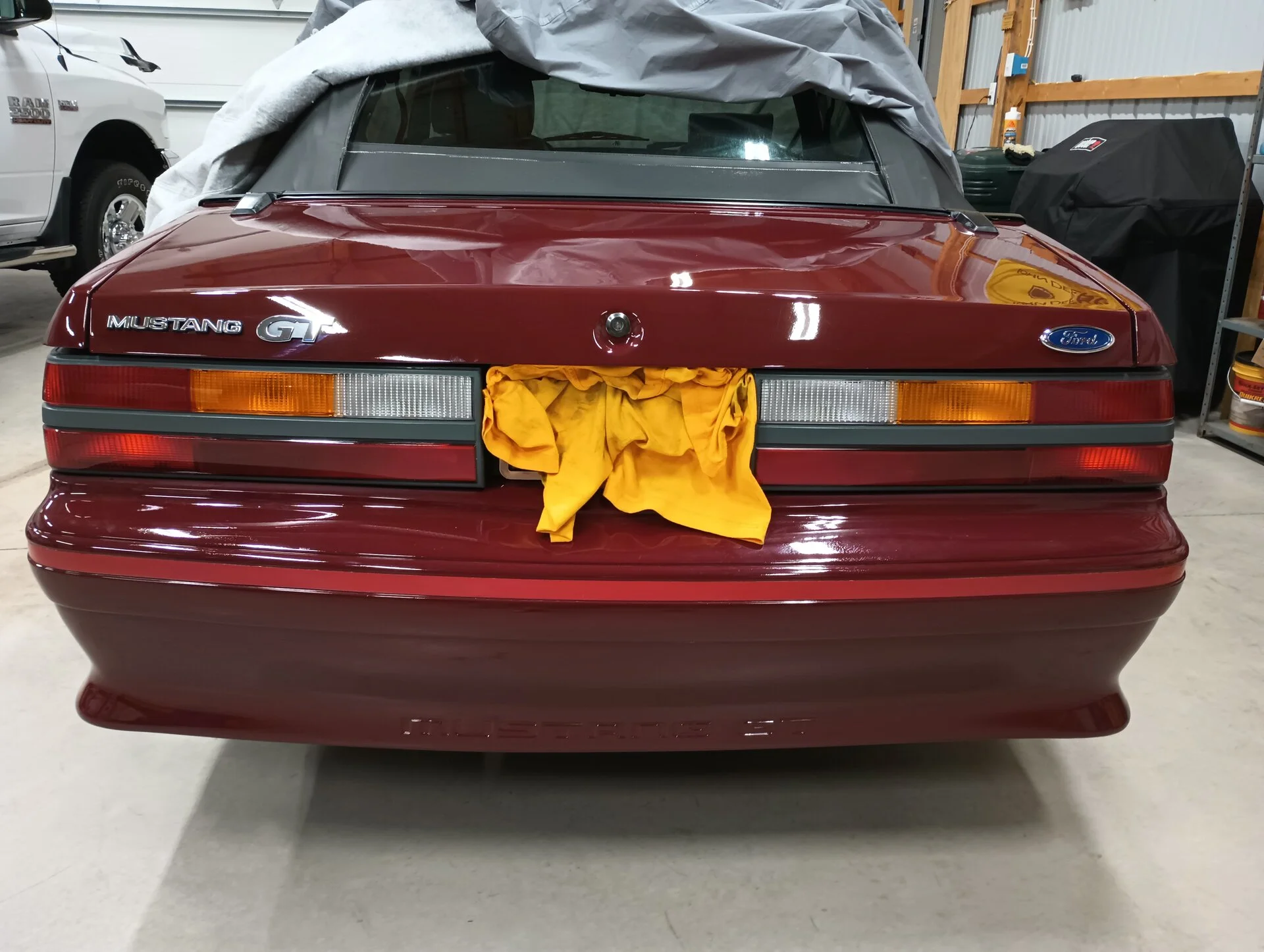

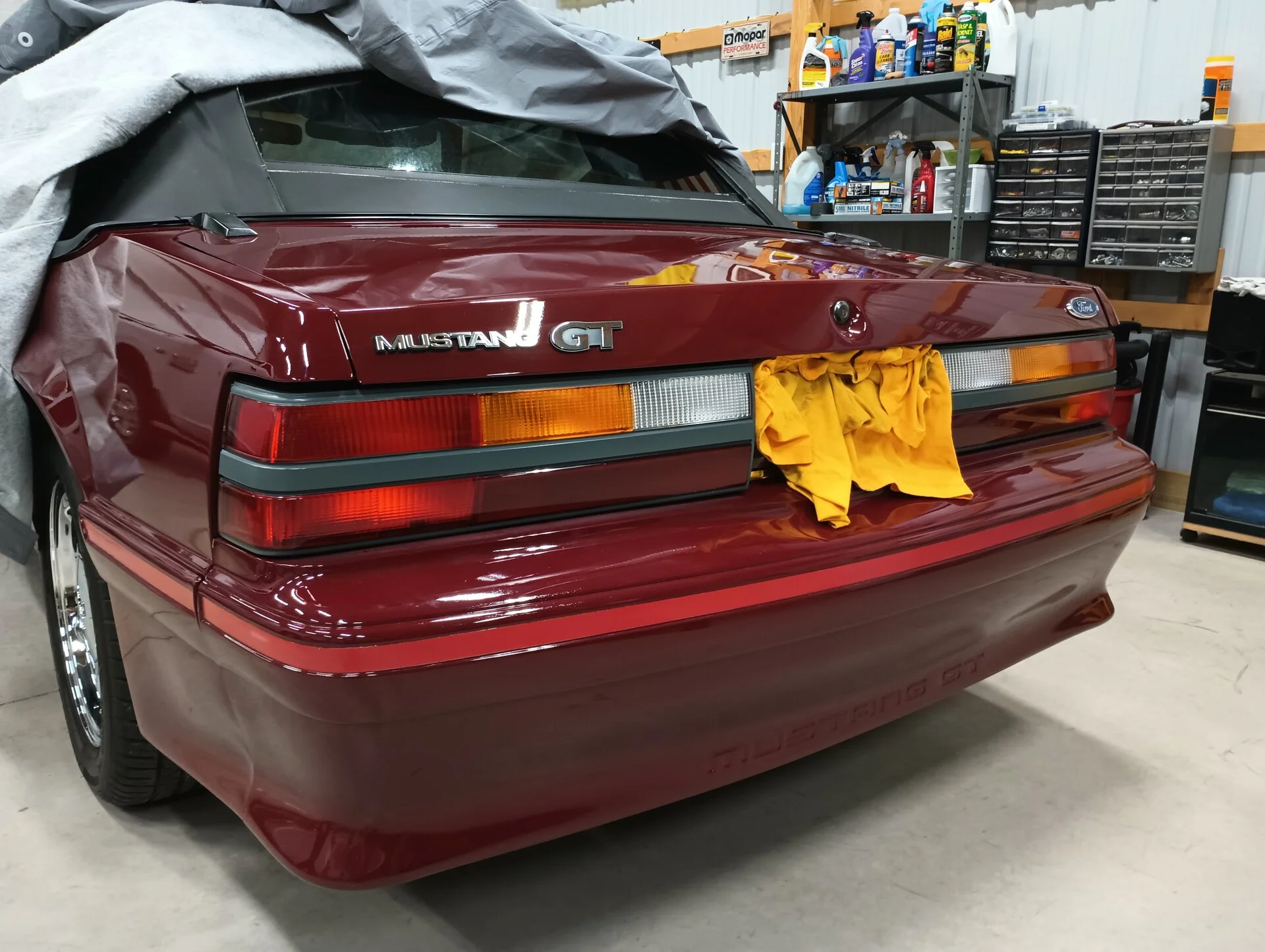

As promised.... Some pics

sweet Stang, nice color, my buddy had an 87 GT 5.0 with T-Tops loaded with all options it was an Automatic and was that exact color too. going to see if I can find a pic.
