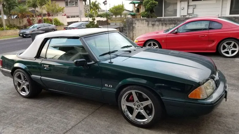

Here you go... 93 Coupe, MM front arms, 95 spindle, 17x9 Cobra wheel (6.02 BS / 26mm offset). 245/45 in the front and 275's in the back. No rubbing on mine.
Not the best picture, but you can see them.

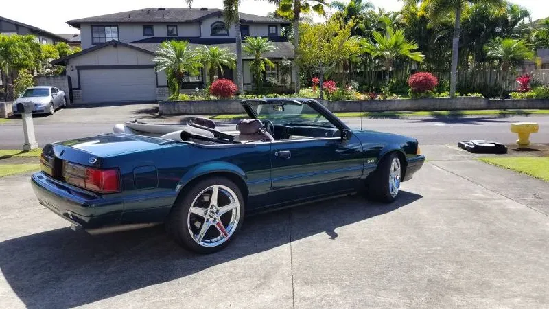

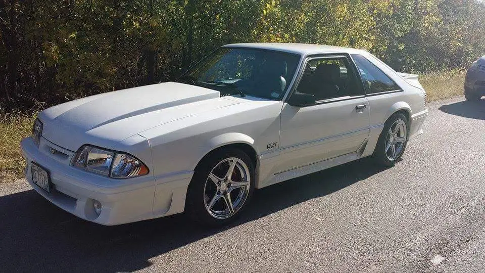

My 89 with b springs, 17x9 245/45. Slight rub at full lock on the front by skirt, an lx would be fine, and a rack limiter would stop it as well.

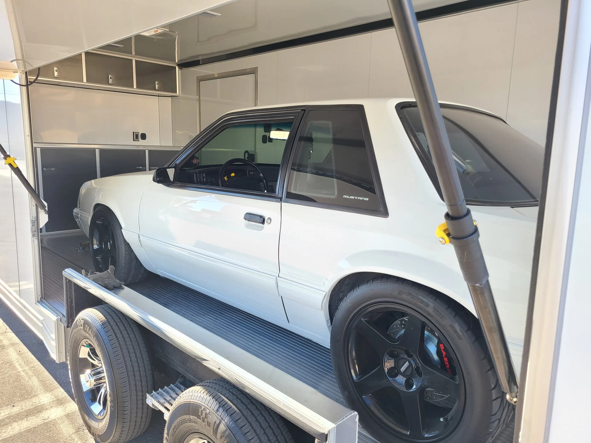

I have 2 1990 foxbodies. This one has 18x9s with 245s up front and 275s in back with no rubbing. Similar setup to yours. 94/95 front spindles, fox length rear 5 lug axles etc. I had 17 inch cobra R rims on this car before with 245 in fron and 275 in back same deal, no rubbing.

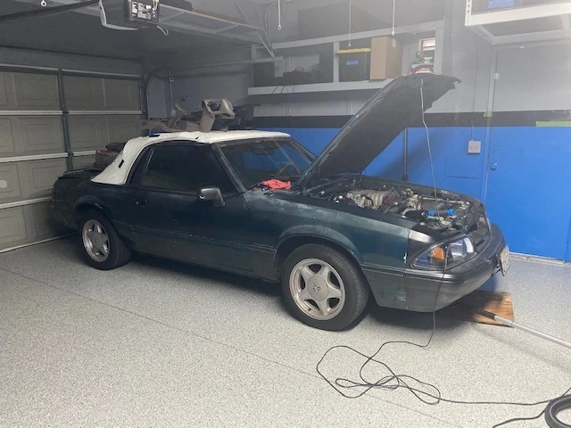

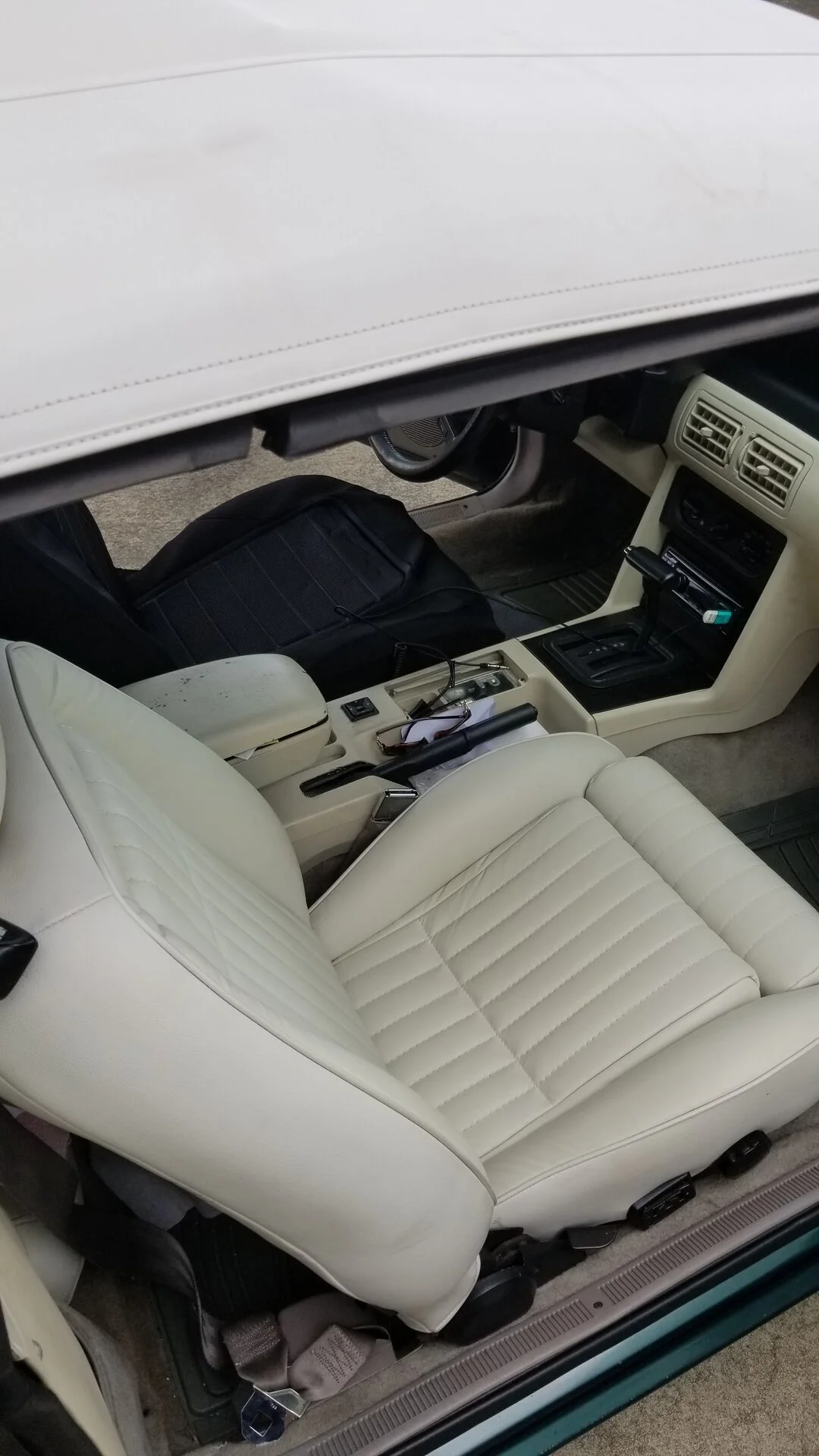

I have the same car but mine is not that nice! Can you take pics of he inside, plz.
DAMNNNNNNNNNNNNNNNNNNNNNNNNNNNNNN! Its clean!!! I have the same car but changing it to black interior!!!
The car is jacked up because a kid was driving it around. Wires are cut and parts missing. But I have restored them but missing the rear quarter panels.
