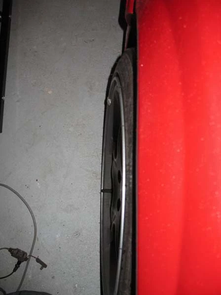

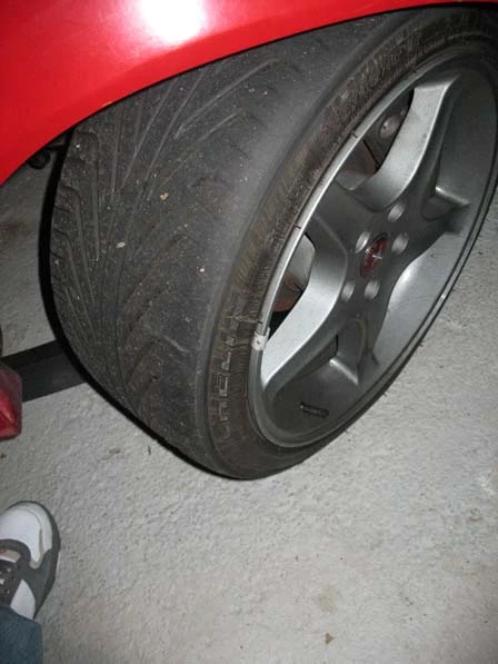

25th... you mean it stretches so it pulls the sidewall in? The 255s should have a 10.04 inch surface width instead of my 235s with a 9.25inch width, right? Do you have any pics with the tire turned?
Can a 275 tire without any modification? I don't want to flip the quads or cut off the tail pipes or whatever else.

Thanks man. Your car looks sick! The tire doesn't look that stretched but i understand what you mean. I'll post up a pic of my tire later.

Here are my pics.

Thanks, I run 285/35 out back, but have a 10" rim. A 275/35 should fit well on a 9" rim. My friend also runs 235s on his 18x9 and his look about the same as yours. I would say a 255 will look better than that, even with a little strecth!
