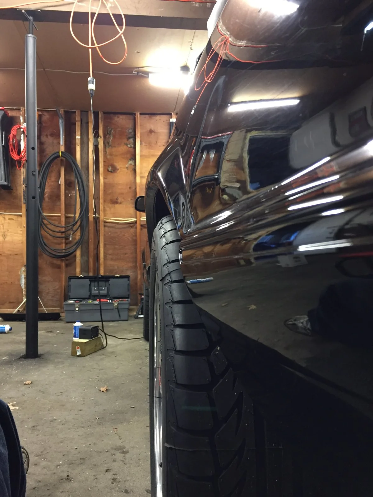

getting ready to get new tires, just making sure I get the right ones the first time. I have 17x8 bullet wheels . I have a 92 fox body. thinking of running a 245/50/17 in back and 225/50/17 in the front, and the car is lowered. check out my sig for a pic, will the 245/50s work in the back with it being lowered and not rub.
