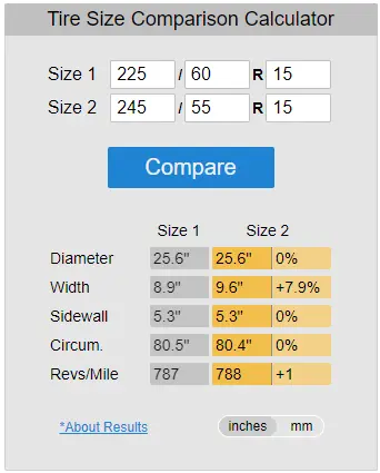

Very nice, simple calculator you found there:
According to this, the height is exactly the same. Perhaps it's just my speedo that is off. LoL

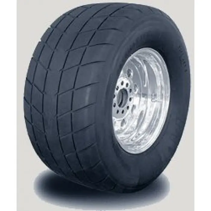

I just wanted to come back and add some tire pronz.
That's a 55 series tire. Now, I can only find them in D.O.T slicks. :notnice: I guess they figure everyone will just run skinnies up front :shrug:

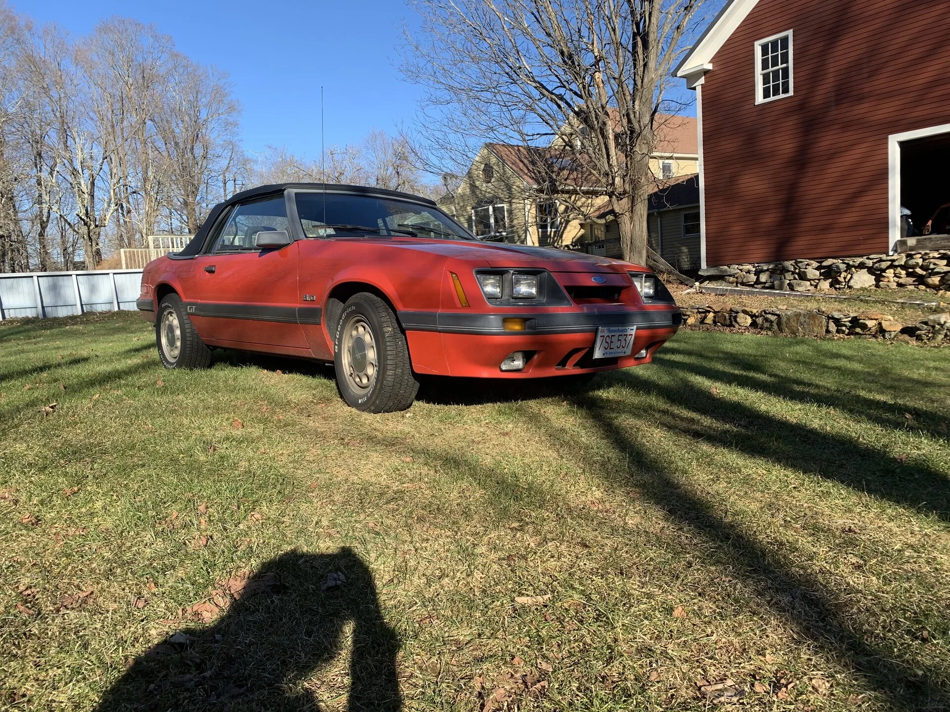

Those gatorback replicas are crazy money. I ended up just getting BF-Goodrich. I drove the car all summer with no issues so going with the stock size was definitely the best choice. They don’t look half bad either if I do say so myself.
