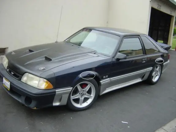

Well I finally got my rims and I dug up this old thread in search of fender rolling methods. I have 17x8 up front 235/45 and 17x9 in back 275/40 and all my tires rub if I hit a dip. The fronts rub if I corner too hard and brake. Check the pic, I circled the points of contact.

Here's how I fixed it, and I had severe rub:
1) Roll the rear fenders
2) Roll the front fenders (not much you can do there, but it helps)
3) Buy new shocks and struts. I bought KYB GR-2 and all my problems went away. I am running 245.45.17 all around, with BBK lowering springs (progressive rate). My car sits atleast 1.5" lower than stock, and the only time I get rub now is if all 4 of my friends are in the car and I hit a dip. Shocks and struts make a huge difference.

This may be hard to believe, but new shocks will help (at least they did for me). I have a 91 with 17X9's 245's front and 275's rear. Was rubbing real bad everywhere. Installed Bilsteins at all four corners and Maximum Motorsports CC plates. The car never rubs now and that's all I did. My stock shocks must have really been shot in the rear because the Bil's really firmed up the rear of my car. Now when I hit large bumps the body of my car doesn't dramtically come down onto the tires like before. I think if you have really worn out, old shocks/struts it lets the car's suspension travel to much and induces rubbing. I forgot to metion that I have H&R SS springs. 1.25 drop front about 1 inch rear
Wow, this has been a while :0 No, I never did finish the article that I was working on regarding tire fitment.
In a nutshell - 275s on the front can rub at certain times almost no matter what you do, short of rolling fenders. Do these few things and it will help:
- New shocks/struts (mentioned above). This helps SO MUCH, I went with standard tokicos on the front.
- Caster/Camber. Get that camber adjusted correctly - more of a race alignment will help, as it tips the tops of the tires in slightly inside the fender.
- Use 94-95 spindles, not 96+, which stick out more.
- Front and rear wheel selection. In my case, the 10th anniversary wheels work perfect when keeping the stock length axles. The backspacing is 6.12...if they were 5.95, they would hit, for sure. I didnt even roll the rear and mine never hits in the back...I have a lighter coupe as well.
- ride height on one corner of the car creates the opposite effect on the opposite corner. If your a little low in the front, using adjustable rear control arms the change the height of the rear slightly can help.
Hope that helps.
