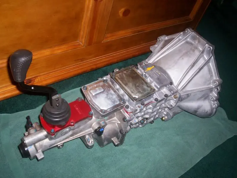

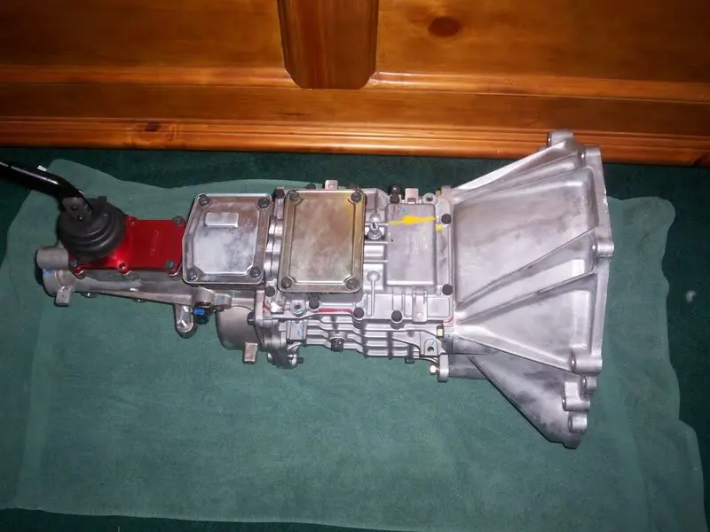

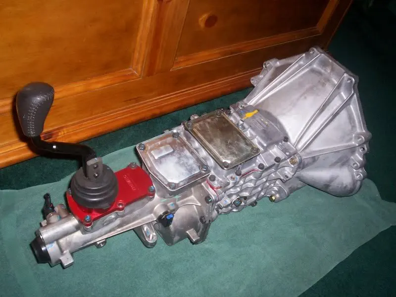

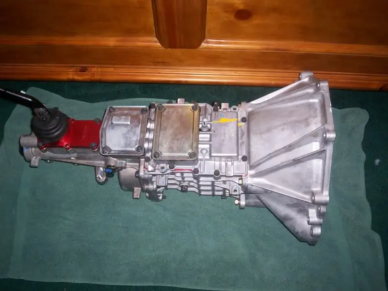

this is my tko500 the 600 looks the same.
