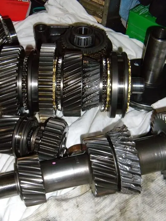

Here's some info on various TKO catastrophies. Keep in mind that the X2C V1.0 is the same tranny as the MMR900:
pdp 93GT said:
I have an X2C Motorsports V1.0 TKO from January 2003. I am the fourth owner of this transmission and broke some of the teeth off of the third gear cluster a few nights ago. I tried contacting Modular Mustang Racing but all they want to do is sell me a new one. I am thinking about shipping it to Liberty Transmissions for a rebuild and would like for it to be rebuilt with the same 700HP rating as before..
only306 said:
Please HELP!!! For three seasons I've been running a TKO 600 in my street/strip T-76 turbo mustang. The car weighs 3400#, 3.55 gears, 306cu and on a chassis dyno made 800hp 850tq. I've broke the TKO 5x now and I'm sick of fixing it. I want to put a somewhat bulletproof Turbo 400 and want some info about Bell housing, crank adapter, flexplate, driveshaft mods, crossmember, speedo cable mods, etc, etc.

FYI the TKO900 from MMR will not last. Mark Luton broke quite a few before getting it to do 8.9. The he broke a bunch afterward. Now he has an auto. TrentK (the owner of this site) has a tko900 and broke his at about the 700-800whp level. If you want reliability get an auto. Or find a way to make the Supra 6-speed fit. NOW THAT IS A BAD ASS MANUAL.
I have a point of contention about those supra getrag 6-speeds, though. They may be found behind 1000+ rwhp supras, but keep in mind that those cars are making that power at upwards of 8-9000 rpm. That means that they're making a lot less torque than the mustangs making the same power at 6-7000 rpm. That makes things a lot easier on the tranny.
Anyway, I hope this helps someone out there. Just because TKOs will not break in 98% of street built cars doesn't mean that it is a stronger design than the T56s out there. The two companies that have a great reputation are Rockland Standard Gear, and G-force. Going with the TKO will give you all the strength you need for now, and it will be cheaper. I personally wouldn't even bother paying the extra dough for the MMR900. They don't even have to weld the keys anymore. From what I gather, pretty much all they do is cryogenically treat them. It will not be stronger than one of these top of the line T-56s. If you want the best, bring your wallet. You're looking at more than $5k for the G-force and around $8k for the RSG Tranzilla.
