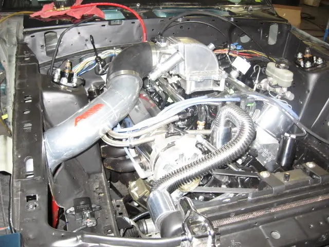

Hey Earl here is what you engine compartment looked like today.

67:
Thanks for the pic... It is fired, has the exhaust, and I will pick up on Thursday... Hopefully I will be on the road some time this weekend!!!!
n2ojunky what brand is your upper plemumn me likey likey and i need to get a new one.
