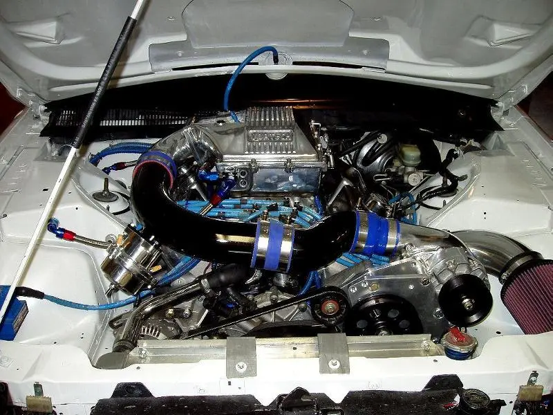

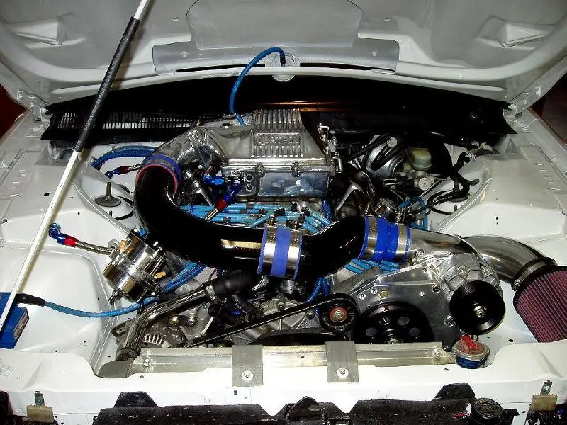

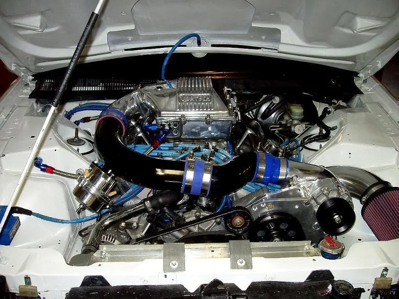

I have plans to switch to E85 this Winter. That has been my end plan for over a year now. I am running a Vortech YSi in a carbed blow through setup, and as soon as every thing is ready, will up the boost from 12 psi, to 20+. This could not be done with my setup, even if I was using race gas, but with the extra cooling effects of E85 when is atomizes in the carb, I will be able to run more boost with E85.
I had planed on converting this Summer, but will be driving it to NMRA in Bowling Green Ky in October, and there is still no E85 available there. :(
Here is a shot of the engine.

Why wouldn't you be able to run that amount of boost on race gas? C16 has a higher motor octane than E85. Theoretically, you should be able to get more aggressive on a tune with race gas than E85. I understand that there is also E100 which has an octane of around 120, and this might be even better than race gas.
The agvantage that E85 has, is it drops the intake temp down low enough to frost the carb enclosure. With no intercooler, this is a huge advantage. The octane is only 105, but with the extra cooling in carbed applications, it allows for much more agressive timing than even higher octane, plus it is at the local gas stations for less than 87 octane.
For what they make E85 for, it is a wash with the less miles per gal to lower price, but for high compression or supercharged engines, it is some great stuff, especially in carbed applications where the fuel is atomized away from the combustion chambers, and it really COOLS the intake air.
