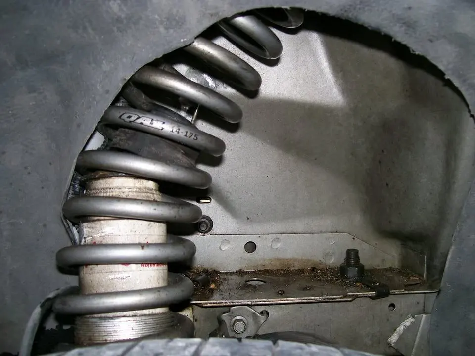

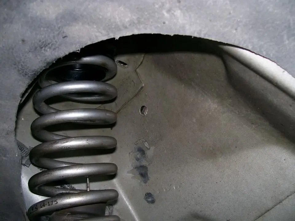

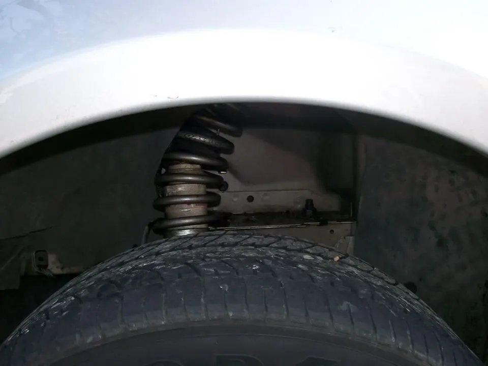

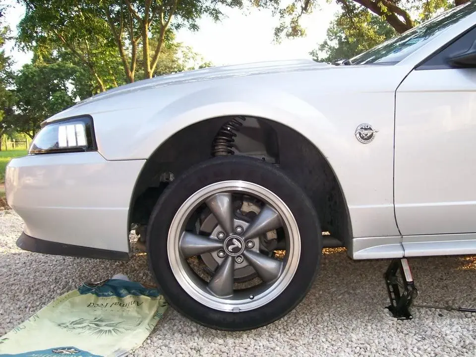

Took a HUGE risk and drove the 50 miles home and jacked the car up to find this.
Drag struts are very soft, which causes more movement, which causes heat. Heat causes failure, so If you want adjustability go with the regular illuminas or the D-specs. ....For the life of me I am STILL trying to decided between the d-specs and the bilsteins..
Yep, drag struts FTL on a street car! Sure they made my car hook better, but they dont last long on the street.
That same side had already formed a leak a few days before and then decided to snap on me...I will never buy drag struts again, and probably never buy anything made by Tokico again.
