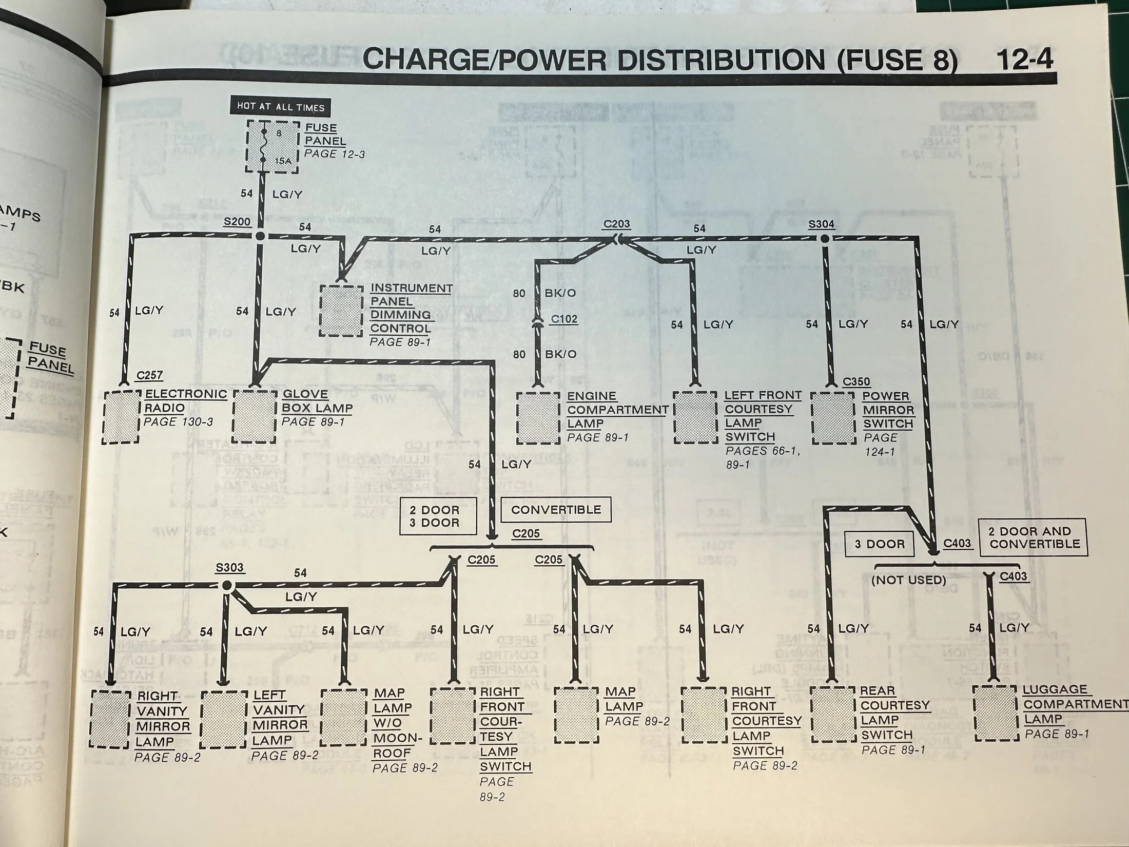

Turns out the radio and interior light are on the same fuse. Not hard to figure out, i have the book.

Now i'm wondering if i was stupid enough to push bare connectors back in for the visor mirrors? I guess i'll have to take a look.

The fuse was blown really weird, not like the first one with a hole blown in the middle of the filament.
It's a 15, but i don't want to waste all my 15's, so i threw a 10 in there. Everything that's supposed to work, works, so we will have to see next time i drive it.
Though now that i think about it, it happened while driving, so that may rule out a handful of items.
Which means it could very well be an open wire grounding out. So that's pretty much a nightmare scenario, i would rather it just break and be broken, but if it's not and it randomly blows i could really be in for it.
I"m also not sure if the visor mirrors are even on the same fuse, i'll have to dig into the book at a glance i didn't see them listed (or i don't know the actual name of them). I probably should have pulled the fuse and tested it while i had the visor off.

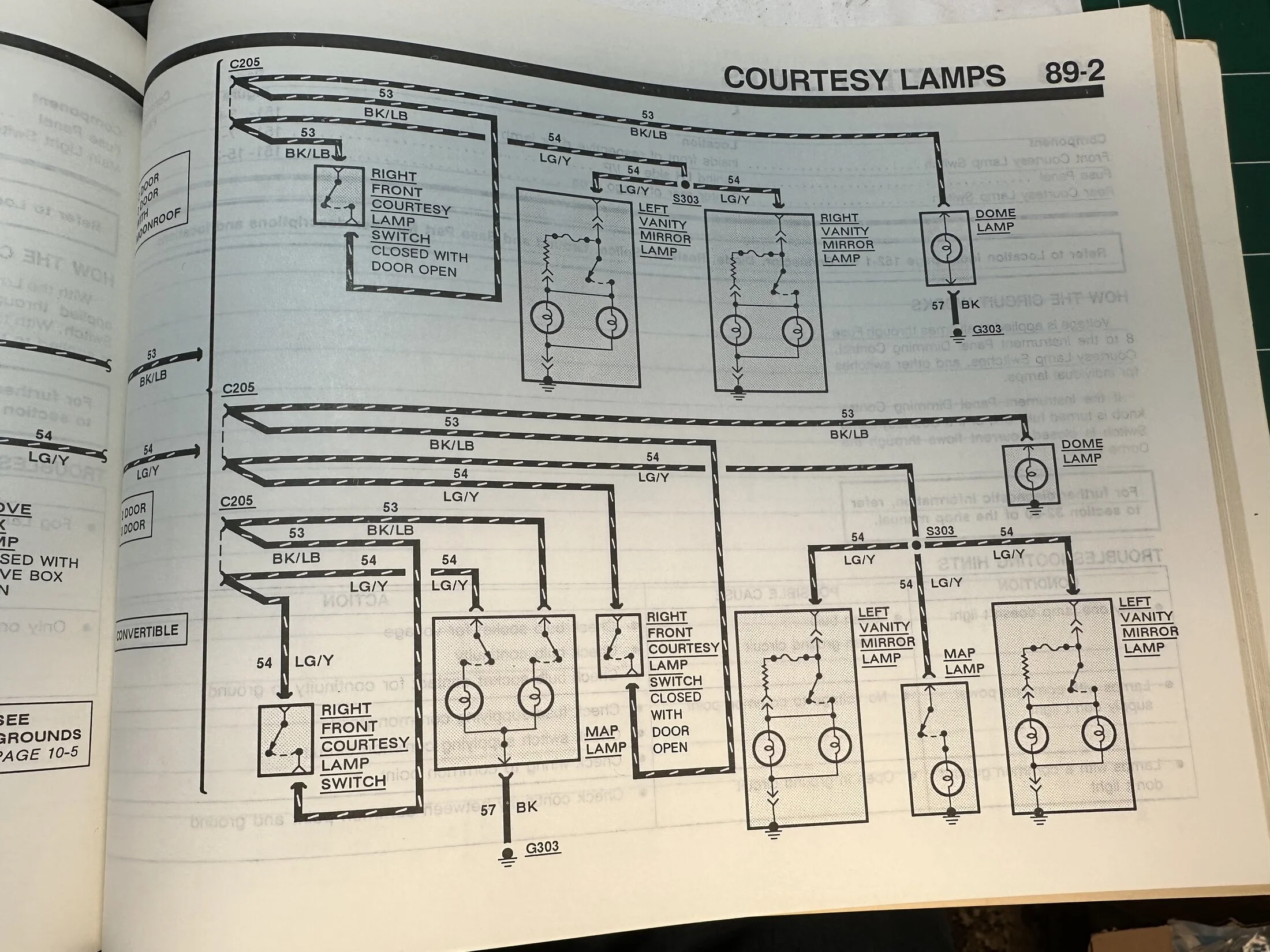

Well, that puts them with the radio and they are they only thing i've messed with in a long time, so let's hope covering up the connector solved it.
Do the visors have an official name in the electrical manual? Or do they just fall under courtesy lights?
Edit: I'm really not thinking lately, i still need to open the passenger side.
They fall on the page for courtesy lights
All this stuff here is under fuse 8

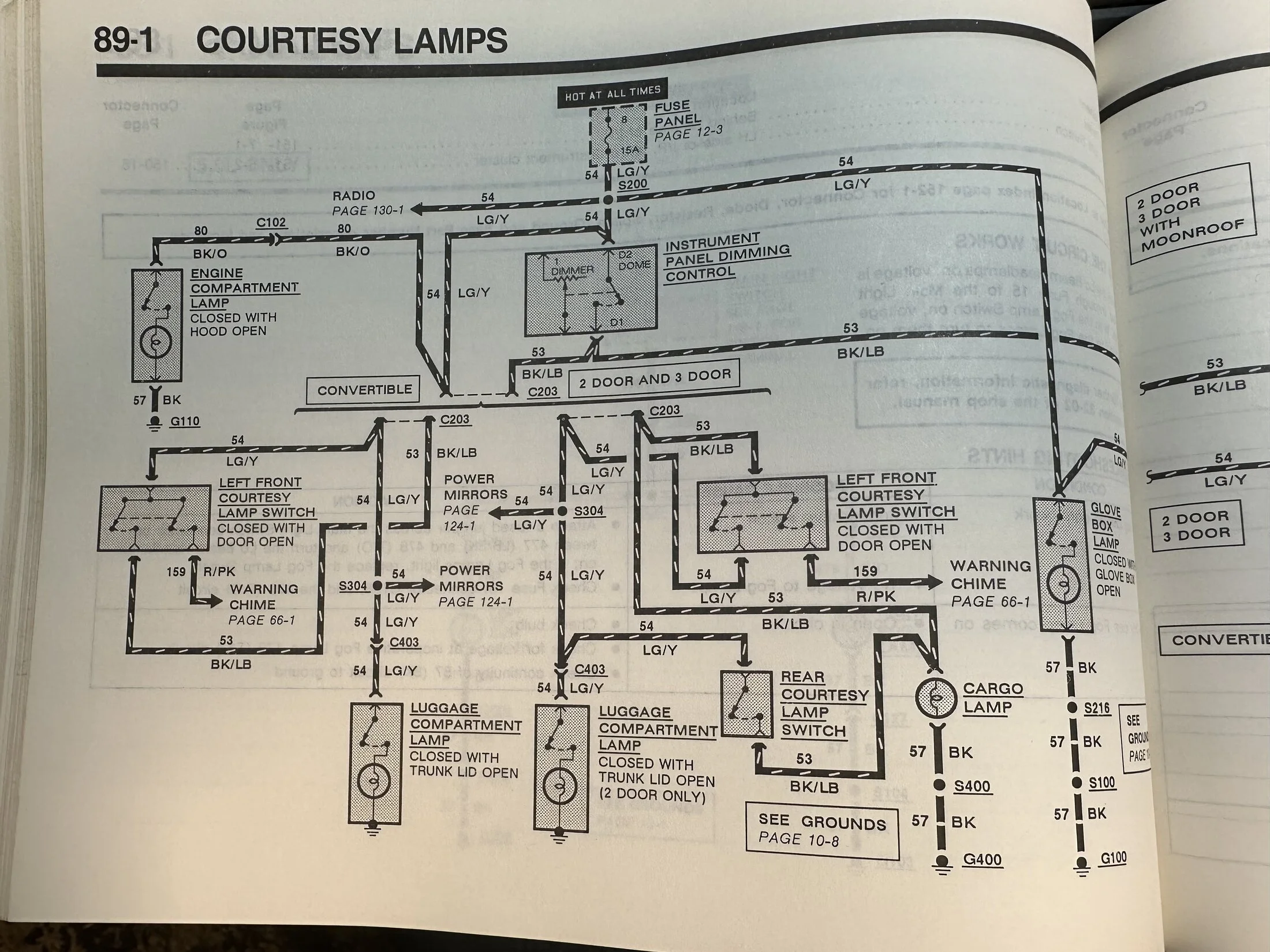

It's still blowing the fuse for the radio. I think i have an idea where it's coming from, ill have to change the fuse and test (I did buy an auto reset fuse, but i'm not totally familiar with how safe they are, opinions on them?).
It occurred to me that it always works fine in the garage, never pops when the car is off or in place, i can use the mirrors, open and close doors so the lights come on and off, map light works, so does glove compartment.
But by the time i pull it out of the garage it's history. My guess is that when i turn on the parking lights (i always drive with them on, been that way for 30 years) i'm turning on the instrument panel dimming control to the cluster.
I'll check to make sure that is the catalyst, then if it is, i'll start by unplugging the dimmer.

And i didn't try and mess with the blown fuse, but oddly enough the gauge lighting works.
It's also listed on both fuse 6 and fuse 8.
So over the weekend i messed with the blown fuse a bit.
One thing i didn't consider is that the dimmer also controls the interior light.
I don't think i touched it in 20 years. No reason to, i don't drive the car at night so there is no reason to either dim it or turn on the interior light.
I don't know if the issue is related yet, but i struggled to find a spot on it where the interior light was off but the dash lights were on after i initially touched it. Almost seemed random, i exercised it a bit, that seemed to have made it worse.
And of course, i could not get the fuse to blow again even after driving around...
Ordered a new one from LMR. Hopefully they are good quality (it's a DC part).
