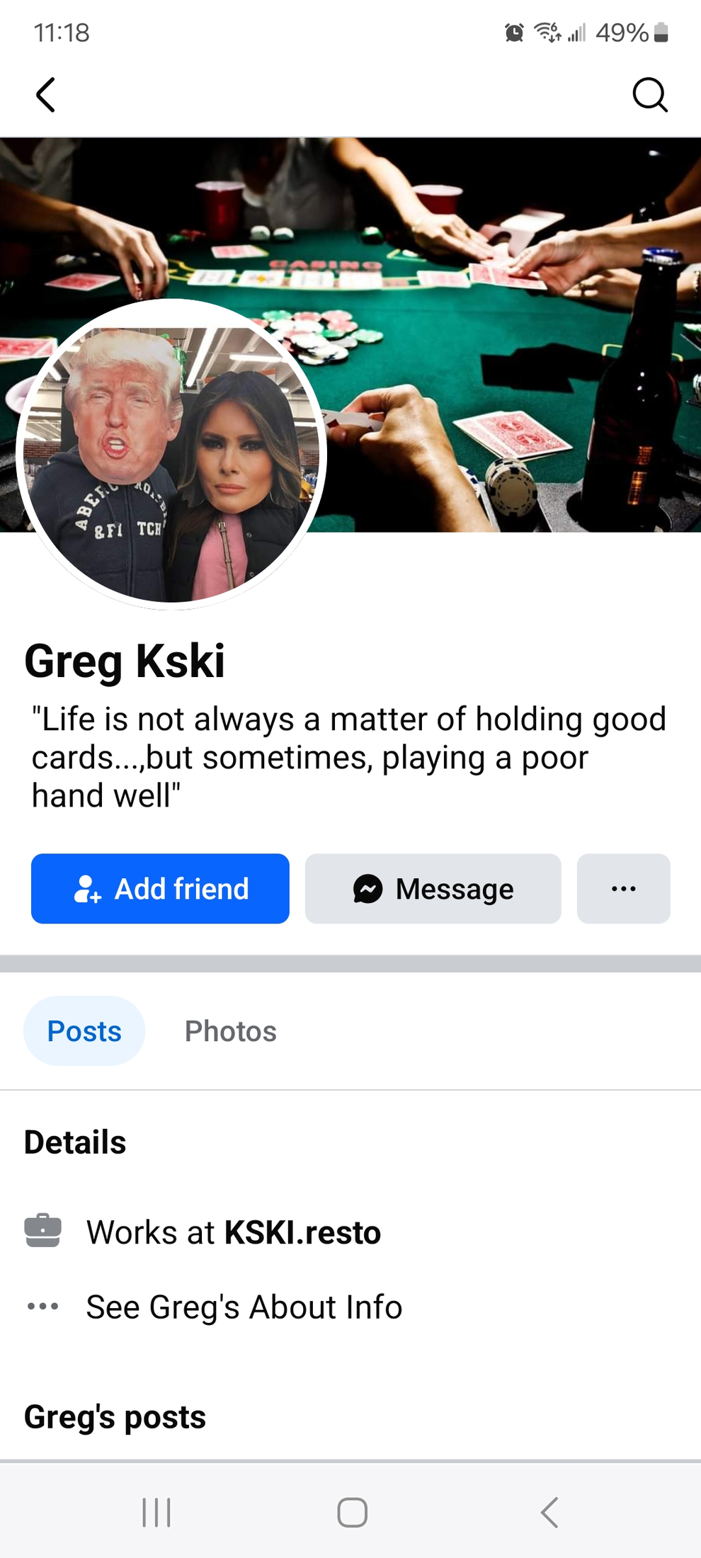

Black Jack is getting restored/touched up trim from Greg Kaminski. I don'tremember what I paid, but it was a lot of work for maybe $350 or so? Think his FB name is Greg Kski.
