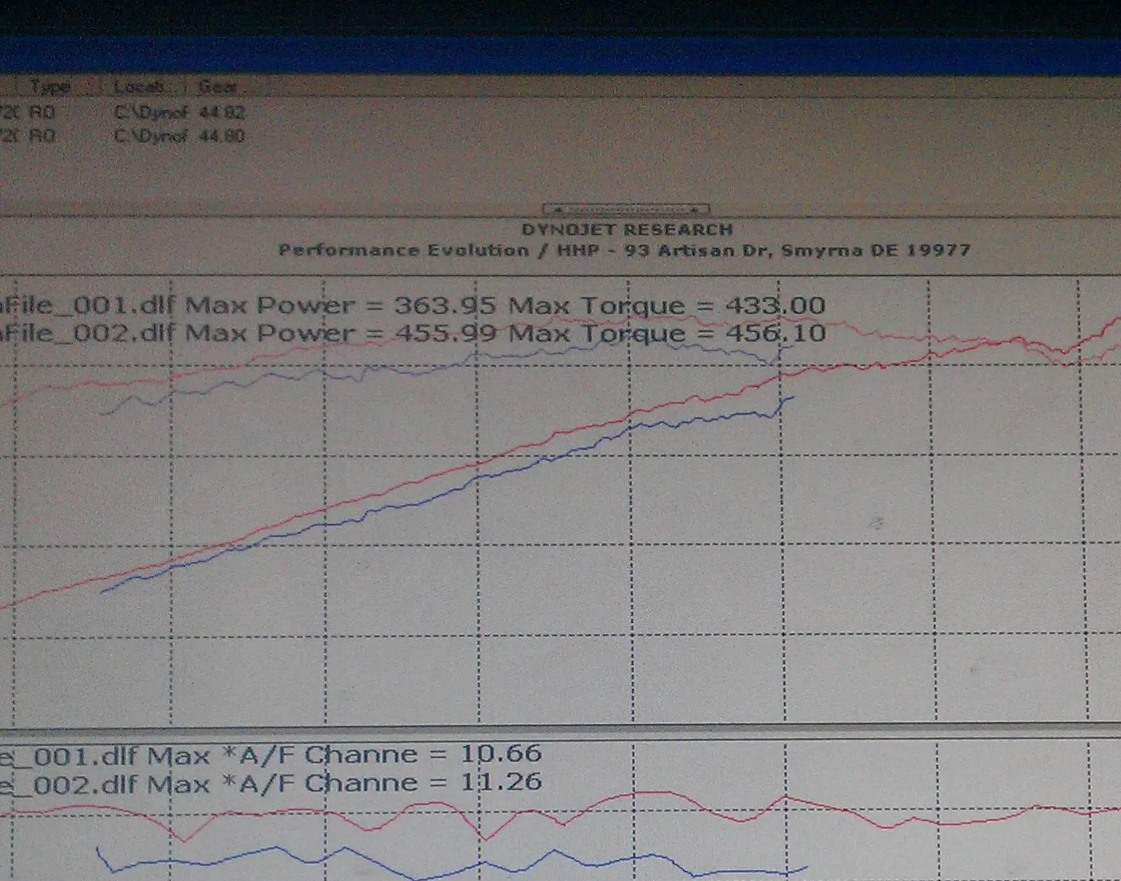

Alright.....good morning....back on dyno! Best run 455hp 455ft/lbs torque....backed down timing to 14 degrees keep it safe....442hp 455ft/lbs torque!
