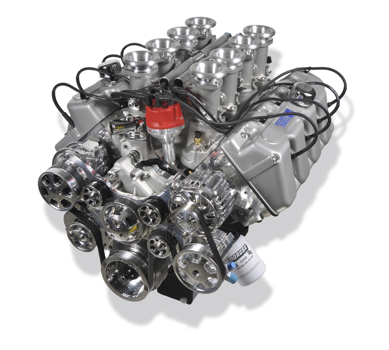

My personal engine of choice when you have 38,000 to spend. All aluminum 496 Cammer. Thank you mr. Kraft.
or:

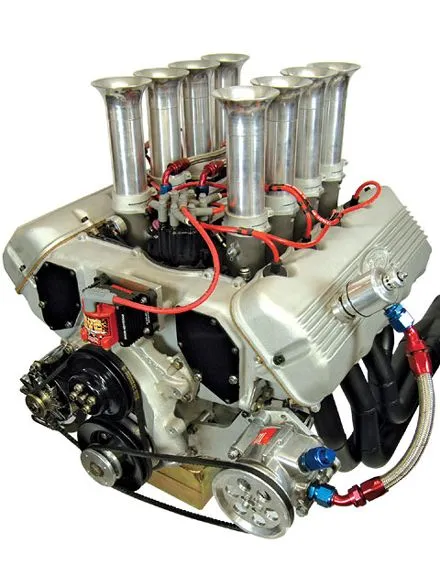

Kaase's Boss 520:drool:
