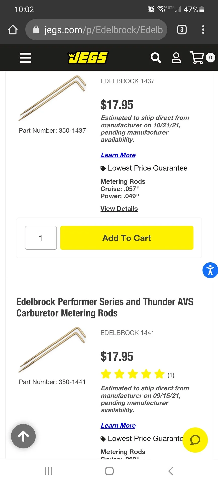

The cheap stoich gauge hooked up to a new o2 sensor will help. A real wide band set up would work even better. My edelbrock had metering rods you had to swap out to control flow.
They look like this...
I'm not sure of the size I had to use. My carb also had a power valve linkage at the top that I had to adjust so it would drop fuel at initial punch of the happy pedal.

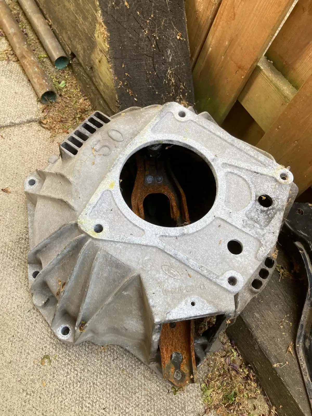

but I also have a line on a 94 t5 with correct bellhousing apparently for the fox
The way to tell the difference between Fox and SN bellhousing is the SN's have the engine displacement cast into them.
Thank you very much for that info on the metering rods I completely forgot about those.. im going to look into getting a gauge soon then.. also i have the electric choke and it seems to work when i set it up, but it seems like the next week it no longer works as it should, it is crap IMO but when its cold outside it seems to need it..

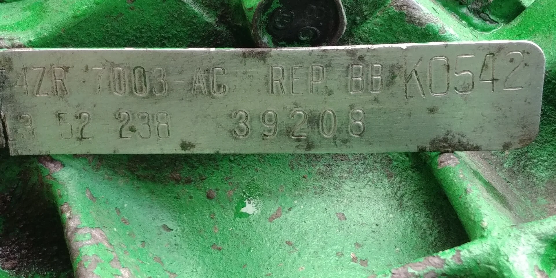

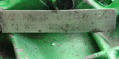

The transmission tag is how you can tell (so long as its there and someone hasn't changed it - to deceive folks).
Second row on the tag starts with the number you are interested in. In the above case it is 13 52 238. The 238 is the number you need. There are a number of sites that translate what the transmission originally came as. In this case, 238 is for 94-98 V6 (this year I have pulled a T5 from a 95, 96 and a 98 - all were 1352-238)
