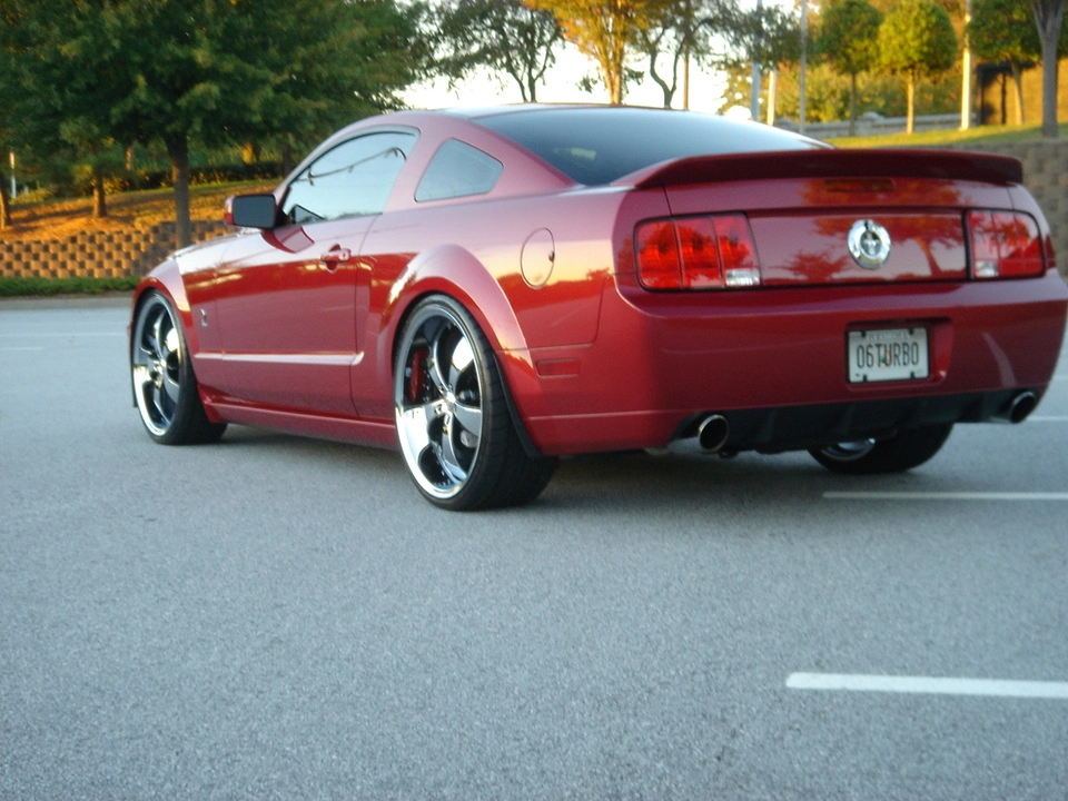

Only if you ignore sidewall flex:
^^negligible sidewall flex on 22s.
^^visibly obvious sidewall flex on 15s & 16s.

The pictures you showed prove the point. The pressure in the tires on the Mustang on dubs is higher than the pressure in the slicks on the two drag cars you showed. You would know that if you had been drag racing for 20 years. :bs:
